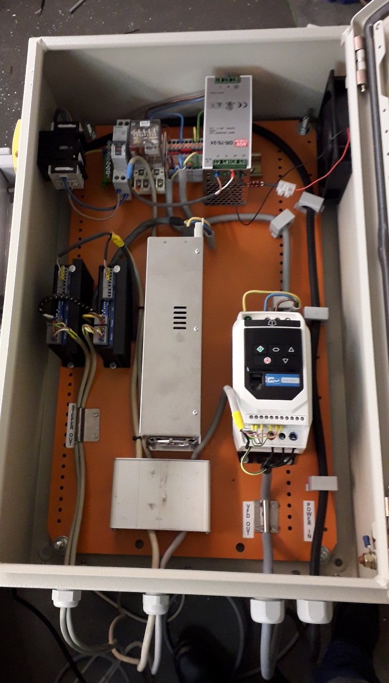

- The control cabinet for EdingCNC is finished including 2x stepper drive 50V 5.6A for the two 2.5 Nm steppers, a modern VFD and safety circuit

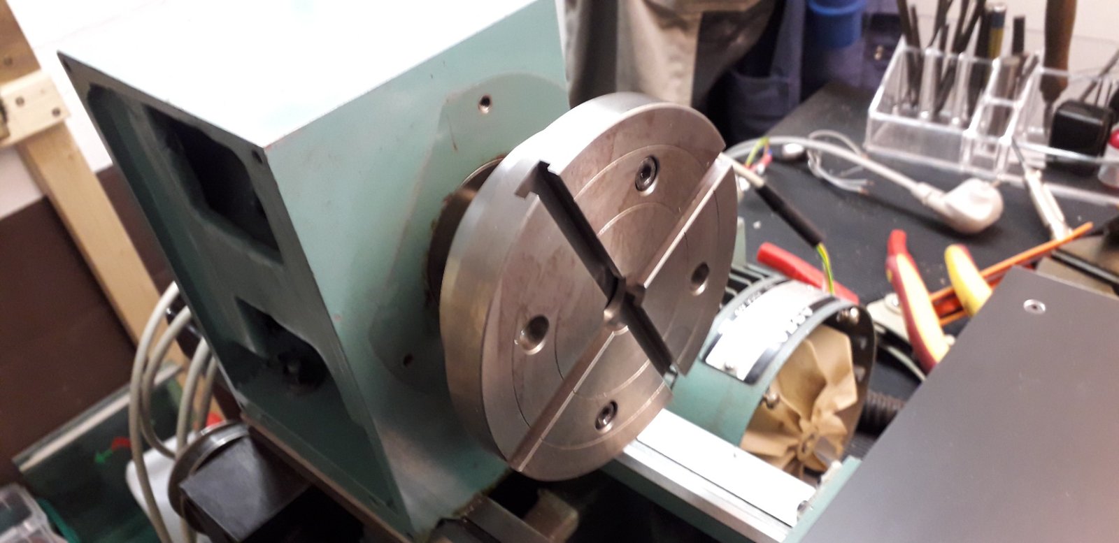

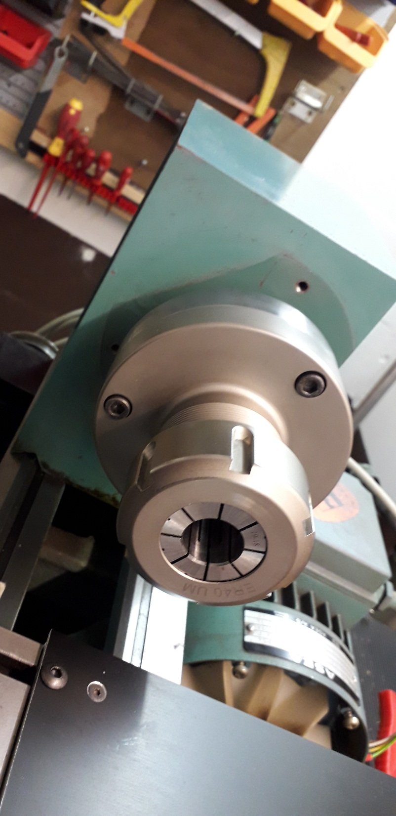

- An interface plate for the spindle nose of was fabricated such that it can hold my modern 4-jaw, 3-jaw, ER40 collet holder and faceplate.

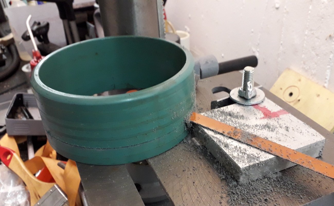

Gently cutting the collar to reduce its lenght by 15 mm such that it will accommodate the modern chucks
