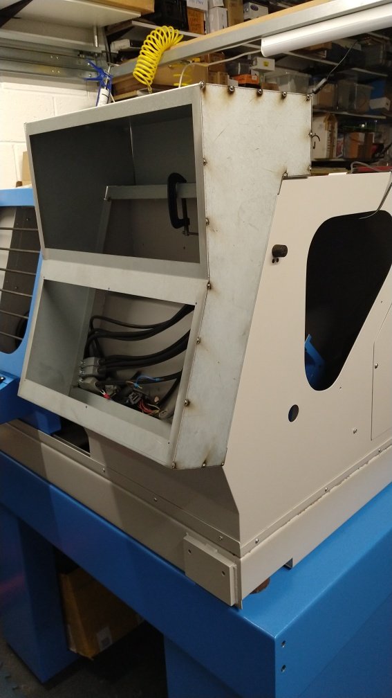

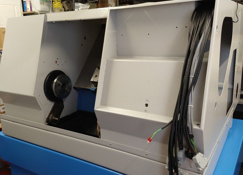

Its getting closer to looking like a machine again.

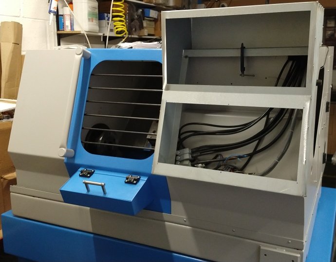

It's looking good.

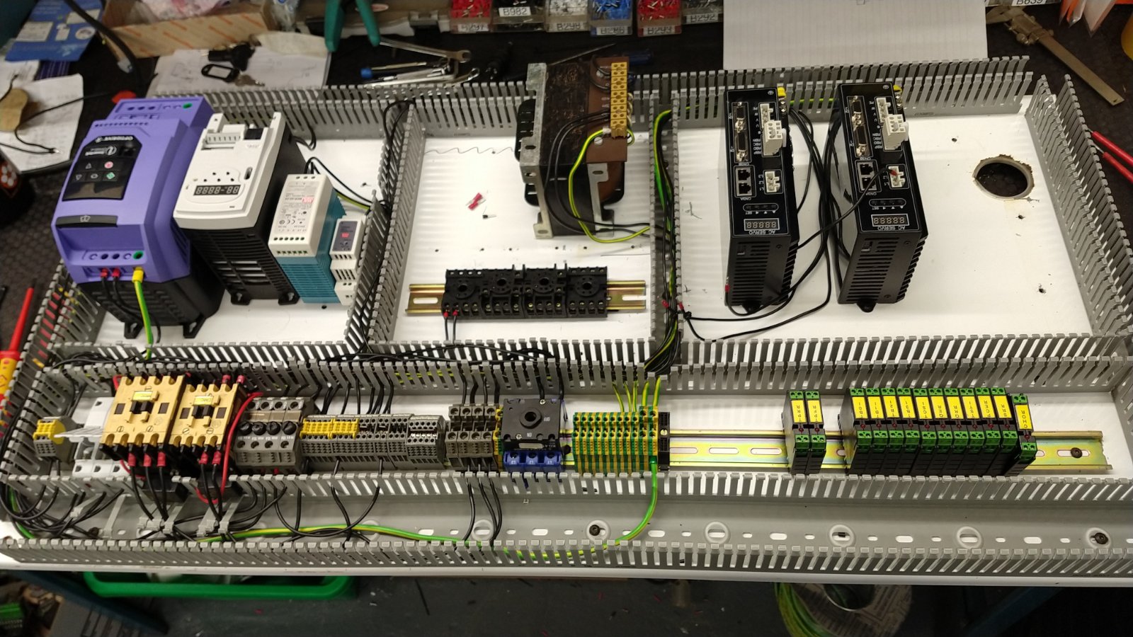

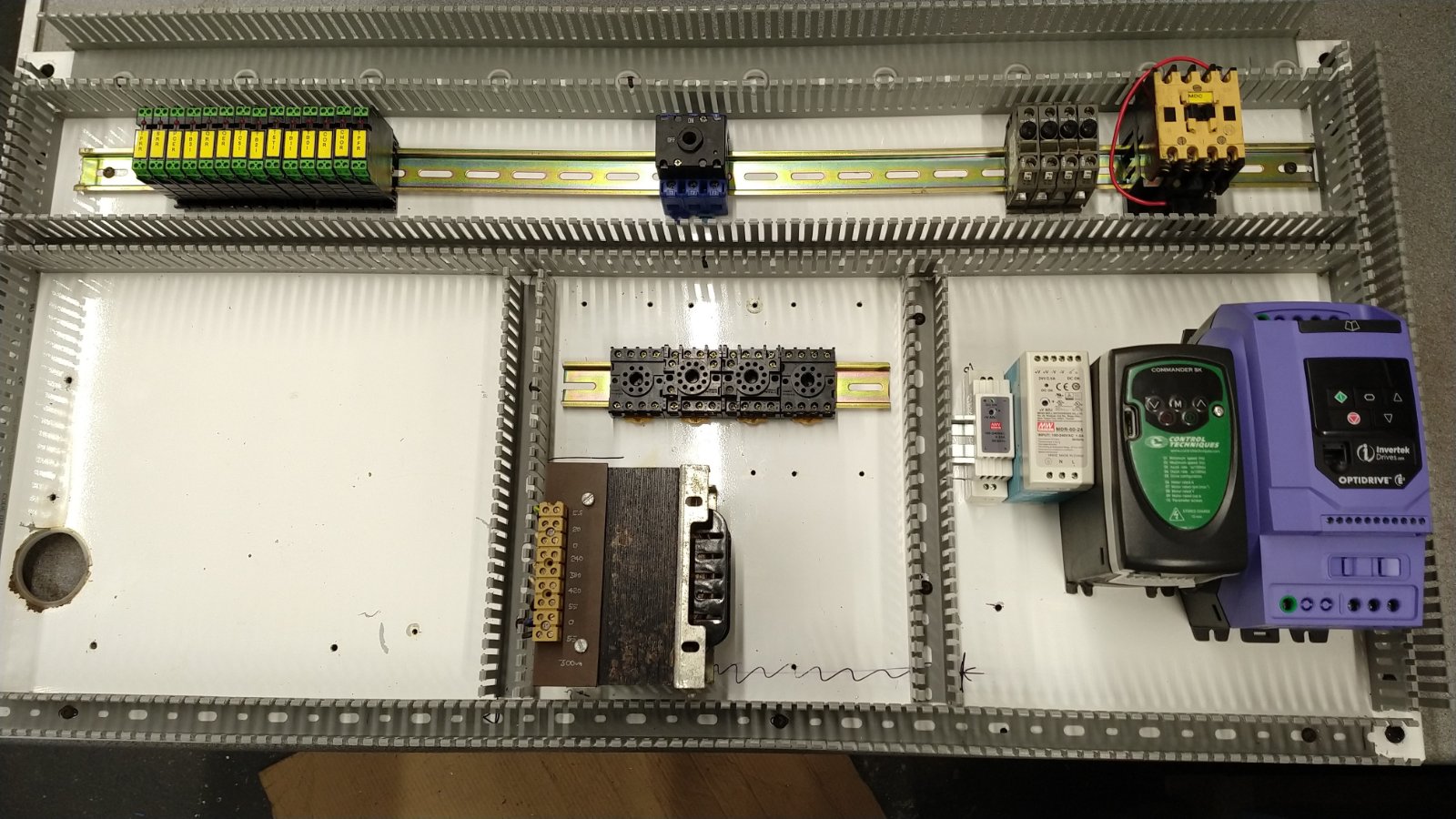

Things have moved on a bit in the last few weeks.

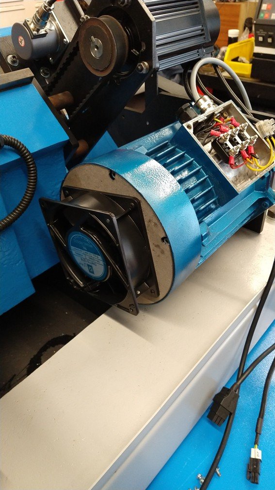

The spindle cooling fan was duff so a new fan and mounting had to be made.
The spindle is now running sweet up to about 4800rpm but I have restricted it to 3500 which is the max for my chuck.
Axis motors are in and tuned to 15000mm/min rapid.
Turret is connected and working the only thing I had to do was fit some new dampers in to it as the originals were crumbling to dust.

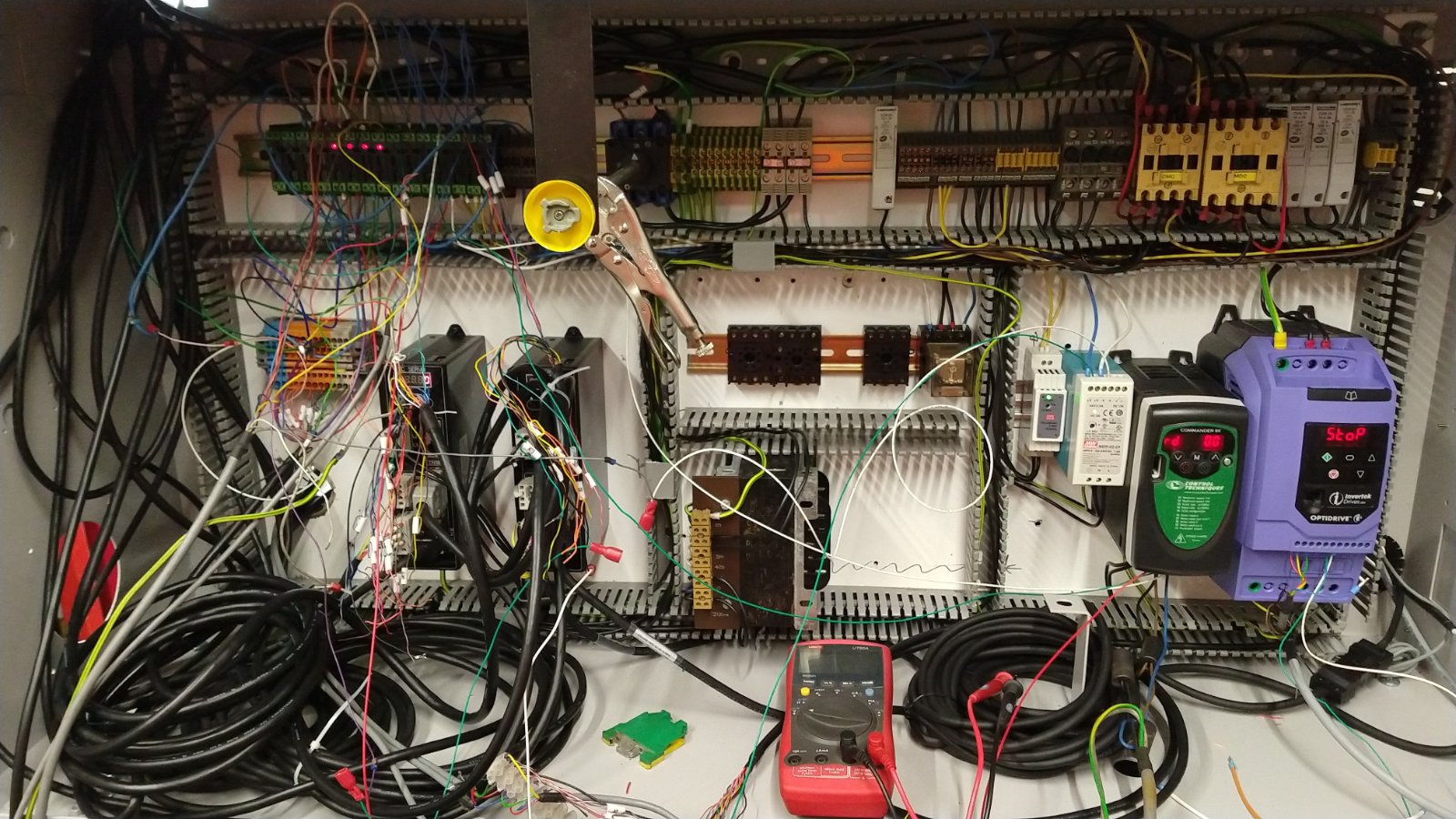

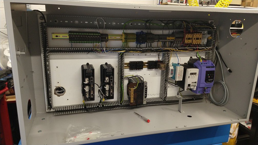

Main cabinet next and the air system for the tailstock and part catcher.
Then once all that is in I will tidy up the wires.

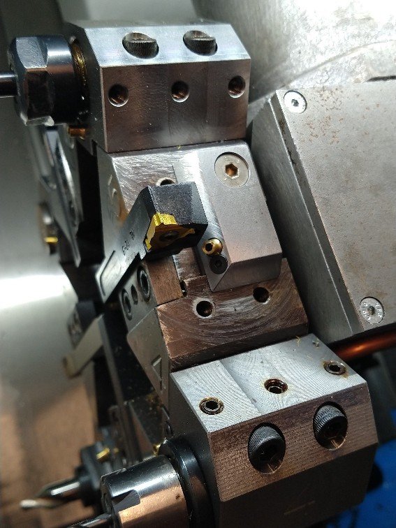

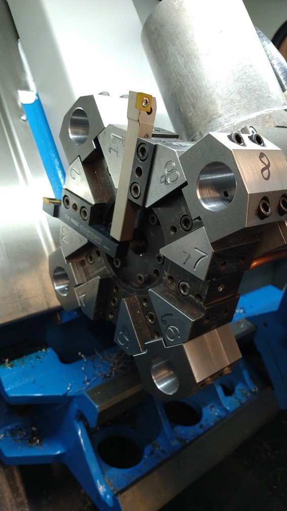

Not posted for a while so here are some pictures of the new tool holders and the through coolant modification I decided to add, all the parts have been made on my Triac and the TU150. I also modified the 3 original tool blocks that came with the machine.
Here is a link to the machine making the small brass nozzle.
https://youtu.be/DjY36qPZGtA

Great work on the through coolant system, could you please post some photos/details of where the coolant feeds into the rear of the turret?
Re: TU150U in need of TLC
All the detail is in the TOE80 manual

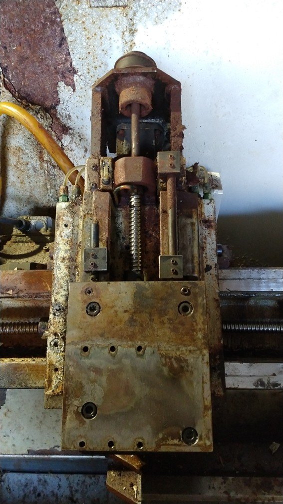

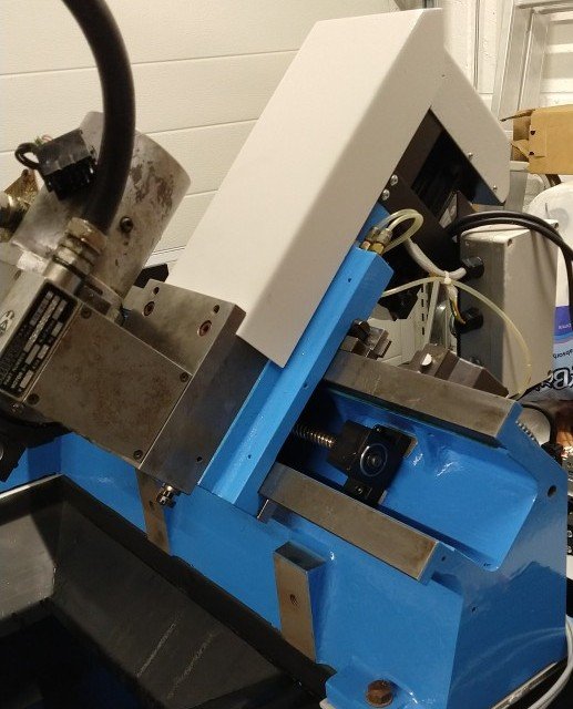

One question, see the plate that is sandwiched between the cross-slide and turret (the one with the two grubscrews to secure the cover that moves with the X-axis), did you happen to have it off?
If I can't get the bits to fix my TOE80, the smallest turret I've found is 50mm centre height (TOE80 is 40). I'm wondering if it would be feasible to replace that plate with a thinner one, or whether there is more to that plate than to simply space up the turret.
Its just a flat spacer plate with 4 hole to mount it to the cross slide and the holes for the turret and a slot and 2 grub screws for the rear cover. See picture from before its clean up.
Thanks for that.
That gives me an option if I can't get my turret working again.

Here is a picture of the external tool coolant nozzle.
The only issue I had was it firing coolant down the spindle bore so I have a plastic bung in the back end now.
