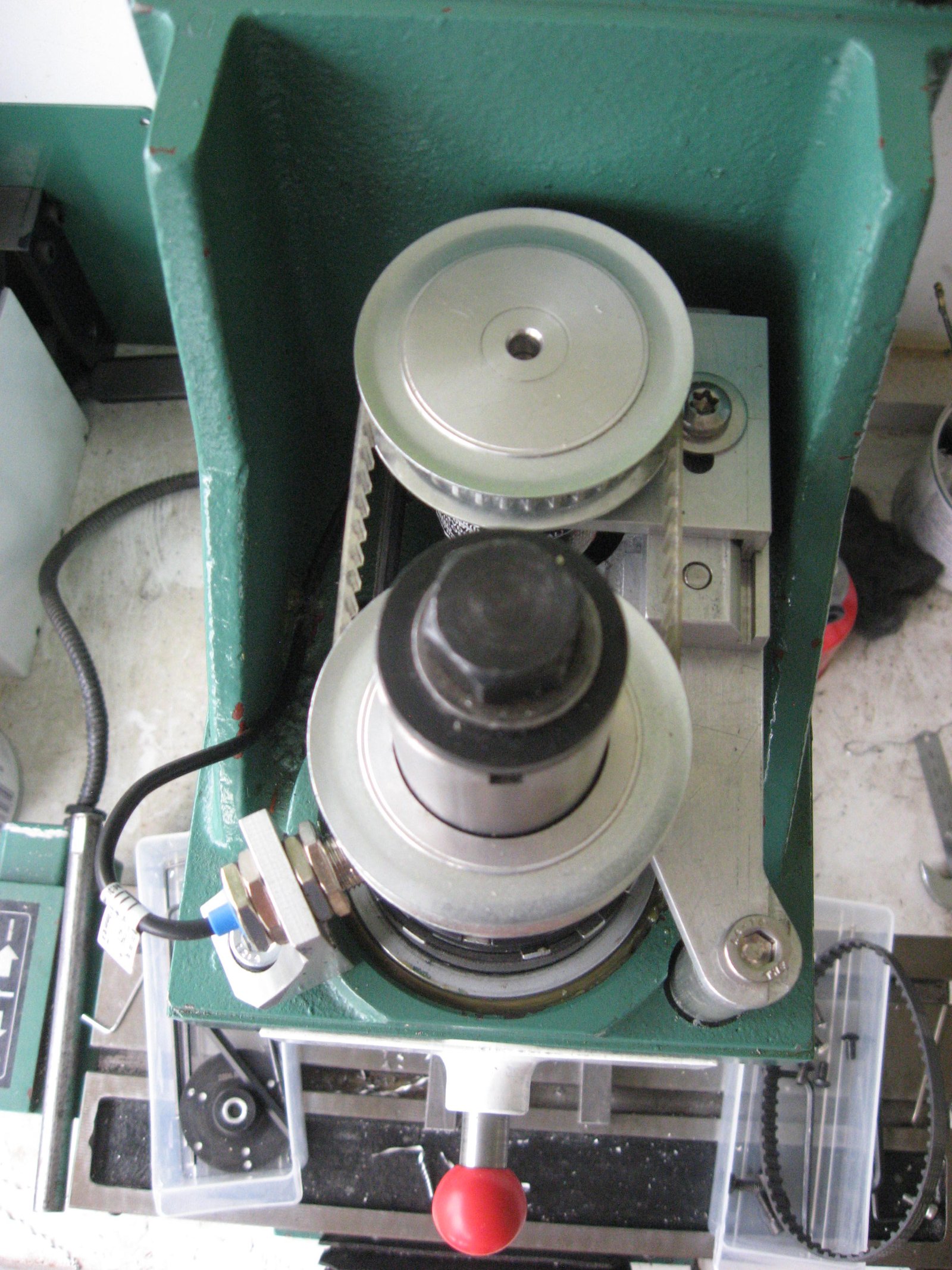

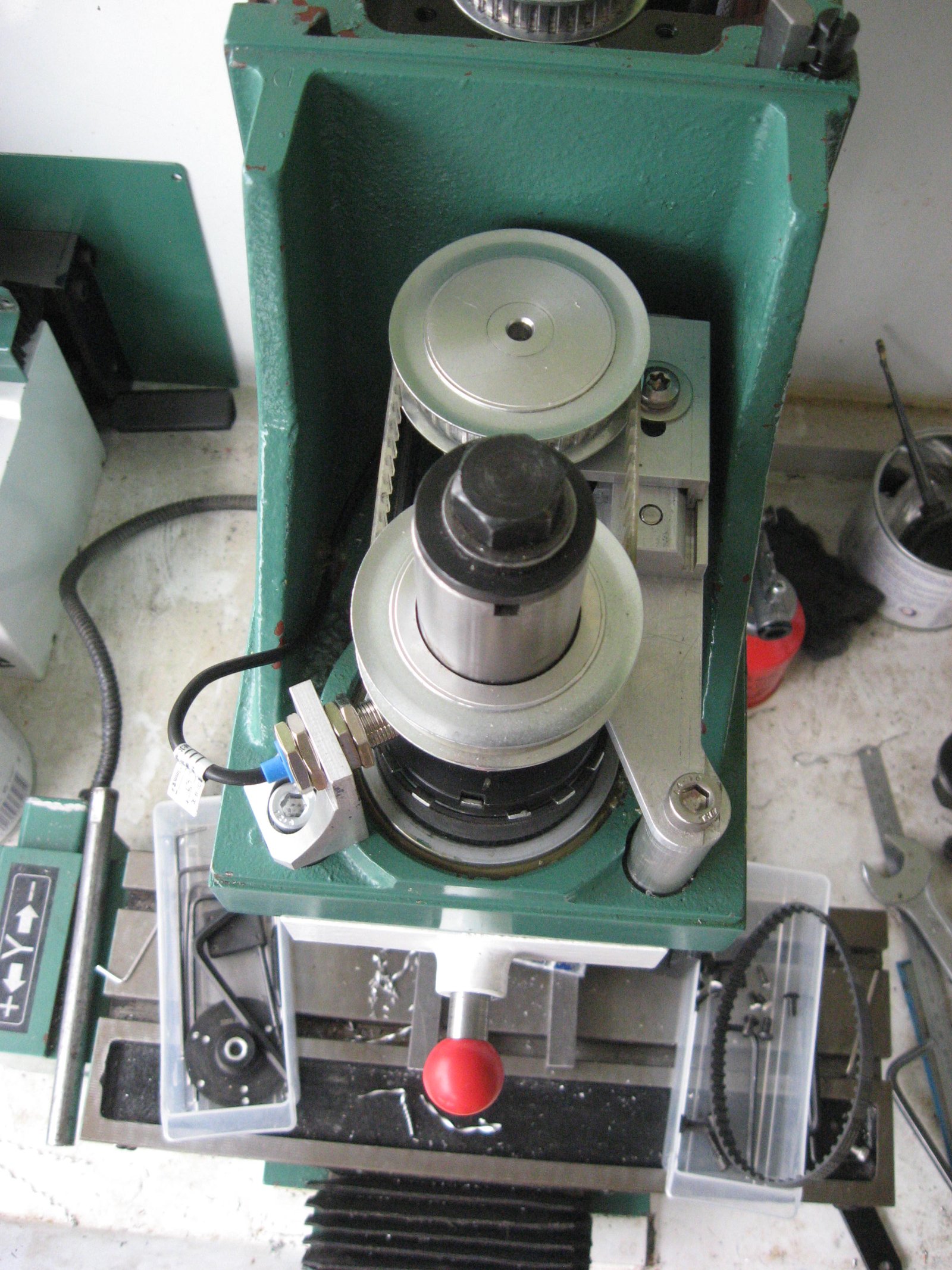

4)I have installed an encoder, and index on mine, see pictures

That is quite a setup you have there, very impressive.
Thank you for all the answers.
