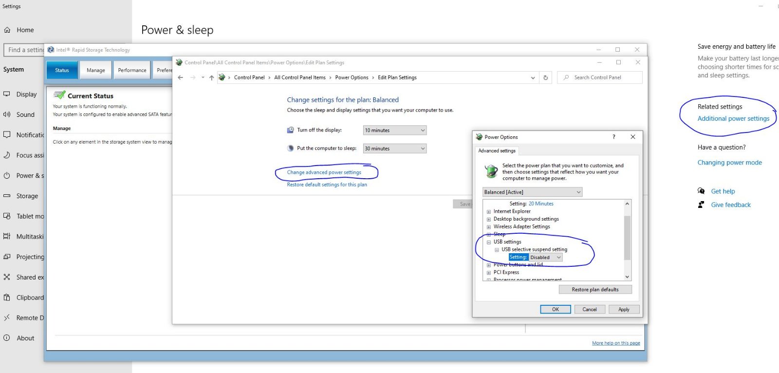

Have you checked the power saving settings on your PC? Make sure the USB port does not shut down in power saving mode

Hi Steve,
Thanks for the reply. On your advice, I changed the settings and ran another program and the same thing happened. :(
One obervation is that, after the machine stops, the PC no longer recognises it at all. I can't reconnect without rebooting. This surely measn it's not a "move buffer full" comms issue but, more likely a Timeout issue. Some parameter is cutting the connection between CNC & PC altogether. This is why your suggestion was so promising but, alas, no dice.
What could it possibly be?

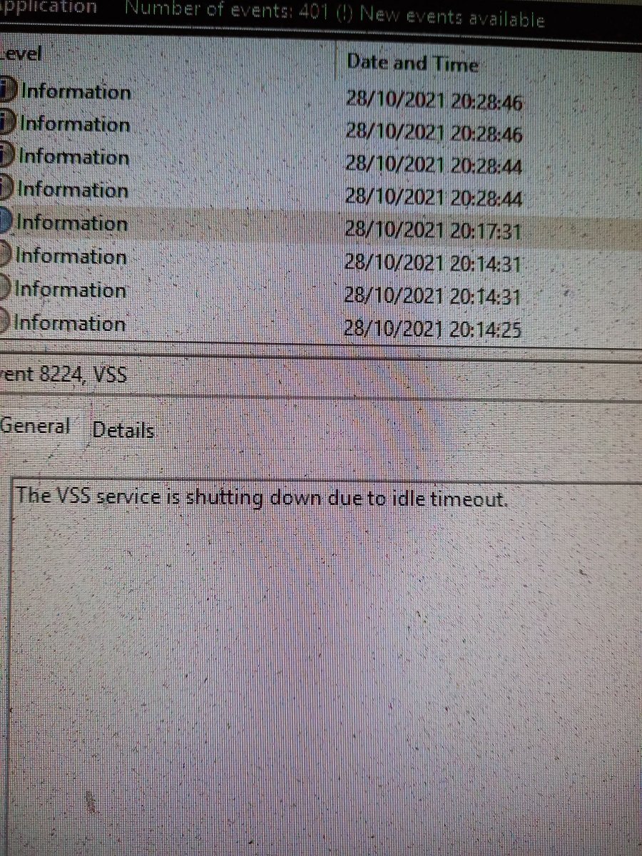

Have you looked in the Windows event logs to see if anything has been logged by the system?
Re: Earth Clamp Mod
David, I did as you suggested and found "VSS Service is shuttting down due to idle timeout".

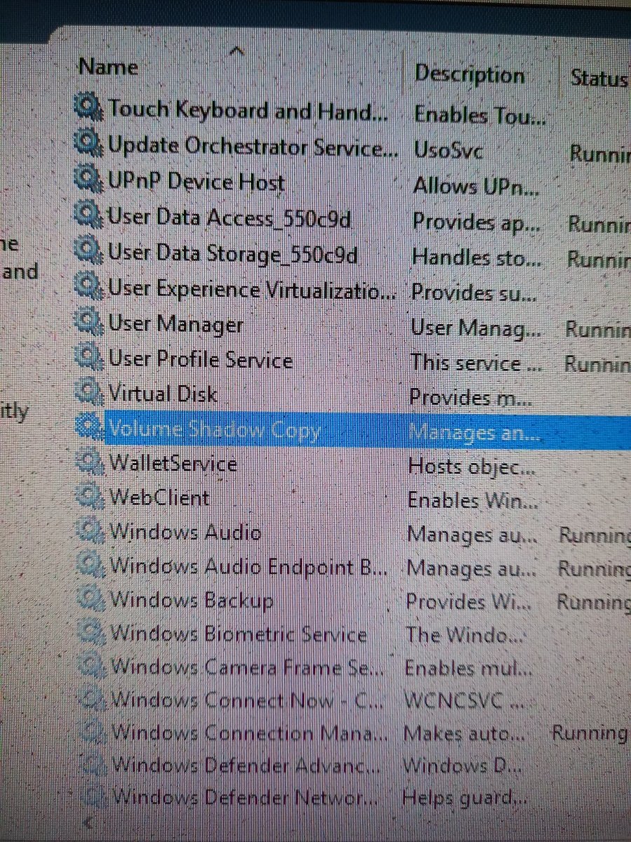

After Googling VSS Service, I found that the "Volumn Shadow Copy" settings were coming up on a lot of CNC boards.

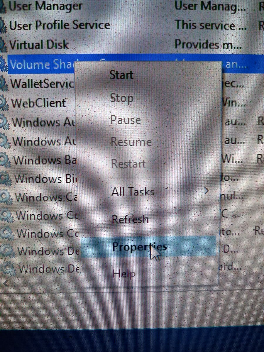

I went to the Services window and found "Volumn Show Copy", hit Properties and set Start-up Type to Automatic from Manual and...
IT WORKED!!! It ran whole whole 140k g-code without missing a beat. I will try it again to make sure it wasn't a fluke but, as of now, problem solved.
