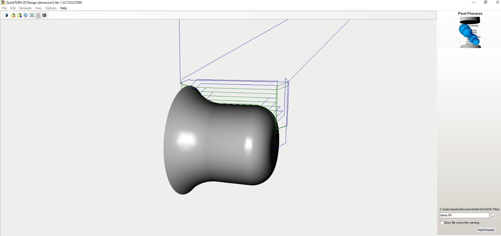

Hi I tried this with version 1.33.7233.57000 and it all seemed to work OK.
Other than the bar being 34mm I could not see any issues.

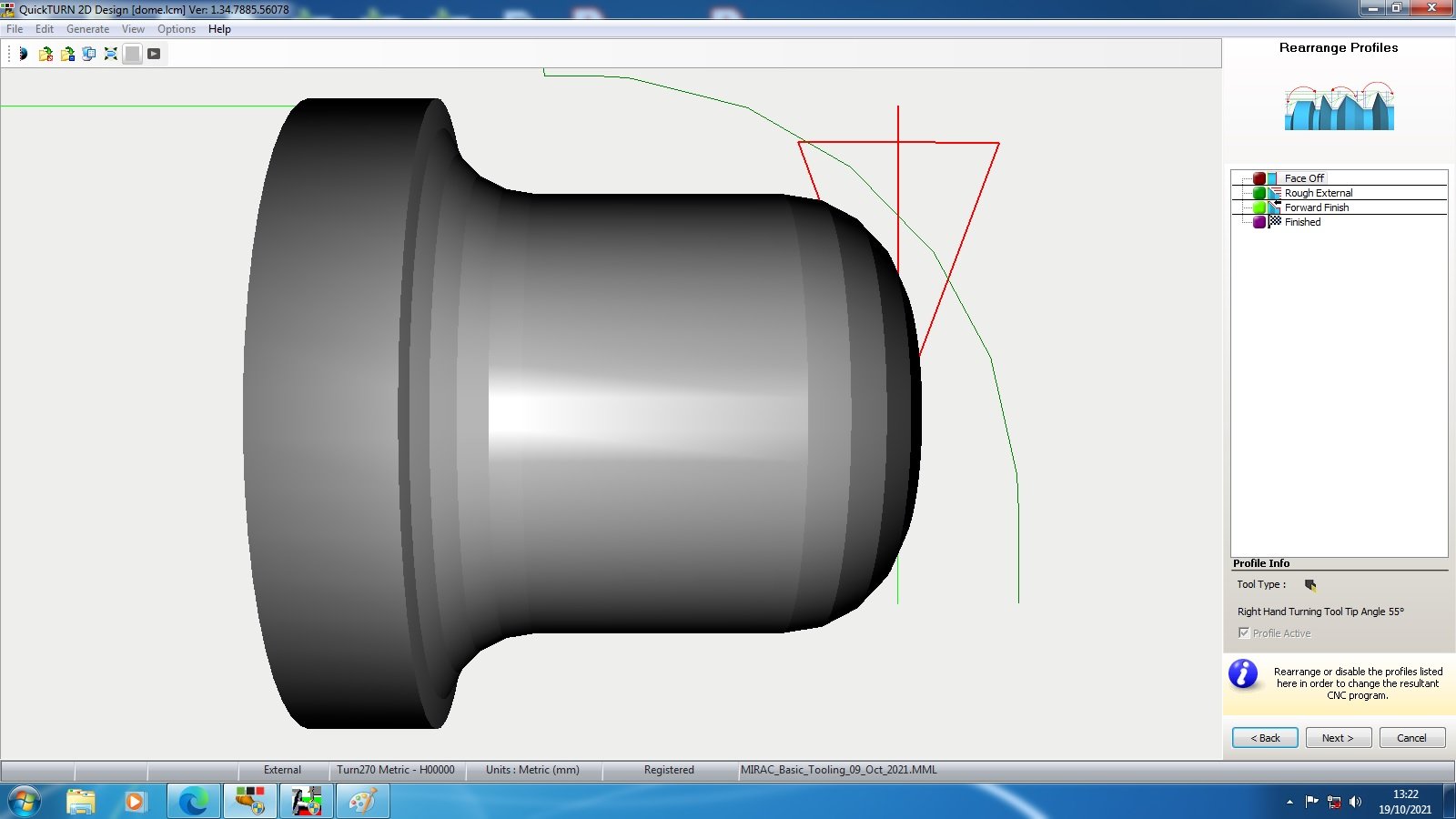

I'm using version 1.34.7885.56078. I've changed the Machine Tooling file to reflect the fact that my RH turning tool has a tip angle of 55 degrees rather than the default 65 degrees.

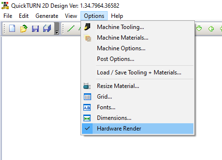

Hi Max. In version 1.34, from the main screen, can you select Options and then make sure that Hardware Render is definitely selected. If it was off before then does this make a difference to you?
If I then have just a single tool of RH turning, the plan does perform roughing cuts correctly, whether the angle is 55 or 66.
Did you add the red arrow to the image or has that been created as part of the plan?

There have been a couple of changes in the new version. Check that you have hardware render selected and the part then renders correctly.

I've done some experimenting with the following results:-
Ver: 1.34.7885.56078
I note this is a different version 1.34 to the one you're using.
Tooling File: QuickTURN_Default.MML
With tool angle 65 degrees things work correctly and GCode is generated with roughing steps. This is regardless of whether Hardware Render is selected.
If I edit the tool angle to 55 degrees things don't work and no GCode is generated for roughing steps. This is regardless of whether Hardware Render is selected.
Edit the tool angle back to 65 degrees and things work correctly again.
I realise this is different to your own findings, but I've tried it several times with the same result.

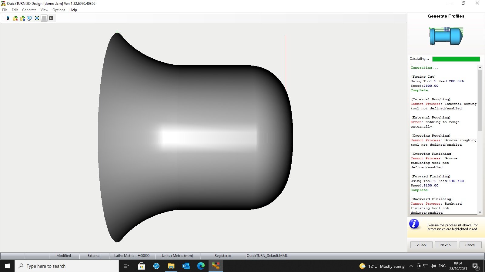

I uninstalled QuickTURN 2D Design, Downloaded the latest version from the Denford site and reinstalled it. This was just in case the software on my PC had been corrupted. The version is V1.34.7885.56078 as before.
Results were much the same as before. Change the tool angle to 55 degrees and no roughing cuts are generated. I see this error message:-
(External Roughing)
Error: Nothing to rough
externally
See attached screenshot.
The tool angle is the only thing I've changed. All other tool parameters remain as in the default file. The image of the tool looks correct.
I found that things worked correctly if the tool angle was changed to 64 degrees or 63 degrees, but not if the angle is set to 62 degrees.
I also tried it on version 1.32.6970.40366 with similar results. This version produces a log file which I've attached.

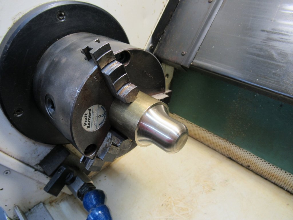

The easiest work round is to specify the tool angle as the default setting of 65 deg even though a 55 deg tool is being used. It makes no difference on this type of profile.
IMG_2001 (1024x768).jpg (103.03 KiB) Viewed 46440 times
