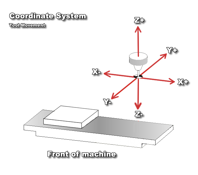

The following diagram will hold true for all CNC machines.
The confusion occurs when the table moves, rather than the tool.
Some manuals show the direction of the moving axis or table, not the resulting movement of the tool.
In the example below, if the table moved in the Y axis and not the tool itself, the table movement directions would be opposite to the tool directions :?
ie, to send the table away from the front of the machine, you would command a Y- move
Tool movement co-ordinate system for milling machines
