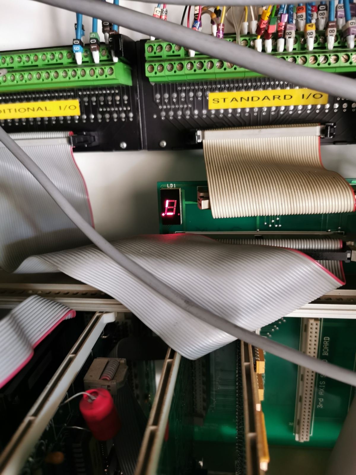

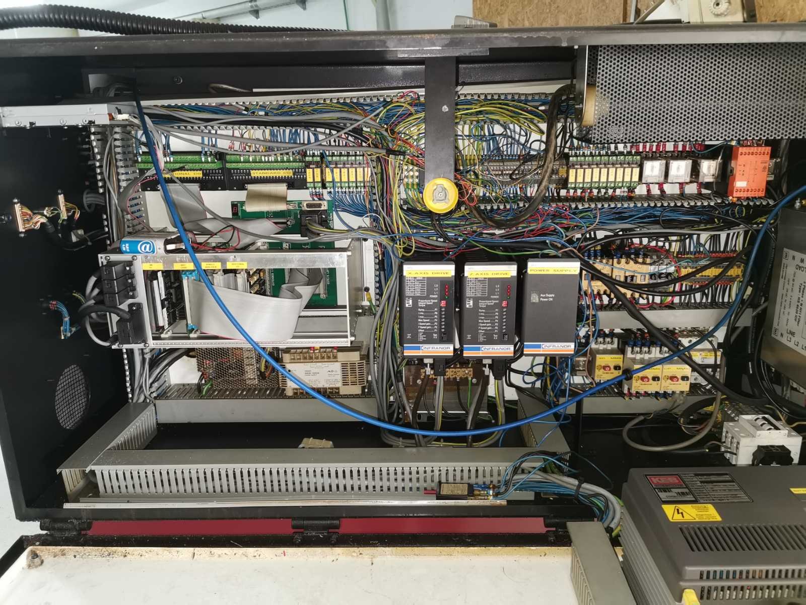

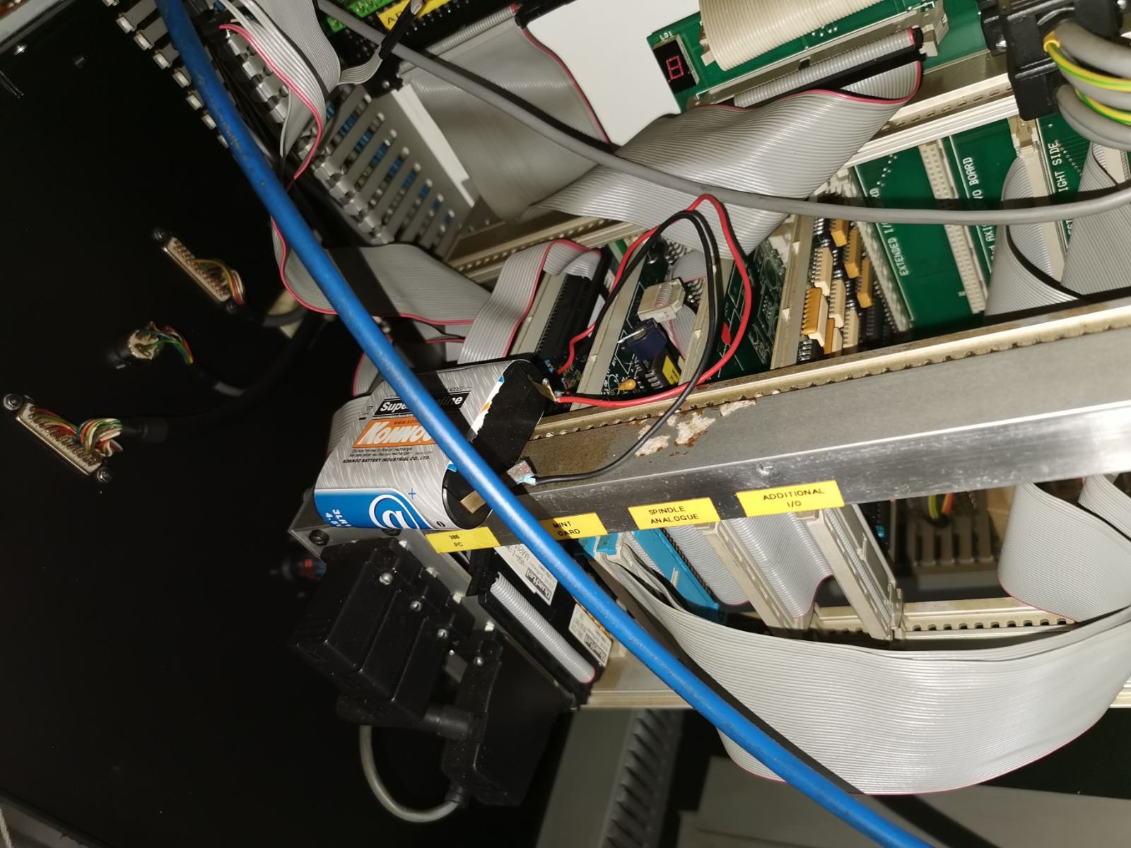

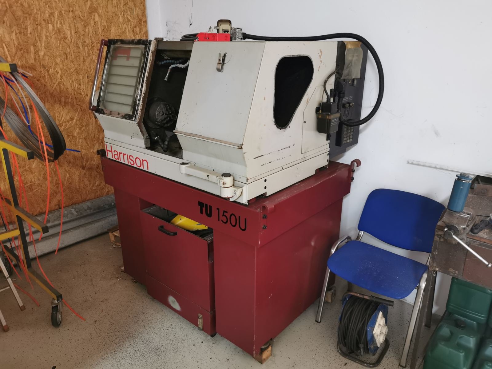

Hi everyone. I bought it recently and I haven't been able to start up. Only alarm beep and I dont know meaning of that sound.She didn't work for a long time. Thanks for your comments

I haven´t used mine in a long time, and the last time one om my servos didn´t start so I´m pretty irritated on mine :oops:
It´s a computer that has to start, it´s good to have an external keyboard (a really old one with the giant round contact), that you can attach on the side where the floppy disc is.
It´s hard to say if your screen is broken or of it´s the computer. I don´t remember if there is any VGA-port you can test another screen.
But you will need a start disc in the floppy driver, did you get any 3.5" floppy disc?
