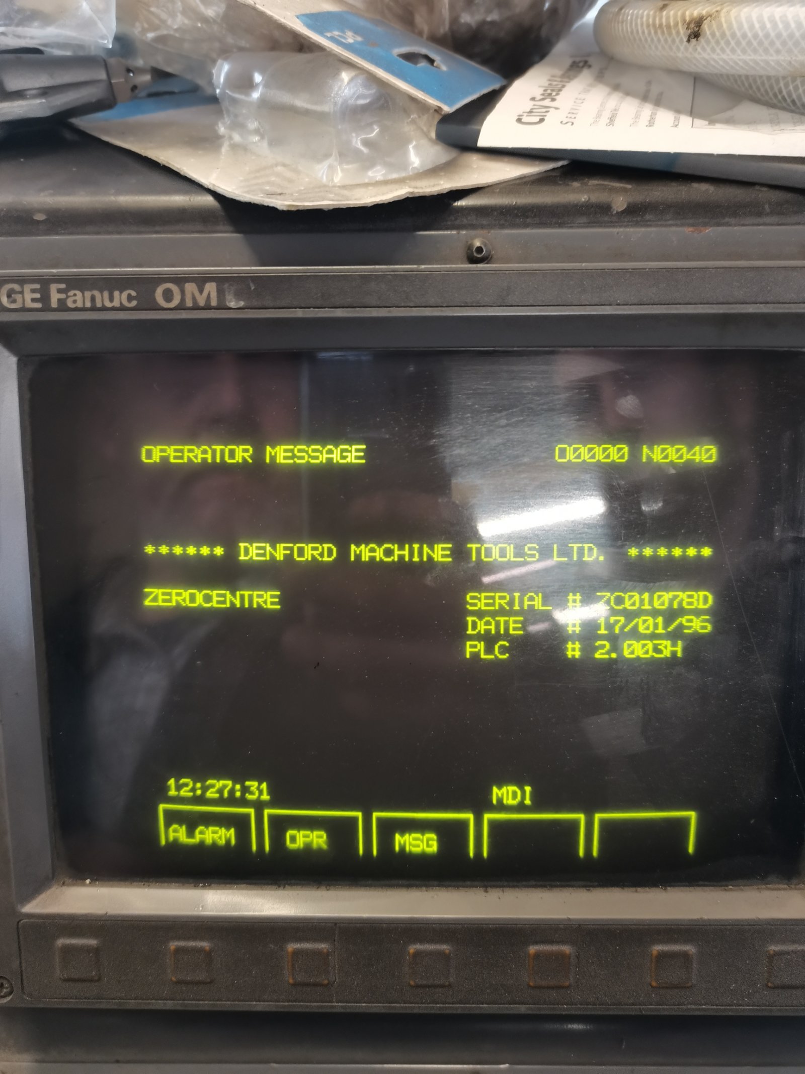

Hello, I work for small engineering company in Sheffield and weve recently acquired an old Zerocentre 3 axis Cnc. After referencing the Z, Y & X axis, and loading in my programs, I try to pick up a tool but get the message wrong carousel pocket number, and no matter which pocket I turn the carousel too manually it refuses to pick up a tool. I've been told previously that the machine should automatically know which pocket on the carousel is tool 1. Is there a step I am missing on the startup process to reference tool position 1 in the carousel? I've attached a photo of the startup screen to shed some light on the specific machine. Cheers

You need to put tool number up the spindle & align the carousel to the same position & then input a M27 command which will reset to position 1.
