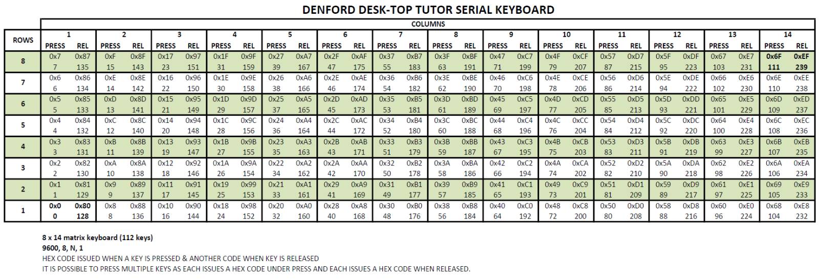

this may be useful to someone, in finding the hex codes output from a Desktop Tutor.
Note I used 9600 baud, 8 bits, no parity, 1 stop bit (I am hoping that is correct for the keyboard....)
{{CORRECTED.....}}
a hex code is issued via serial interface for a button press and another for button release (hence 2 numbers are shown for each button in hex (0x__) and DEC
