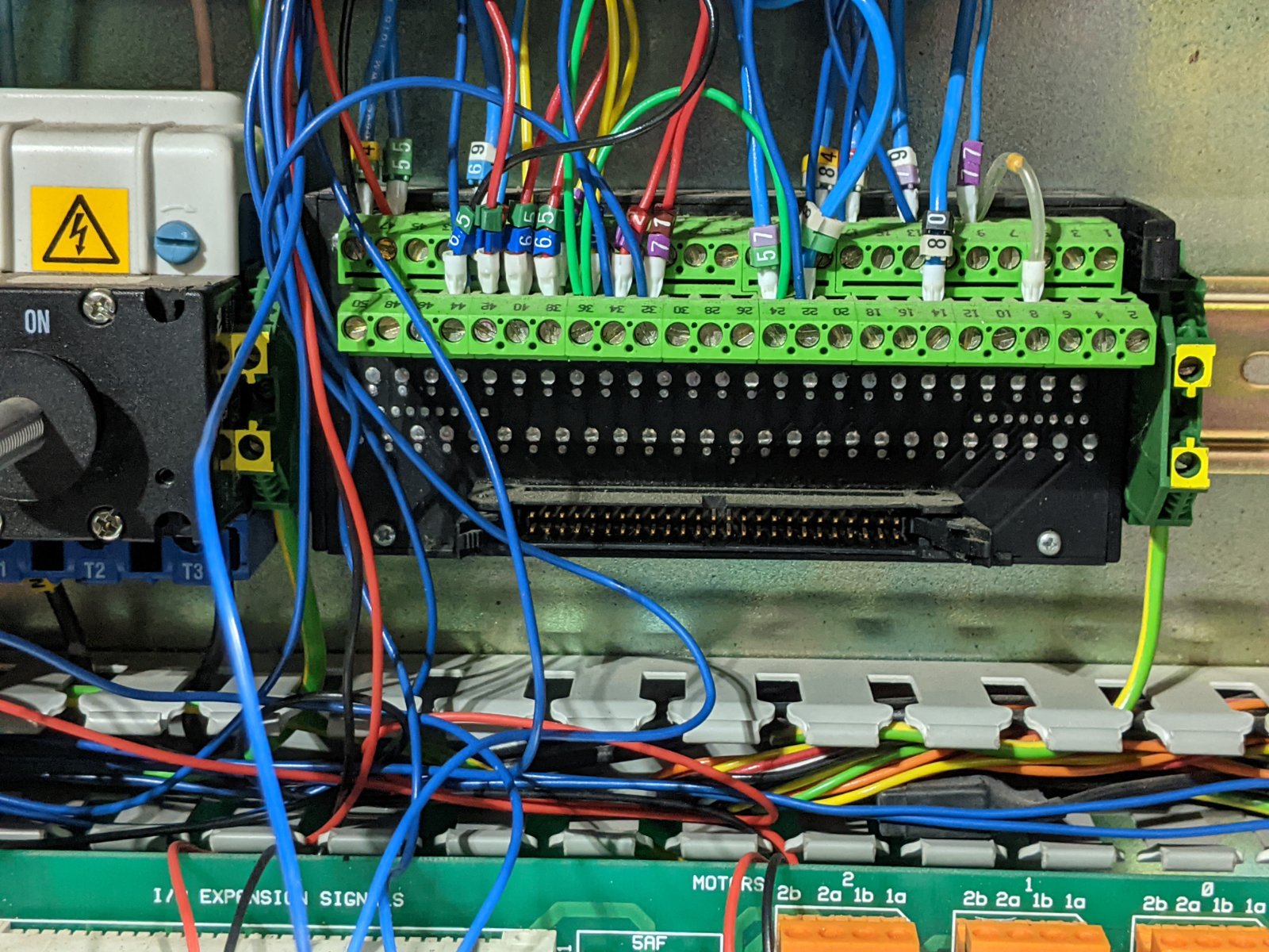

The set up of the mach 3 was how I acquired it.
In the set up of the spindle m3 is CW and M4 is CCW
The spindle is in ports and pins is step pin 1 and step port as 1
Spindle set up is enabled with M3 as Output 1 and M4 as Output 2
here lays the issue I think
This is what I have established
Output 1 is port 1 Pin 14 is the spindle go relay
Output 2 is port 1 Pin 16 is the CIR Carousel In Relay
Output 3 is port 1 Pin 17 the Drawbar relay
I can not see anything that relates to the Signal Reverse Relay (SSR)

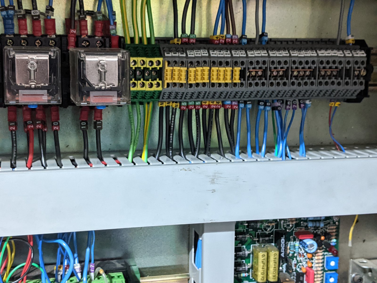

In the picture provided I think the relay on the left is the SSR based on the original drawings.
Without going down a rabbit hole between the two pictures should I have an SSR and whats the easiest way to id the pin the Relay occupies
As its been converted not all the wiring relates to the original drawings

Spot on Dave :) so i wired up port two pin 16 to another relay to switch on the reverse relay but also had to have a signal wire from breakout board to the spindle go relay the issue i then had was that the sgr was always on, solved this by putting a diode in series from the signal wire that fed between 79 and 80 :) and all works as it should, :) i just wished the person that sold it to me had told me that they had wired it as such.
