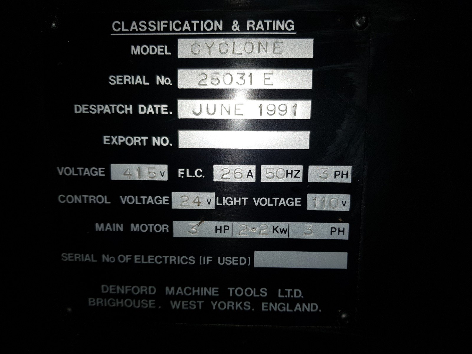

I don't know much about it - I don't even know the model number! I'm hoping the serial number above will shed some light on it.
I need to run it on a phase converter of some sort. I need some advice on that front. I've read everything I can find on here - and the only info was that I'd need a 10Hp / 7.5kW converter - though it wasn't clear if the person suggesting this had actually done it or was suggesting based on the spec?
The rating plate says 415V at 26A (32kW?) which seems high even as a worst case startup current. I presume the VFD on the spindle can be tuned down a little to bring this into the realms of realistic budgets.

So, mine is a Cyclone P - that's a start!
The current quoted in the literature as well as on the rating plates seems random! I've seen rating plates as low as 16A and up to 29A where the literature is generally 16 to 20A.

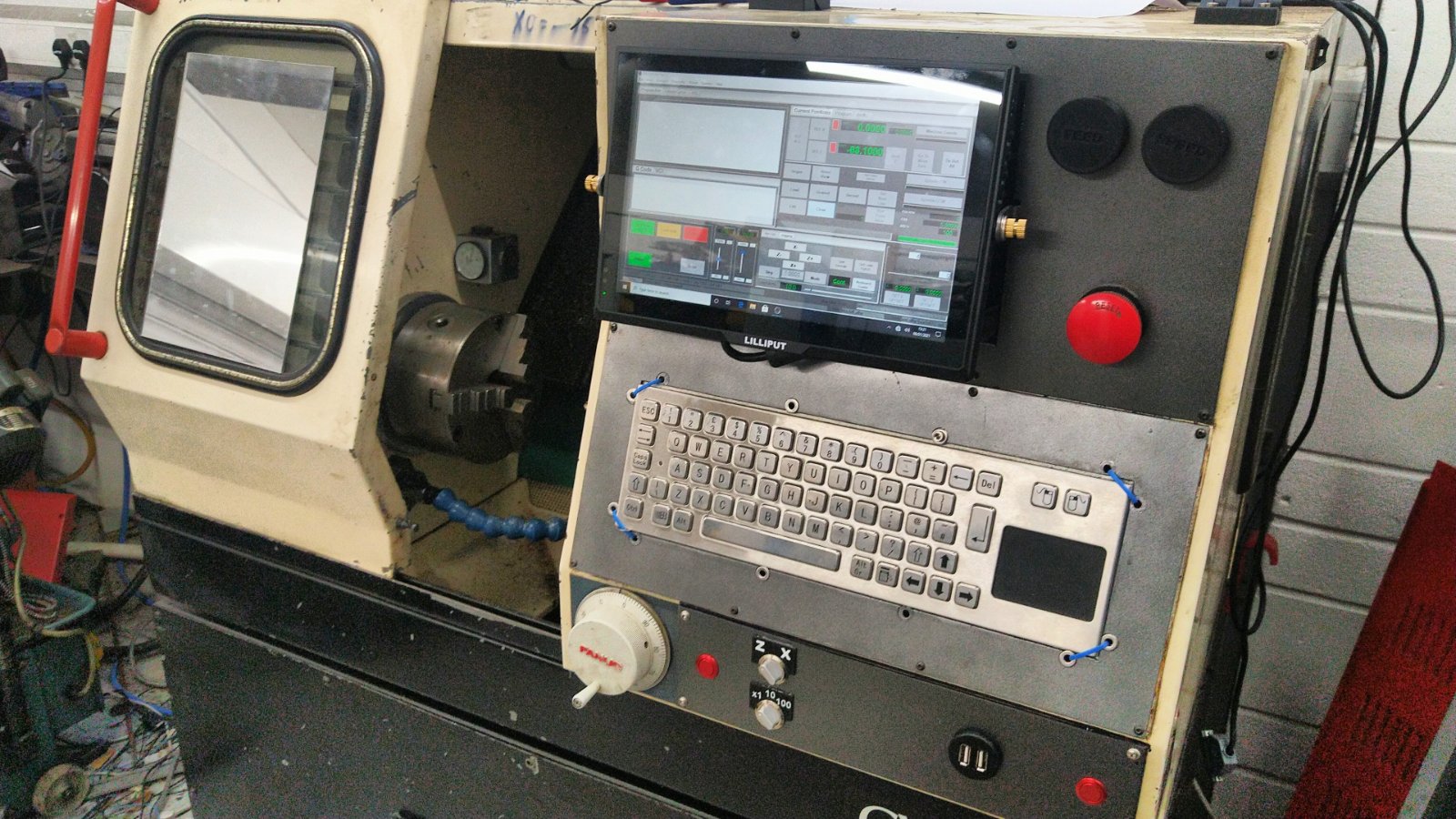

I've been in the process of converting my Cyclone to run Mach4.
[While I like Fanuc and the OT-B isn't the worst of them, the lathe is best suited to production work rather than small, quick jobs because of how time consuming it is entering the G-Code. I figured Mach4 would suit my needs better.]
I've also been converting it to run on single phase. I've used a small 1.5kW VFD to supply 3PH 230V into a 115V step down transformer to supply the coolant pump, fan, contactors & tool changer. However the spindle is what really takes power to run - and I found it's happy running on single phase!
You have to connect two of the 3PH 230V inputs together. Connect them to Live and the remaining phase to neutral. It's worth trying two phases only at first. Change which two out of three until the display lights up. If you run it like this, you get AL-02 (low voltage) Alarm. Try connecting the remaining phase to one then the other of the two and in one combination, it runs perfectly!
So, by separating the feed to the spindle (through a contactor), you can run the rest of the machine from a single 1.5kW VFD which is inexpensive. I tried one of the Chinese Cheap inverters, but I failed to persuade it to run up on connection to the mains. There is a parameter for this - but it didn't work on mine. Instead I bought a Delta VFD which worked as expected.
You still need a choke for the small inverter - but a much smaller one.
Re: New Cyclone - need phase converter advice.
I've now finished the Mach4 Conversion - and it works well, including threading & Rigid Tapping.
I've used a CSMIO-IP/S which will talk directly to the OE Spindle Encoder.
2 x Allen Bradley Ultra3000 Servo Drives which will directly control the original Fanuc Red Cap Servo motors, with Step/Direction (or 10V Analogue if you want).
The Toolchanger, I think because it's old, was much simpler to control than some. It has just 4 outputs (of which only 3 are used) for the binary position of the turret, a brake (24V) input and 3Ph 115V in for the motor. I wrote a very easy toolchange macro in Mach4 which works reliably.
I think,the hardest part (other than research to find pinouts of the motor etc connectors) was that I had to make my own 3Ph 300VA 230 to 115V transformer out of 3 x single phase transformers connected together. I just couldn't find one to buy that was affordable and/or small enough.
Cyclone After.jpg (327.73 KiB) Viewed 46016 times
If any of you are thinking about a similar conversion, I'm very happy to answer questions. The setup of the Ultra3000 drives is easy once you know what you're doing - and I can help with that too.
I Plasma cut the replacement control panels. The Keyboard is held in with cable ties as I had an earth-loop problem and I wanted to try isolating it & earthing separately. However it was something else, so it's now earth bonded to the chassis. I've not got around to replacing all the mounting screws yet.
It's probably the most challenging conversion I've done yet - but the end result is really good. No better than the original Fanuc in operation, but no worse and a lot more user friendly!
