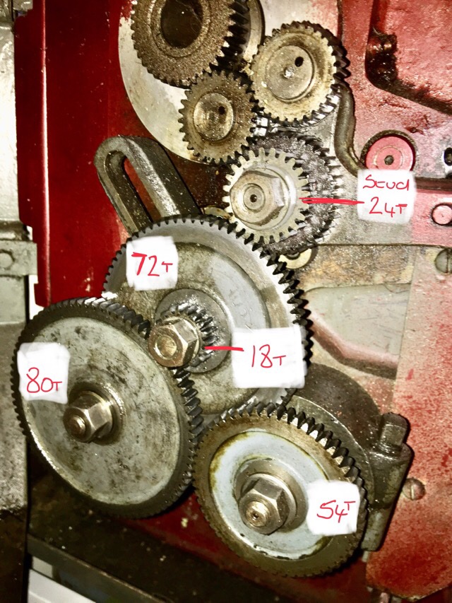

Thank you for your help I downloaded the program and I thought I’d start by what was left set up on the lathe from the last owner. it looks like he was trying to cut a 72 TPI thread here are the pictures of the gears. I’m trying to understand when the program tells me what gears and where the gears need to go. But for some reason the 80t gear dose not show up as being needed in the software.I don’t understand the difference between the driver and driven gears
Does it matter which way round they go my guess would be if the 80 tooth and 54 teeth are the opposite way round you still end up with the same result or am I wrong.

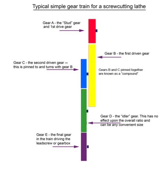

Ok I've add a picture that explains the D gear 80t. But the software suggested order is not the same as my setup, dose this matter

The driver gears are any gear that drives another. The driven gear is any gear that is driven by another. Any gear that both drives, and is driven is called an idler. Idlers are just space-fillers, you can fit any size gear so long as it fits in the space available.
In your pic the 24T Stud gear, the 18T gear are drivers, The 72T and 54T gears are driven, the 80T is an idler.
In a simple gear train ONLY the first and last gears, plus any compound gears count towards the ratio. So you can't change the first, the last or the compound without the ratio changing.
That said, you CAN move stuff about if you follow some simple rules:
Any driver can swap places with any other driver without the ratio changing.
Any driven can be swapped with any driven without the ratio changing.
Any driver can be swapped for a gear with a different number of teeth PROVIDED that any driven is changed by the same ratio, without the overall ratio changing. This would be handy if for instance you didn't have a 54T gear, but you did have a 72. You could use the 72 instead of the 54 as a driven gear (54x4/3=72) so long as you applied the same ratio to any driver i.e the 24T stud gear (24/3x4=32) would be changed by fitting a 32T stud.
