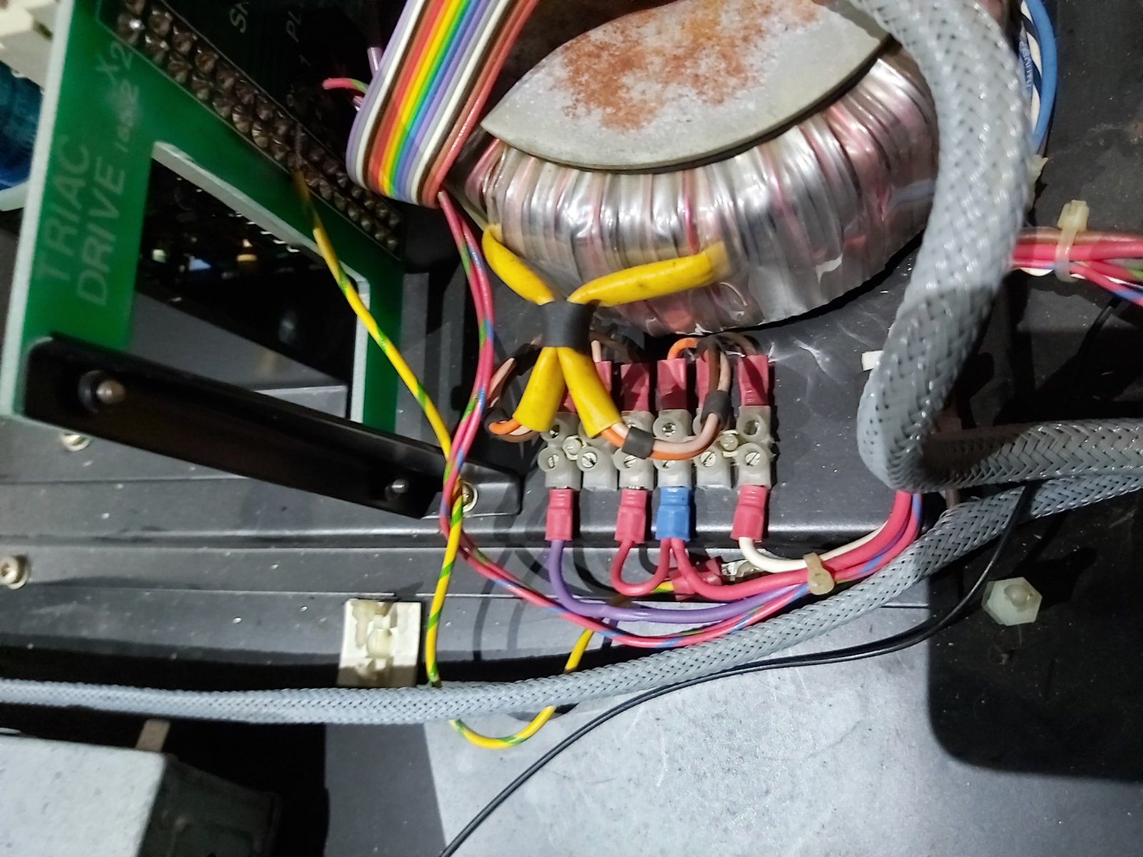

Does anyone happen to know what the primary taps are on the drives toroidal transformer?
I have a purple, red and white to the primary, with red jumpered to a second terminal. Trying to get power to this without releasing any magic smoke. Also, what role does the contactor play? E-stop?
It's an issue 2 system btw.
