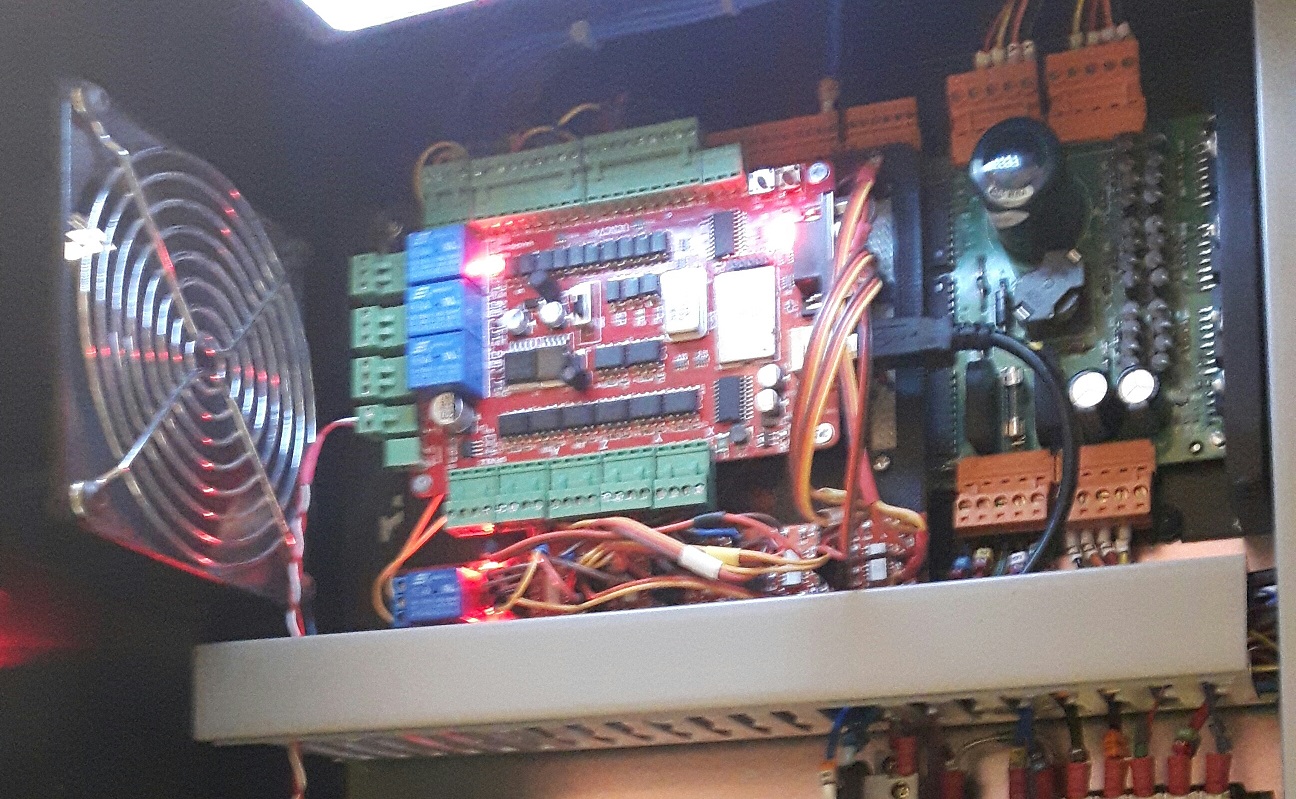

This is definitely a timely thread for me. I'm "upgrading" my novamill to run on a Chinese USB CNC controller card and finally got round to testing the spindle yesterday. Everything except 24v supply and the spindle drive signal is opto-isolated and interfaced via the 96 way header. This has been running well for a year or so just driving the steppers as I've been using the mill as a 3D printer.
My view is that the sprint spindle control board is definitely running on a high AC voltage and the speed demand pins are coupled to it in some way. Whilst my USB CNC 0-10v spindle output has survived the ordeal I'm getting the board crashing at greater than half speed, I suspect because of 50hz noise feeding back up the sprint demand line and an associated relay on the USB cnc is ticking nicely at about 50hz when the spindle is running.
There are a pair of axes demand pins on the 96 way header according to the denstep card manual, does anyone know if these are for sending the signal from the control card via the back plane (with some filtering / isolation hopefully) out of the normal back plane to sprint connections?
Otherwise does anyone know of a way to isolate a variable 10v signal line between the two cards? I'm an electronics hacker so no in depth knowledge here unfortunately.

OK that looks great and the linked information has sent me in an equivalent direction.
I have a few more of the opto-isolating boards left (I bought a job lot from China) so will isolate digitally from a PWM spindle signal (the controller can do 0-10v or Radio Control PWM) then use the +10v and ground on the sprint to drive that side of the isolating board and add in some signal conditioning to get the full 0-10v range. Think I finally need an oscilloscope... ;-)
I got started with USB CNC with my hot wire cutter and an all in one 4 axis board a while ago and really like the interface and the fact that it's a controller rather than just a BoB, so I want to go common across my workshop. My plan is to try and make a fully plug and play control card assembly as I effectively have two novamills (one original, and one set of electrical components going into a larger home built router) and a novaturn to convert and wanted to have a common set-up to cater for component failures etc.
I've included a pic of my set-up for interest sake, it's not the latest wiring standard (pre spindle control) but you can see the isolating daughter boards mounted on the bottom of my 3d printed bracket which holds the 96way header and the Chinese controller card. Hopefully I'll just have connections via the 96way connector, flylead to the spindle card, and a 24v power supply, when finished.
