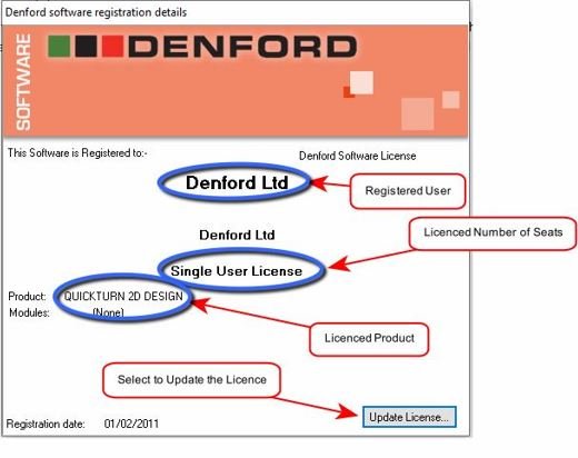

The Denford software is licenced with a flash key that appears on screen as you run the software. The licence is supplied when the software is purchased either on CD or delivered by email.
The Screen that flashes up as you run the software Identifies:
• The Registered User
• The Licensed number of Users
• The Product that is Licenced

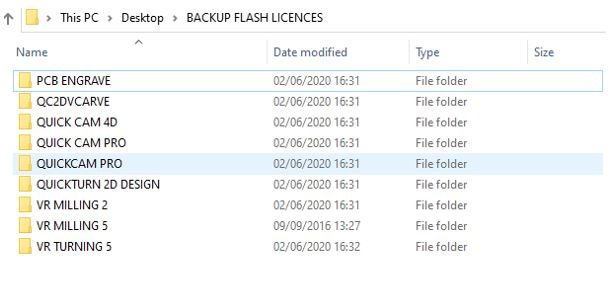

As such you should always make a backup as a series of folders containing the software licence for each Product.
The following is a typical backup file structure with the BACKUP FLASH LICENCE folder on the computer desktop then a series of subfolders for each Denford Software product you have.
The Seckey.tff file for each licenced file should be copied into the relevant folder for safe keeping.

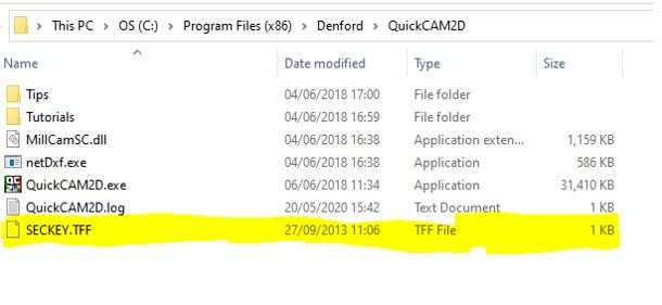

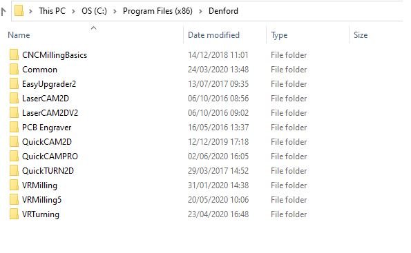

By default the Denford software is installed on your PC in the C:\Program Files (x86)\Denford directory. Each product is then installed in its own subfolder.
If for example you then open the QuickCAM2D Subfolder you will find the Seckey.tff file there.
Simply copy the file and paste it into the correct folder in your backup directory.
