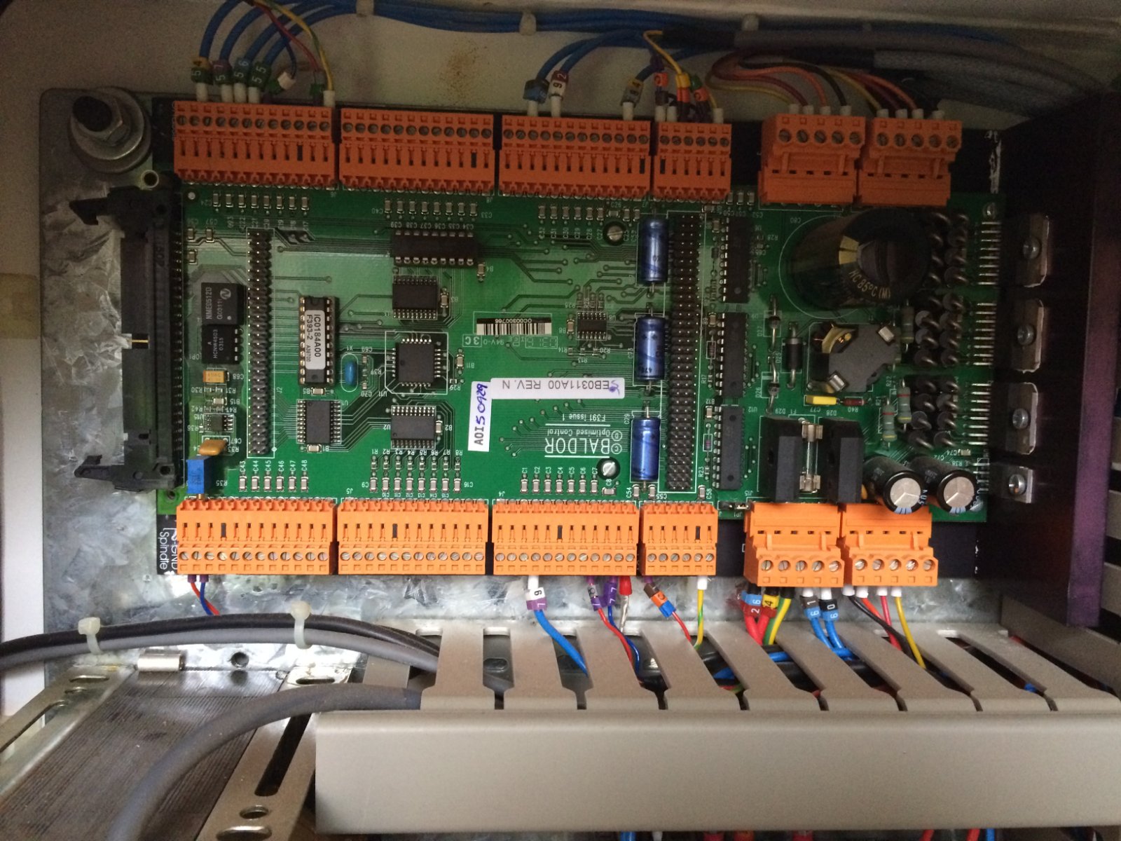

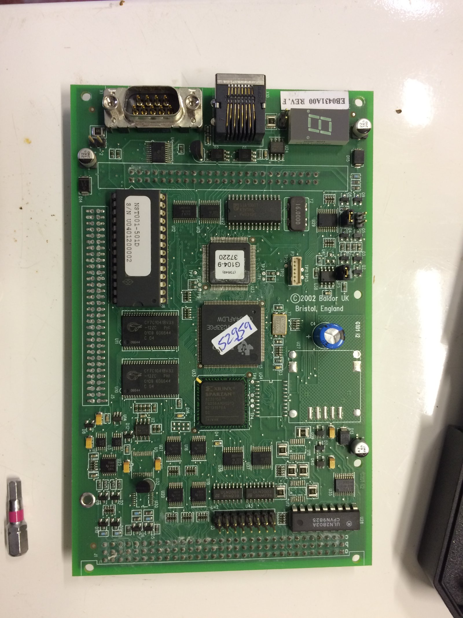

Ok 1st thing open up the side of the cab, take some pics of the control board included the sticky labels on the top of the chips. We need to know that so we know what control it has onboard (many have been upgraded from what the plate says on the side).

Thanks for the reply. Attached are some photos.
I would like to keep the original electronics but unable to purchases a licence as Denford is shut until further notice due to covid19.
It would be nice to see if everything works as it should before getting a licence as it would be an expensive job is any off the electronics needed replacing.

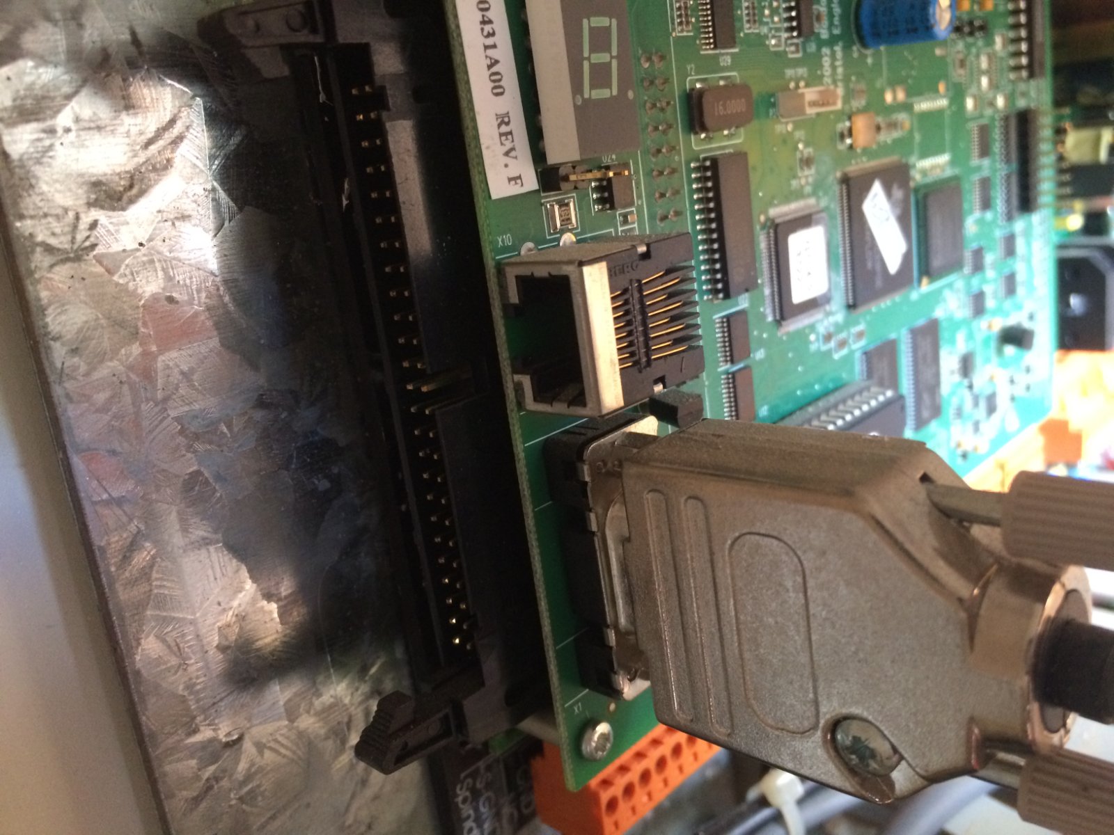

ok you have a next step RS232 card so you will need to ensure your PC has an RS232 port, it doesn't need to be anything high spec unless you are doing the CAD on it. I tend to do the CAD in the house and take the file to the garage but inevitably found i have had to modify things so upped the spec, Its just an old Dell dual core. You would be able to run VR5 to control the machine.
Providing the electronics are all OK the only thing they normally need is a good clean out, easier to point and say whats needed than to type.

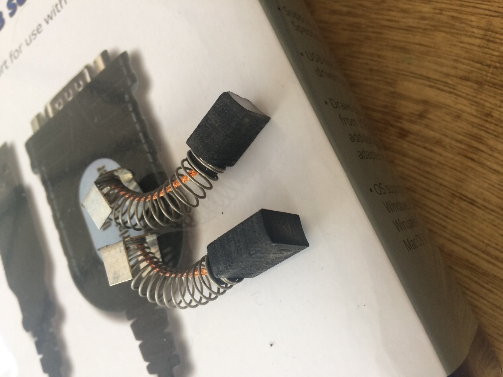

If it has the portacable router motor, it's worth popping it out of the mount and checking the brushes aren't worn. I would replace if getting down to about 5mm, does it have the vacuum bed?

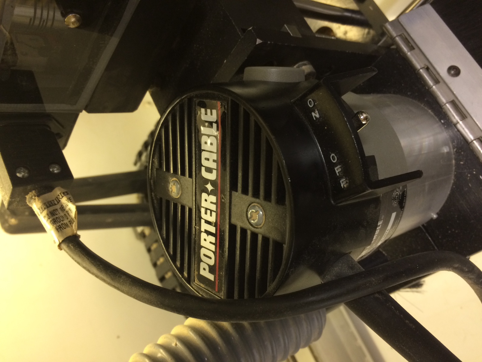

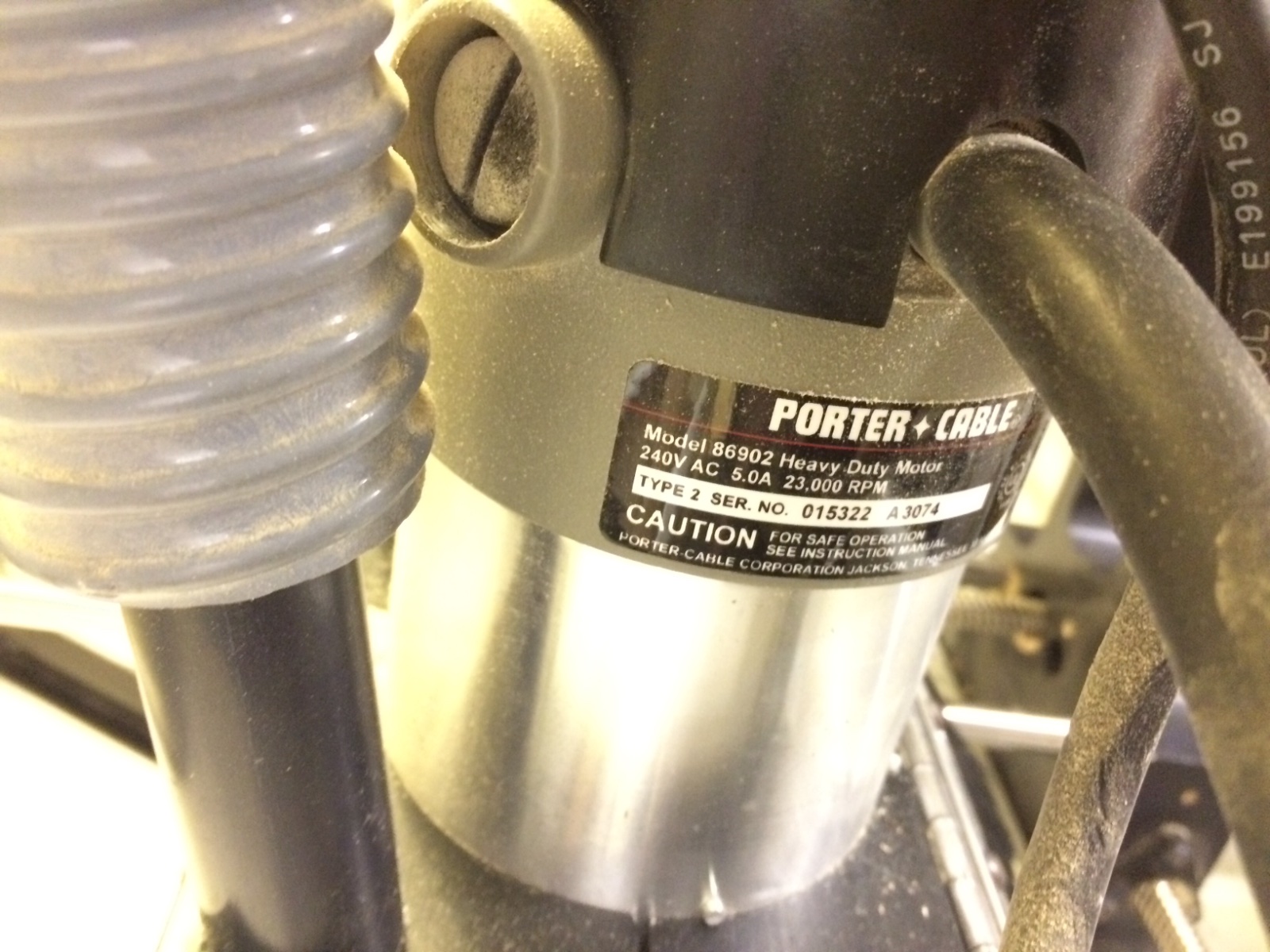

Not sure if it’s a newer motor or not but this is the motor on it
Re: Advice
that looks to be the later of the 2 types fitted, the aluminium base holding it is just a clamp with an allen key, loosen it off and you can lift the motor out (unplug) use a coin or large screw driver to undo the 2 plastic covers (slowly) the brushes are in there, bit of a fiddle but they just pull out, you can check the length then for wear. Should look like this https://www.ebay.co.uk/itm/Porter-Cable ... 3331950151
so you get an idea of how much use they have had.
Re: Advice
Thanks Pete
Already removed from the machine, Will check them when I get home
Re: Advice
Don’t look bad

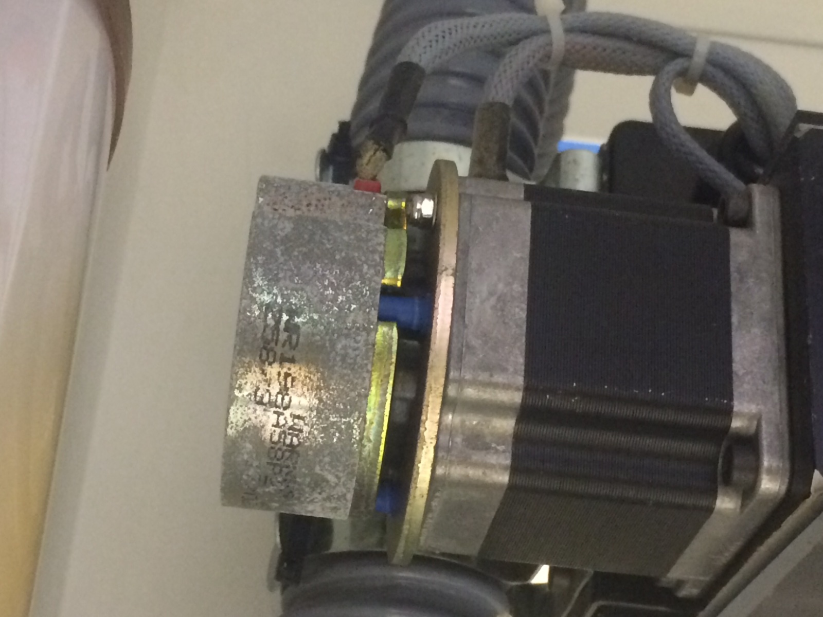

Anyone know if the z axis motor as been modified?
Don’t show the extra part on top in the manual
Re: Advice
thats a brake, rather than relying on the stepper to hold the height, not fitted to all machines.
Pete.
Re: Advice
Thanks Pete
Makes sense why I can't turn the motor by hand
