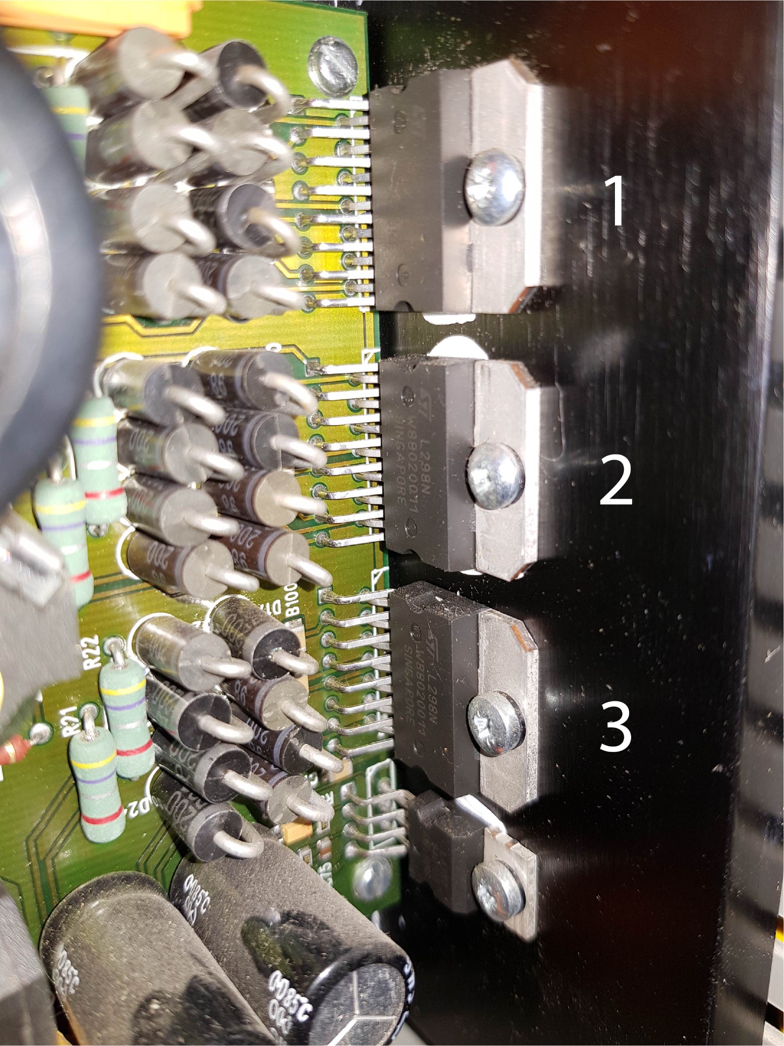

is it 1, 2 or 3. any help would be appreciated.
Re: Microrouter Y axis not working
Bit difficult to say for sure without digging out the diagrams, looking at the tracks on the board it looks like those from No2 go to the Y connection.

Thats a very kind offer Pete , I am based in Derby and willing to travel a little and willing to pay for your time . But If you happen to live too far away then what I will do is order the part you sent the link to and see if I can have a go myself.

After doing some reading I did think it might be the chip next to the heatsink and when you confirmed the same thing It did make sense to have a go and considering the cost I think it wont hurt to try replacing it.

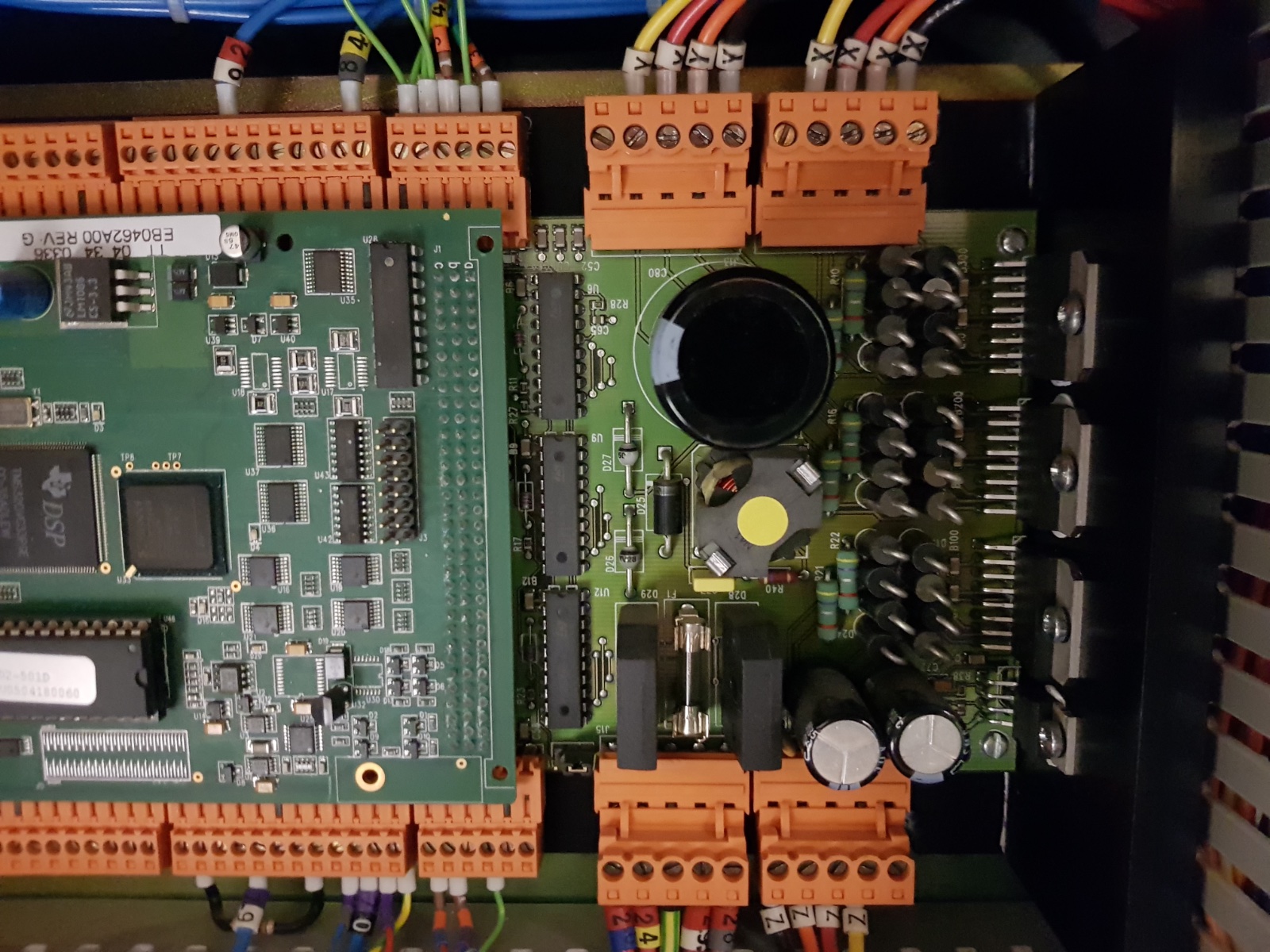

I'm getting the same problem as Mani. I have replaced the driver chip, as suggested by TDIPower in this thread, but no change in behavior.
I have tried to do a bit more debugging and found the following:-
1) after pressing the secret home button, go to Jog tab where X and Z axis work fine, BUT so does the Y axis (without swapping any connectors). When you go back to the Home tab and press Y home, I get the funny juddering and the Y axis drives in the wrong direction and I need to press the Emergency Stop.
So just to be clear, what ever I do the Y axis works fine in the Jog tab, but judders and goes the wrong way in the Home tab.
Now I'm not sure if this behavior occurred before I replaced the driver IC, cause I never did this test.
2) the large capacitor and 2 bridge rectifiers are getting quite warm, not to hot to touch, but definitely hotter than I would expect.
Any suggestion?
