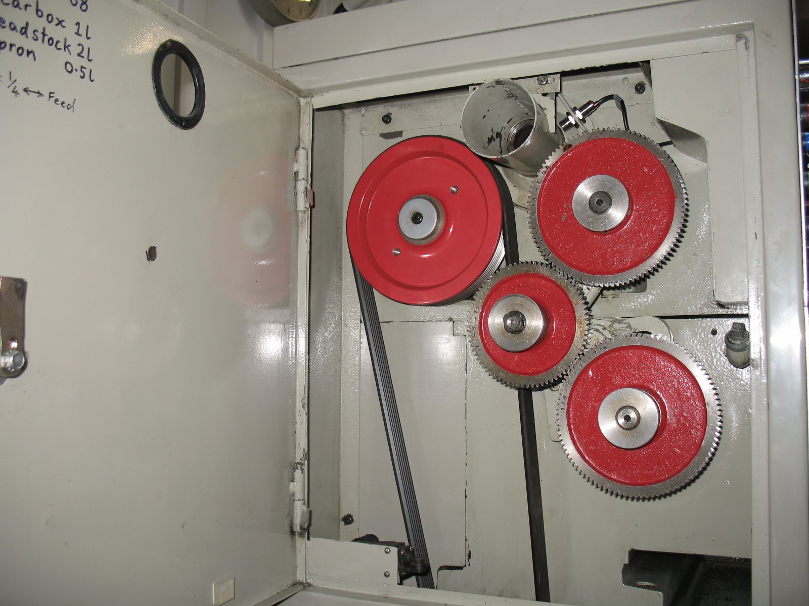

It isn't a Viceroy lathe but I used the Viceroy to make parts for the conversion. This included pulleys for the poly-vee belt conversion.

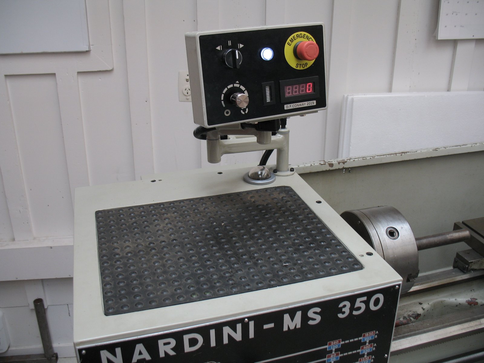

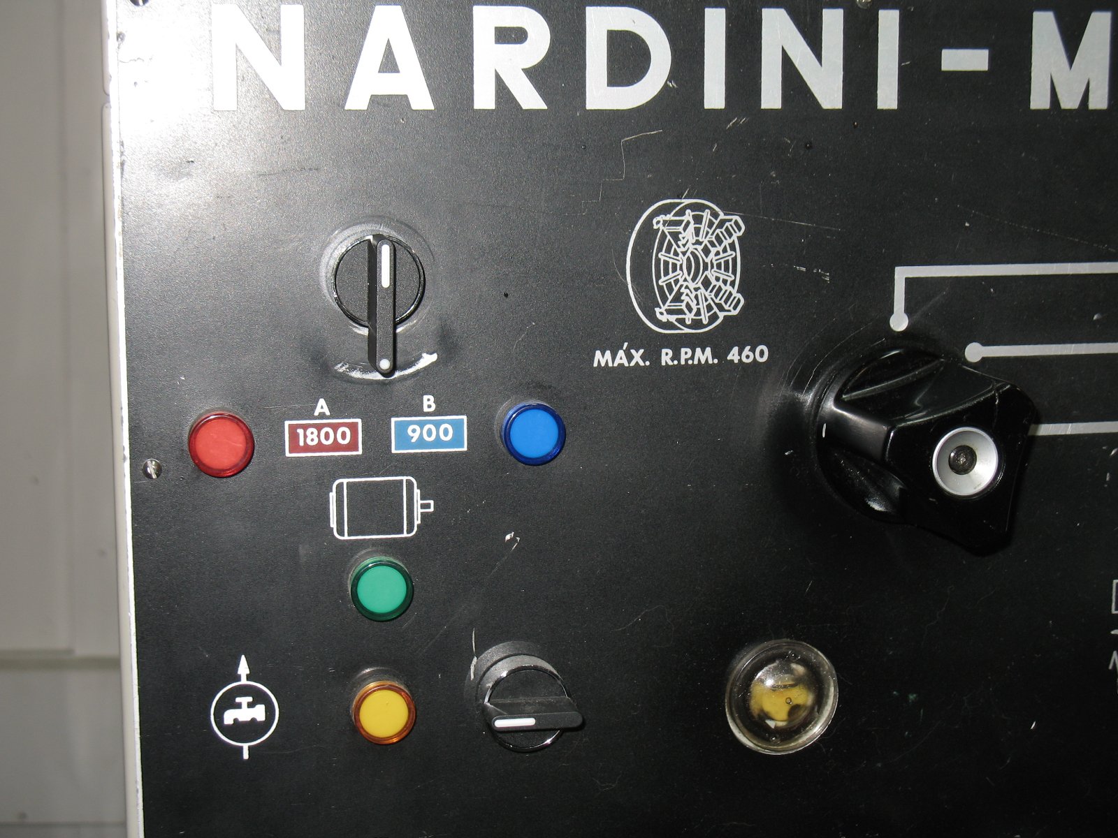

All of the incandescent lamps are replaced with similar looking LED versions. The switch positions are adapted to control the VFD, so no empty holes. As with the Viceroy conversion, the added control panel is the only dead giveaway that it isn't original. I couldn't decide where it should be located, so it is mounted on a highly adjustable articulated arm. It is high enough to clear tools placed on top of the headstock. The control panel adds a LED bar power meter and an e-stop switch to the controls installed on the Viceroy. The artwork is designed to match the style of the original factory labels.

The new poly vee belt drive system, made to look factory.  Painted to match the original back gears.
LED conversion of main control panel
Added control panel with jog, rpm control, rpm display, power display and e-stop,
