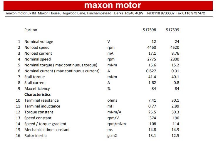

Regarding your question about why more current would flow when the motor is stalled. I'm assuming this is a permanent magnet DC motor like in my Orac tool changer, when the motor rotates as the windings are moving through the magnetic field they generate a voltage which opposes the applied voltage so when it is running no load the true voltage running the motor is the difference between the two and is what is required to overcome internal losses and friction so could be a fraction of a volt and so current flow is low, when the motor is stalled no opposing voltage is generated and so the current will be far higher and governed by Ohm's law and the internal resistance of the motor windings. Between the two when you load the motor it slows down so produces a lower reverse voltage and the true voltage powering the motor increases as does the current and power produced.

I have just found these specs which i believe to be correct for the 24v motor. (it has the 12v motor too)
I'm trying to remember about how they are wired. I know the cables for the motor run down through the gear box so you need to be careful about them as only really fine wires. This I think was a Denford modification so that the motor/gearbox could be fitted in the external heatsink/case. Now I cant remember what that went to in order for it to then be connected to the cable that on my machine plugged in near the head stock. i do remember having to unsolder the motor so I could strip it to replace the gear box.
So given this information I could check all the cables, I wonder if one has worn through the sleeve possibly in the motor case over time.
