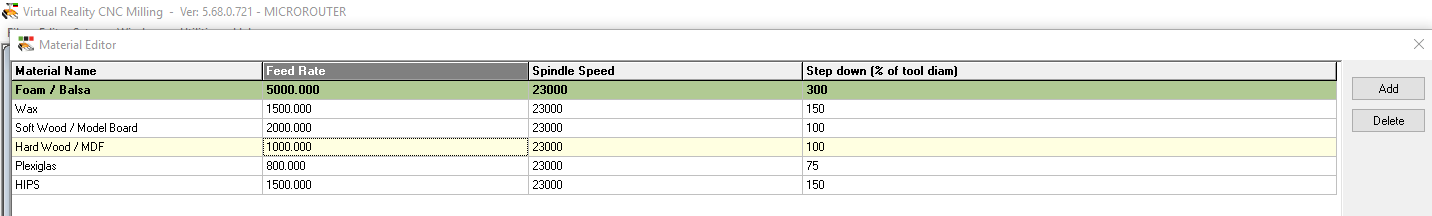

We recommend a feed of 1000, spindle speed 23000 & depth of cut 100% of tool diameter.
Microrouter Materials.PNG (12.01 KiB) Viewed 23917 times

so if Im using a 6.3mm router bit, you recommend 6.3mm DOC @ 1000mm/m?
wow
Re: Feed rates?
Yes that's what we use.
If you want you could lower the depth of cut & increase the federate.
Re: Feed rates?
and a denford microrouter can handle that?
Re: Feed rates?
I run it all the time on the 2 machines at work and mine at home, your ears are your friend... if it sound rough dial it back on the over ride. So if you are doing a plunge/slot cut then I might dial it back a little then when it is up or down milling it will be fine on 50% step over
