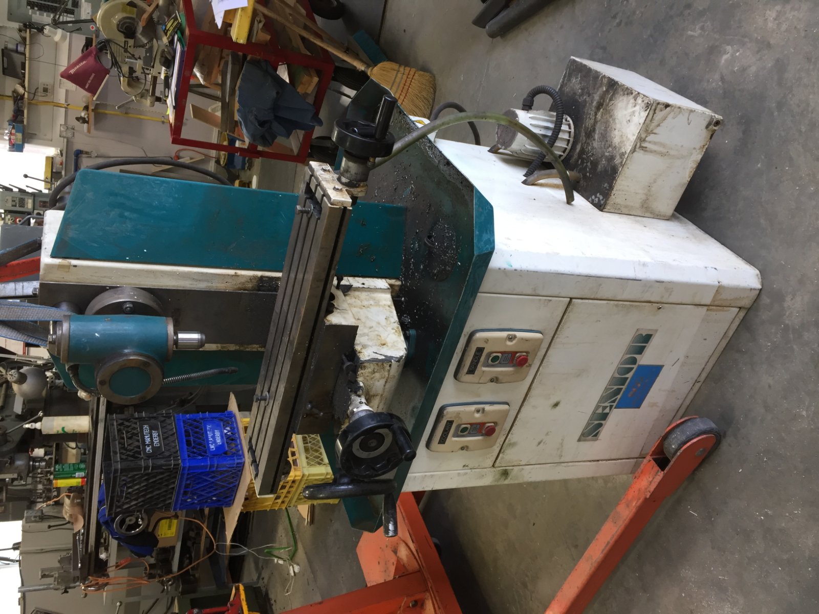

I am in B.C. Canada, and just acquired a Denford Senior/ Junior Milling machine
The S/N is EO 2952, and Dispatch date is Oct 1986.
First - I am looking for a manual & drawings. Second it has a collet stuck in the vertical spindle, so what it the taper, and how do I remove it. I backed off the retaining stud, and gave it a rap with the hammer, but it did not move. Any ideas.
