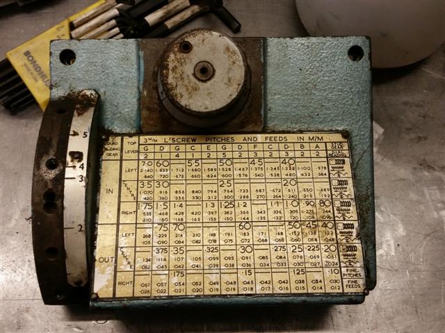

TDS 1/1 Feeds and speeds plate
Just wondered if anyone could send me a good picture of the speeds and feeds plate that goes below the dial, mine is missing, I might be able to make one on my laser with a good picture.

Re: TDS 1/1 Feeds and speeds plate
Is this the thing you need?
Yes thats the one i need
Ok send me a message with your address, pay the postage and it's yours.
I seriously recommend you make your best effort to change that front plate without removing the gear change lever though. It has an odd number of splines and teeth on the rack gear and if the pinion disengages it's easty to trash the gears by not getting it back in with full engagement.
