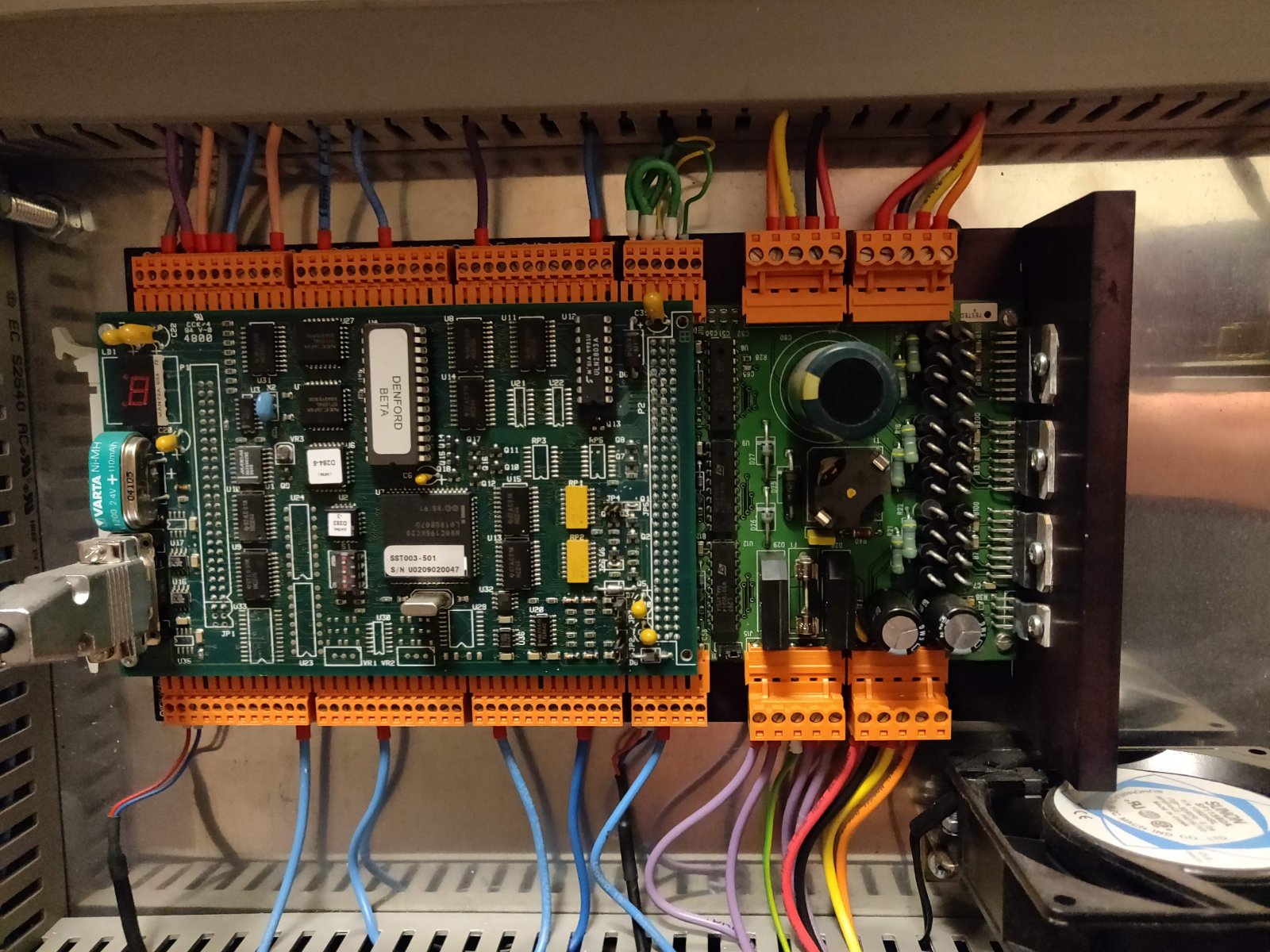

First it would be useful to know which boards are fitted in the machines, Pop the panel off and a quick pic inside of the board that has the fan blowing on it in the micromills, there should be a 32pin eprom that has a sticker over the window saying which software version it is. From that you can work out if you could run the later VR5 software as it looks like you have VR2 with it being on disks.

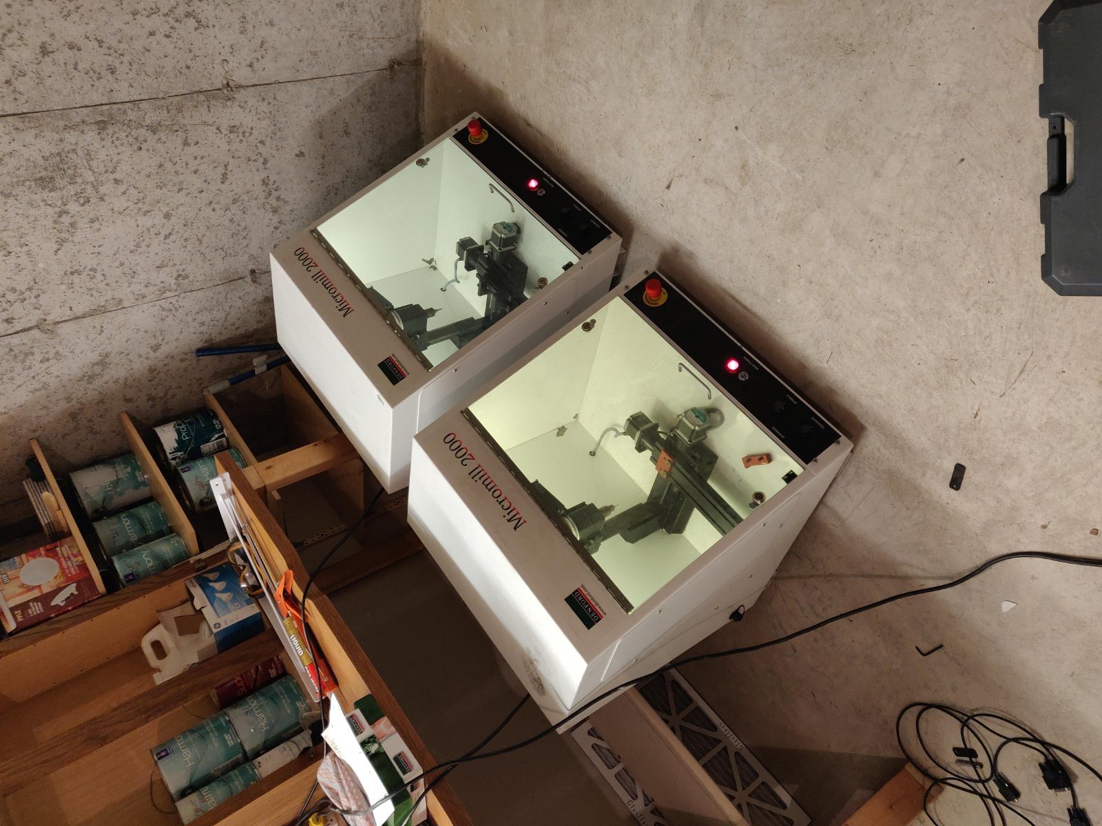

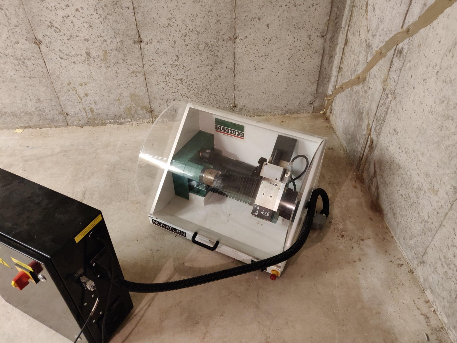

Hi TDI! I'm not at home to check the eeprom now, but the mills have the red 7segment display, so as I understand that is the denstep board. The novaturn has the Nextstep board, unfortunately it only has the db9 connector, but has the green 7seg, and the machine is called a novaturn ns on the tag... In talking with support I discovered the novaturn original control cable is pretty important, so I repaired that and rechecked the connections. I have 4 floppies of VR milling 1.47(not sure of version) and one version of vr turning 1.7. (maybe, it also comes in 3 separate floppies) I got a floppy reader to try to pull the security keys, but reading the files is a bit wonky and I'm not sure if I'm seeing everything. (I hope I just cant see the security keys lol :? ) I actually think I have seen a few flash.ini's tho, so you are giving me more hope! :fireworks:

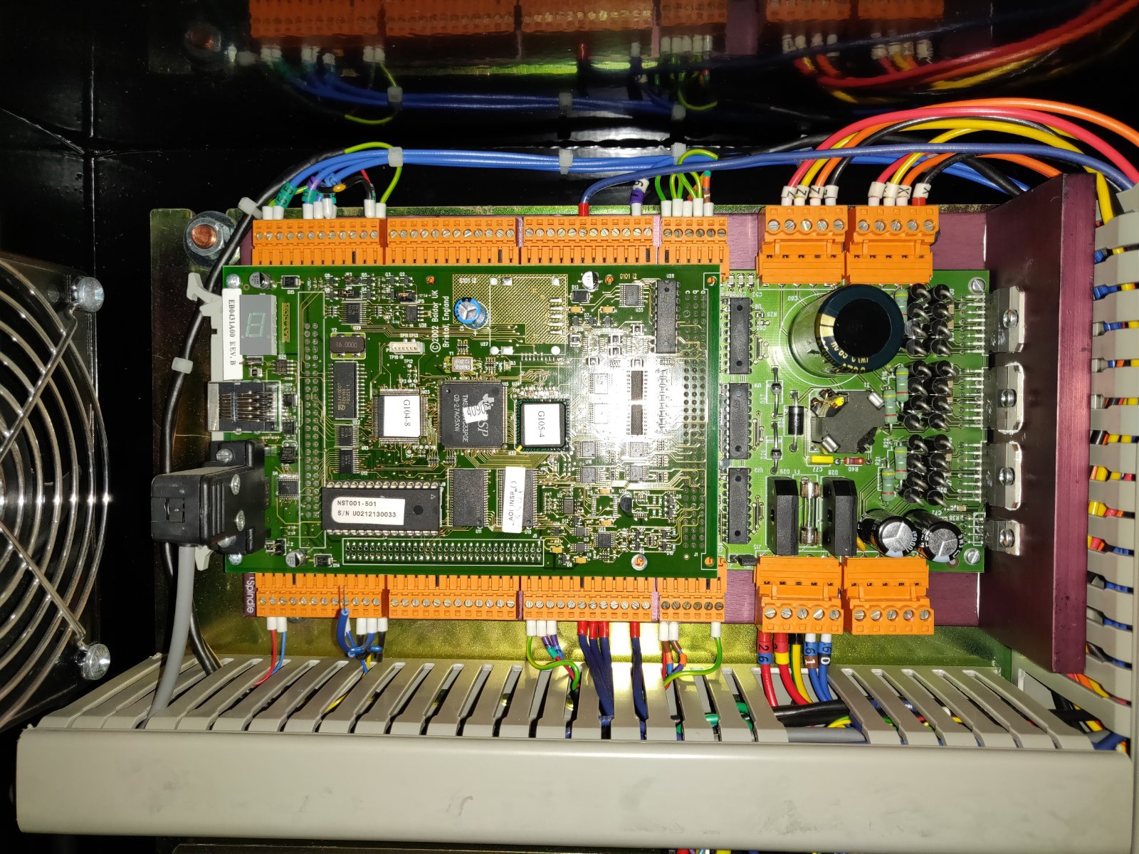

I actually had some pics, so the eeprom chips are visible. Not sure what "denford beta" is, but I don't like the sound of it hahaha, something tells me beta doesn't align with "long term support"

From looking at the Boards yes, micromills are denstep, Pretty sure the Beta means it can run VR5 as well as VR2.
Novaturn is NS later board just prior to the USB port.

Looking at the photos, the moulded leads 'look' right for what would be shipped with the micromills, the screw together case right for the novaturn.

Just on another note, in the pic of the NS controller, I noticed there is a blue wire that looks to be disconnected, without going through the wiring diagrams I wouldn't know what it is for though. If I get a bit of time Ill have a look, you can Dload the diagrams from on here although Martin may be along (he is from Denford) with some pointers for you.

Yeah I had actually disconnected that to see what the component was, there are 2 of them with who knows what purpose. The original wiring diagrams for the entire cabinet are still in the door, so if anyone needs a copy of that or just wants a specific section let me know and ill grab a copy. Really impressed by the novaturn overall, really beautiful work went into this. The mills are nice too, but clearly aren't quite as complicated haha
