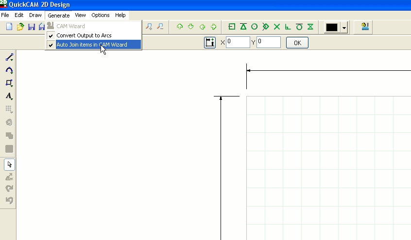

There is a feature in QuickCAM 2D that autojoins lines if the ends are within the diameter of the cutter.
Turn this feature off from the Menu as shown and this may fix the problem.
