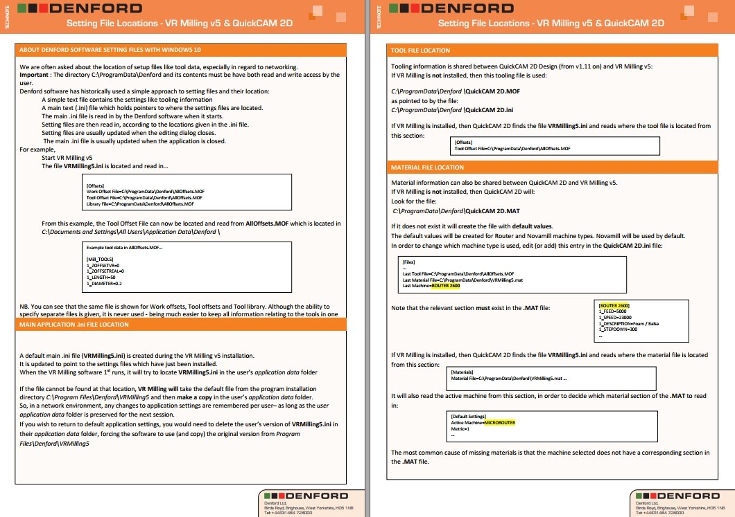

Tool and material setting files
How VR Milling and QuickCAM 2D locates the tool and material setting files...
eg:
VRMilling5.ini
QuickCAM 2D.ini
QuickCAM 2D.MOF
QuickCAM 2D.MAT
V5 Milling - Setting File locations.jpg (168.5 KiB) Viewed 17881 times
Download as a PDF here:
V5 Milling - Setting File locations.pdf
(338.51 KiB) Downloaded 1760 times
