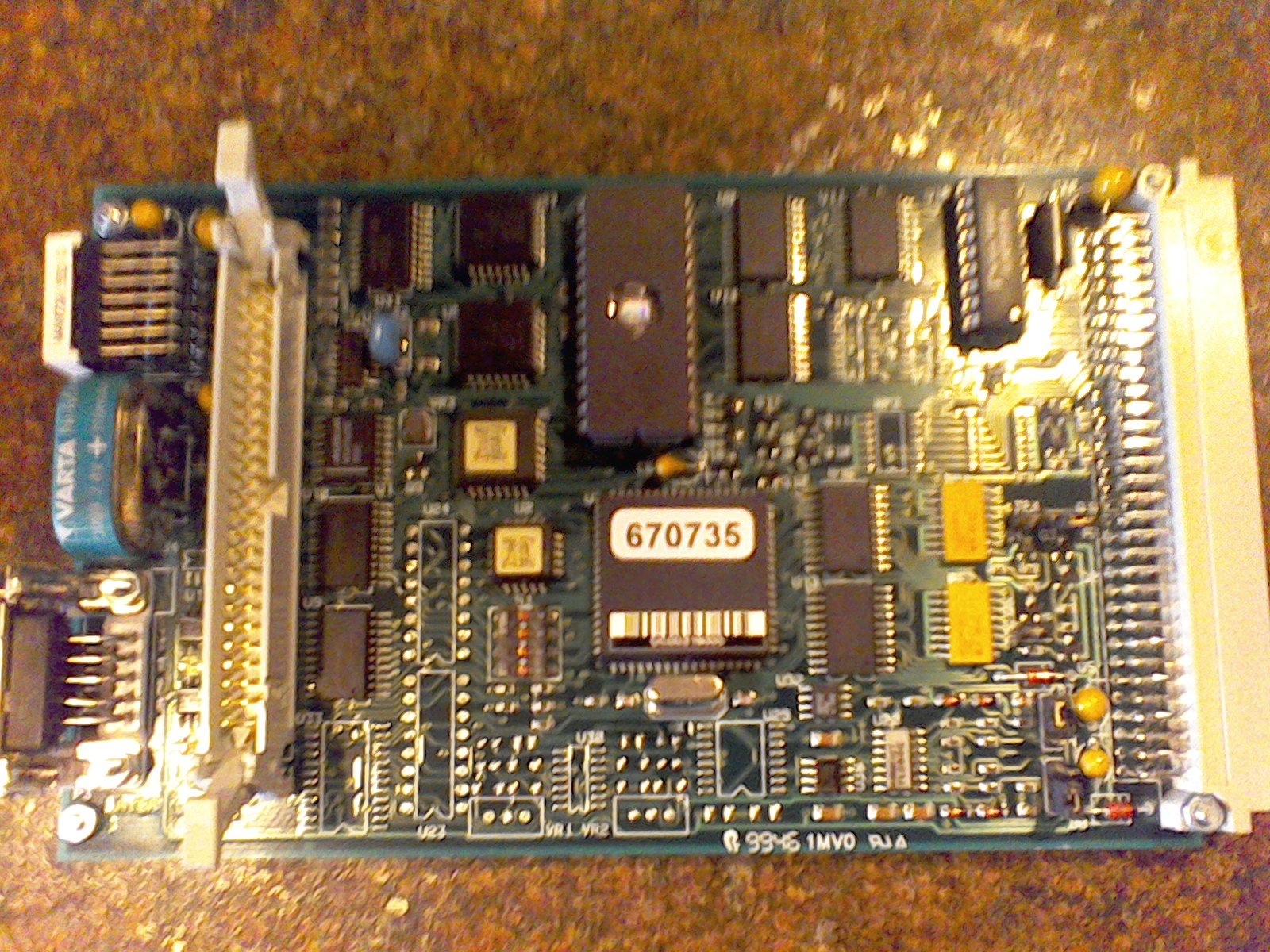

What E prom do you have fitted on the Baldor control card. It may not be what we call a VR E prom. (It should be 2.0 or 2.0 Beta or 2.1).
Re: Yep, another machine can't connect
My eprom didn't have a label attached, it was removed at some point by the previous owner, a tech school.

Attached are pics of the control cabinet and control card.

This may or may not be the problem and likely not someting you want to hear but in my experience with the older technology removing the label on an EPROM results in the EPROM being completely erased, they aren`t supposed to get light in the little window that is normally covered by the Label as far as I know.

The eproms are erased by UV light when the window is exposed to it. So keep it covered, the stickers we used were a metal foil to prevent the UV penetrating. It has probably been fine as the machine will have kept it in the dark.
In the 80's / 90's I used to have access to erasers, readers/writers so it would have been easy to copy one (not sure how Denford would be about that as they may charge for them if they can still supply). When I saw this post I went straight to my desk with my PC as I have had a denford eprom sat on it for about 3years, I have no idea what version it was but I can't find it! It's bugging me as to where that has gone now.
