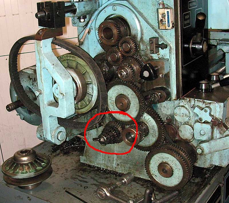

Your lathe has a gearbox on the front? With a round dial and a lever that you can set to N at the top or one of 5 positions? If so then the A-G gears are usually held on a stud under the end gear cover. If they are missing come back and let us know. Post up some pics of your lathe in any case.

Thanks guys for the replys. Yes my Grandad is the whole reason I love engineering in general. I don't come on the internet that often as you can probably see but I'm going to start. I'll take some pictures and see what you both think. The change gears were missing when I bought the lathe but at the time I thought the gear box did the work. I have got gear D but I read that's something to do with reversing aswel as cutting threads??? It's got the numbered dial 1-5 on the front with the lever to match 1-5. I'll get back asap with some pictures and go from there. Thanks again
Re: WANTED FIXED STEADY + CHANGE GEARS VICEROY TDS 1.1
Gear D doesn't do reversing, except that it sits on the tumbler reverse pivot. The tumbler itself does the reversing. What the lettered gears do is allow you to cut the full range of threads as shown on the front of the gearbox.
Look at the gear cutting chart. You'll see letters in the boxes along the top. The threads below the letter D are the ones you can cut right now with your one change gear. On a metric machine that means 1.0, 1.5, 2.0, 3.0 of the common-use thread pitches. For 1.25 and 1.75 you'll need a G and for 0.8 you'll need an A.
It's a shame your gears are missing, they are usually kept on that stud.

Hi Walid.
The spare gears should be stored on a bolt inside the gear change cover. Are you sure that they are not there?
