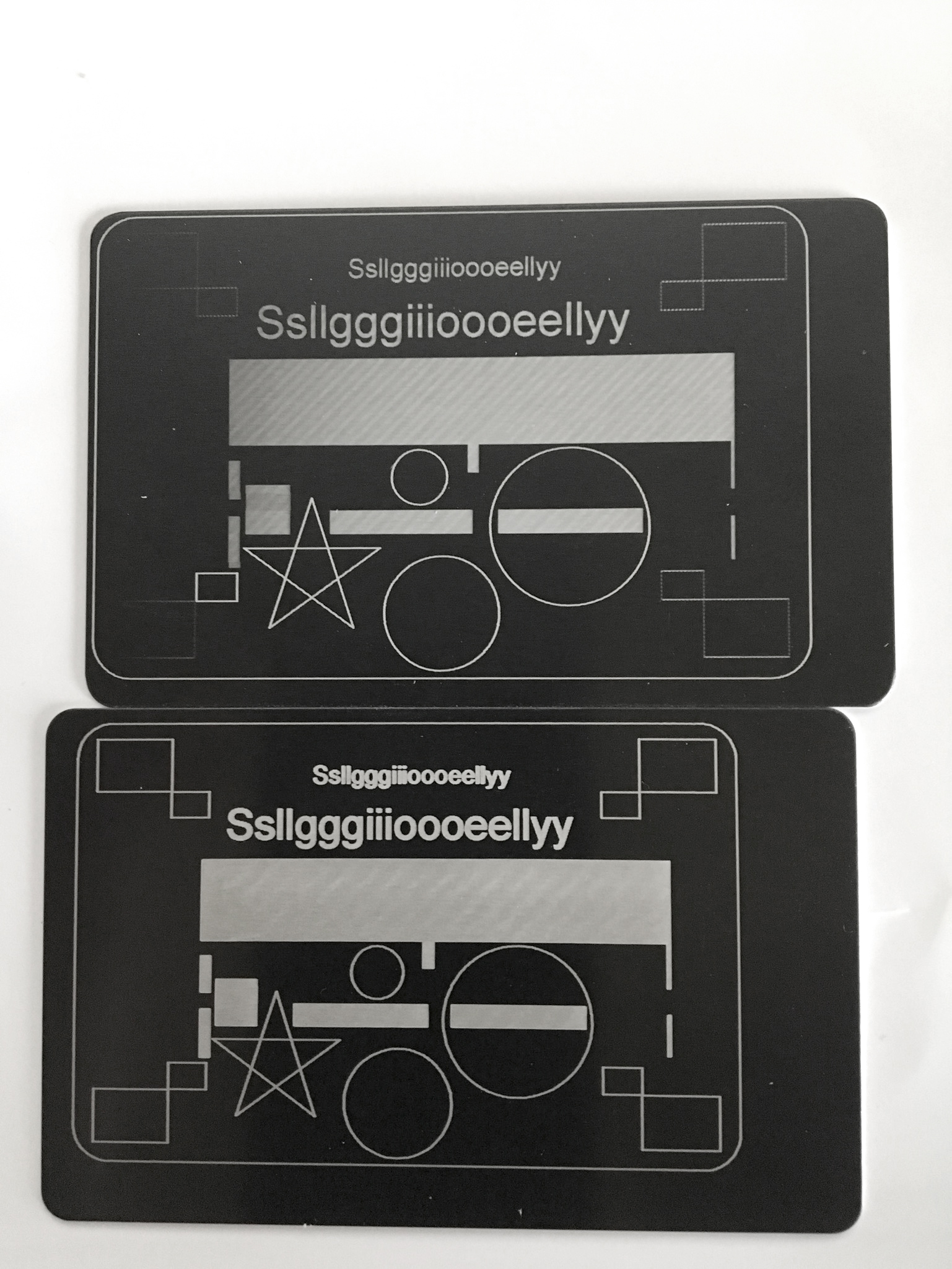

Versalaser 3.50 laser weak near margin
Hi just bought a 3.50 running the test file a have an strange result the engraving looks like it gets weak near the left side border
Looking for any inputs of what it can be
Martin
Re: Versalaser 3.50 laser weak near margin
could be the a difference in level/focus in that area
Thanks ! everything seems nice and leveled. Piece is flat. From what i read it can also be laser beam alignment i'll start with that :D
