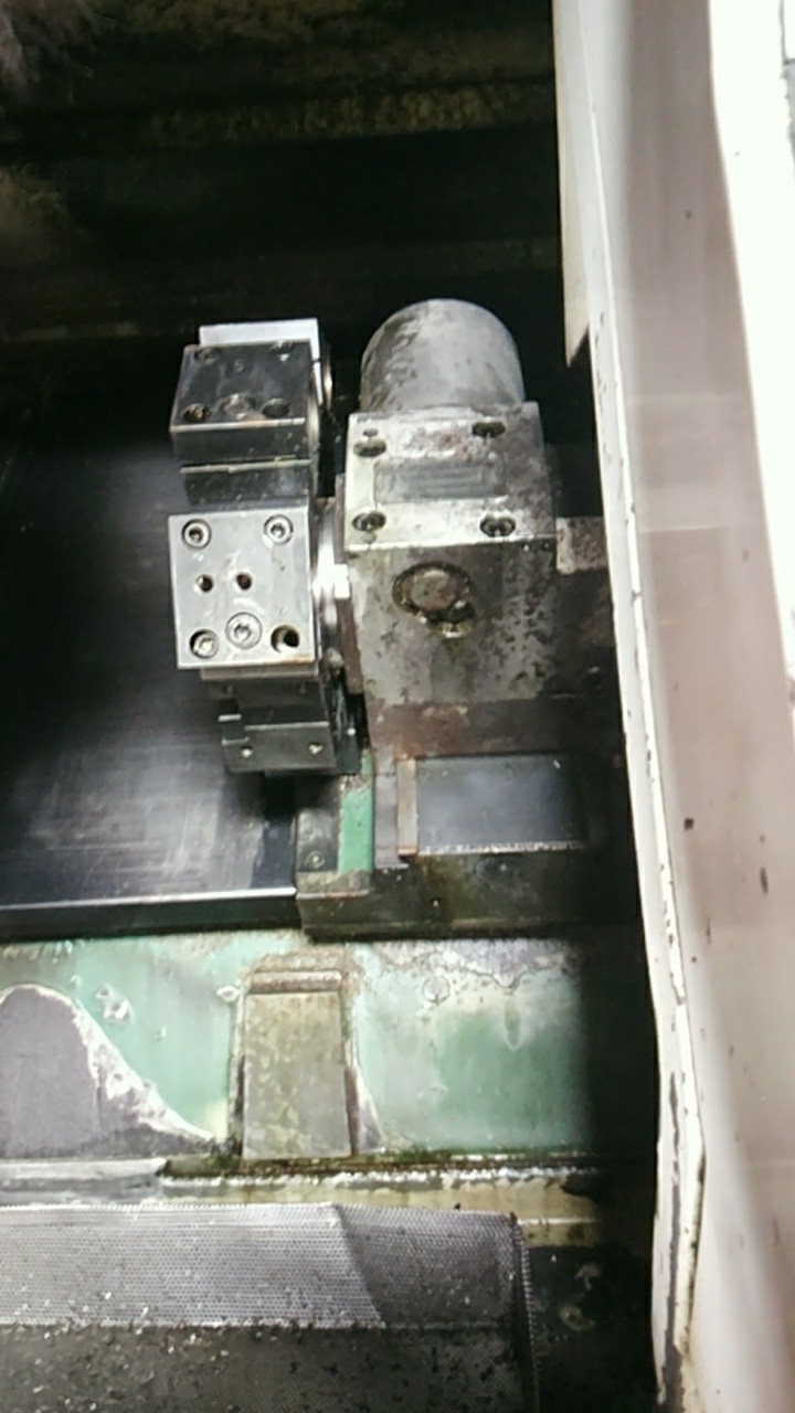

I am not sure which post I have - attached is a photo. I tried to do this on my phone but I couldn't do the attachement.
post
post

Regarding the Spindle 1008 error message that will quite possibly be a "peripheral" that is causing that, Fanuc does a sequential test of everything on the machine at start up and will show an error for the NEXT item on it`s list because it has found an issue and hasn`t been able to test the next item which in this case might well be the spindle drive, so it is unlikely to be the Spindle drive, first thing to look at is the Oil resevoir, I used to have a couple of Cyclone Lathes with Fanuc on them and that is a known cause of the spindle 1008 error, I had it a few times at start up when I forgot to fill the oil up :) :)
The turret issue I also had once and it turned out to be the Rotary switch behind the tool carrier, over time coolant gets into it and it gets "gummed up" for want of a better expression, a turret strip down and a good clean of the switch and everything in there should do the trick, a fair bit of work but not too hard or complicated as long as you lay everything out on a table in the order they come off should be OK to rebuild :) :)

After spotting a picture with a very similar turret to mine I believe I have a Baruffaldi RH80 turret, but not the 6 position like most, I think it's an 8
Anyone have a diagram of the internals on these? I need to get it apart or to try to get it to rotate! Thanks

I will post photos at some point, but for now I have managed to get the turret working!
Me and a friend removed the turret and tore it down.
Actually it is a surprisingly simple mechanism.
Turns out some of the pins in the connector were damaged, a wire had snapped inside the turret and the phases were in the wrong order.
resoldered the wires, pulled the pins and replaced, and switched the phases and it's all good now!
I still need to refit it and indicate it in properly, but its working spot on when its hooked up on the bench.
the steps to remove:
1) remove the 4 large allen head bolts - hold turret, its only held by bolts not pins
2) pull the turret face off the mechanism (5 bolts)
3) remove large circlip to access the wiring inside the unit (oposite side to the turret face)
4) inside the wiring is a 8 way position switch on 3 small bolts that can rotate a bit to align it - check wiring is all in place - I have 1 wire to resolder, and then another 2 when I was ham fisted and snapped two more wires!
5) motor is held on with 4 small but long allen head bolts, there is grease inside and a seal - stripped, cleaned and regreased
6) replace motor, replace 8 way switch (dont forget earth strap), replace plate and C clip, replace turret face, place turret on the lathe, replace 4 long bolts, indicate in
