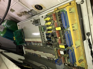

We used 2 different controls on the RH80 so a few pictures inside the electrical cabinet would be helpful.
On some we fitted a voltage sensing relay which measured the voltage from the thermistor inside the toolpost. It is plugged in to a relay base & should have a dial & red light on it. It may have come loose or just need adjusting if fitted,
Other than that it could be a broken wire.
Re: Cyclone Diagnostic Parameters
Pictures attached, hopefully you can see them!
Ok. You have a toolpost control board fitted. It's the board in the distance in picture "lathe 4.jpg".
There may be a fuse on the base card which you can check. Also check that the card is fully pushed in. We used to fit a couple of cable ties round both cards to stop them coming apart.
Are there any lights lit on the board?

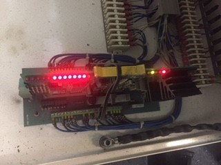

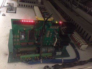

Pictures attached of lights...
lathe 6.jpg (20.56 KiB) Viewed 19387 times
lathe 5.jpg (21.09 KiB) Viewed 19387 times
Are any of the LED's labelled?
I can't locate any drawings or the manual for it.
Unfortunately no, they are not labelled? :( :?
