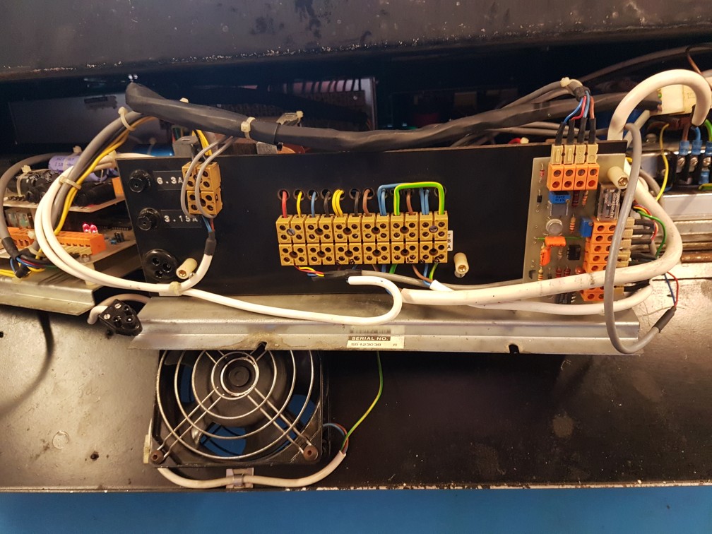

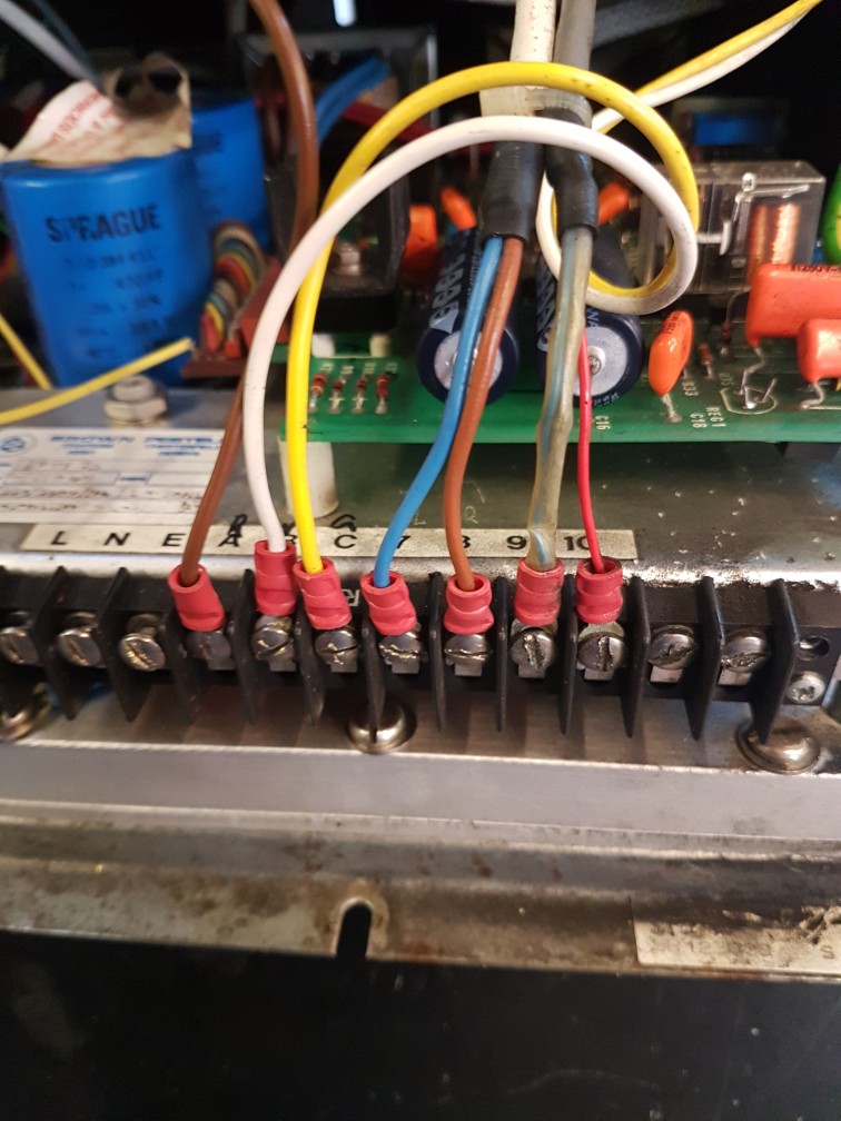

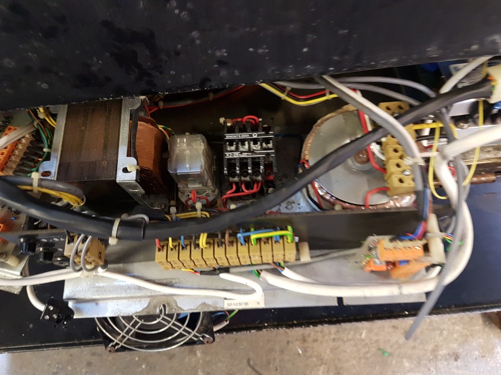

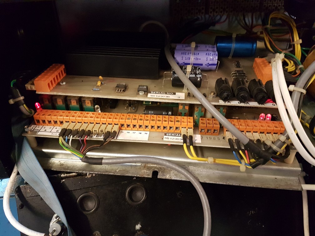

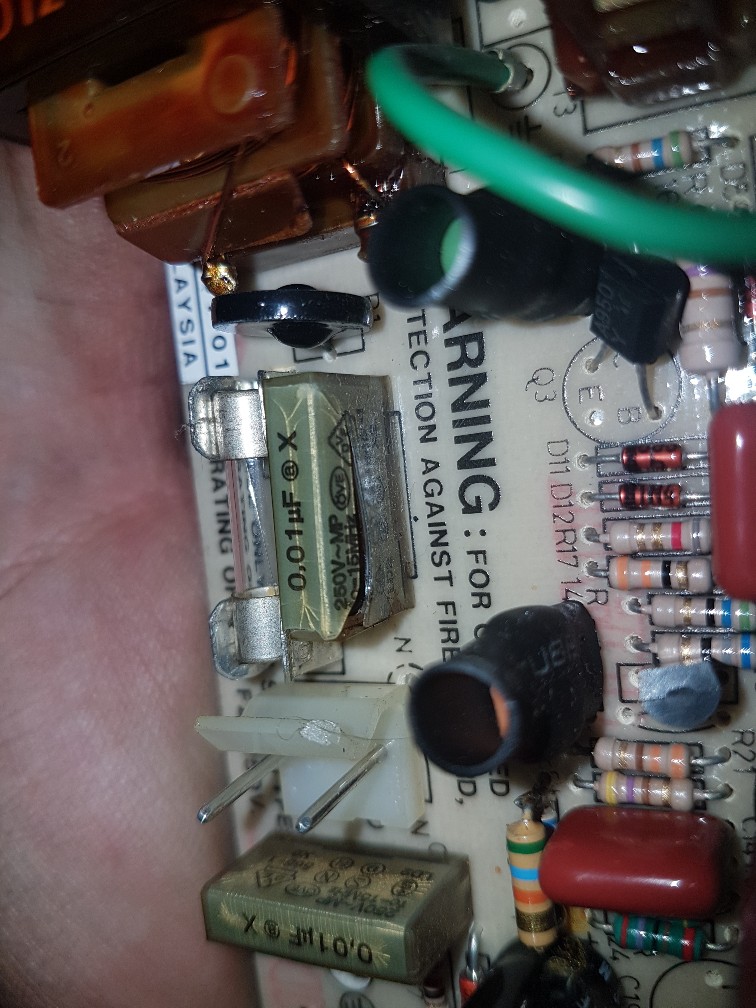

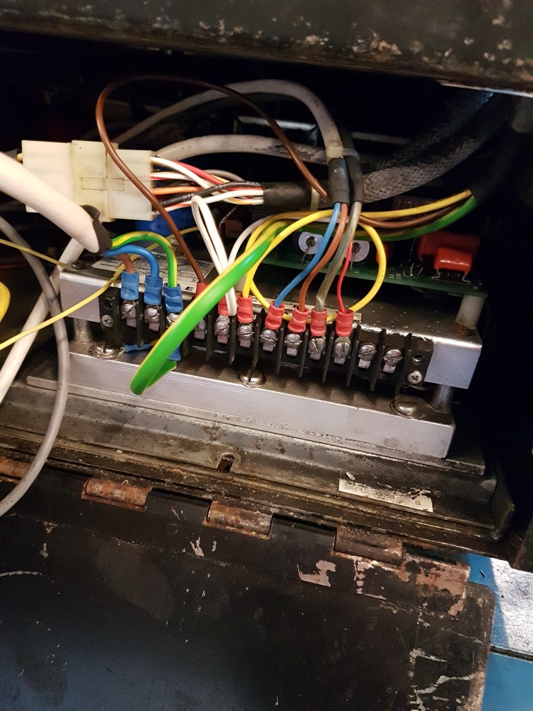

Photos attached
Re: Z and X and spindle all of a sudden not working
Power board repaired
