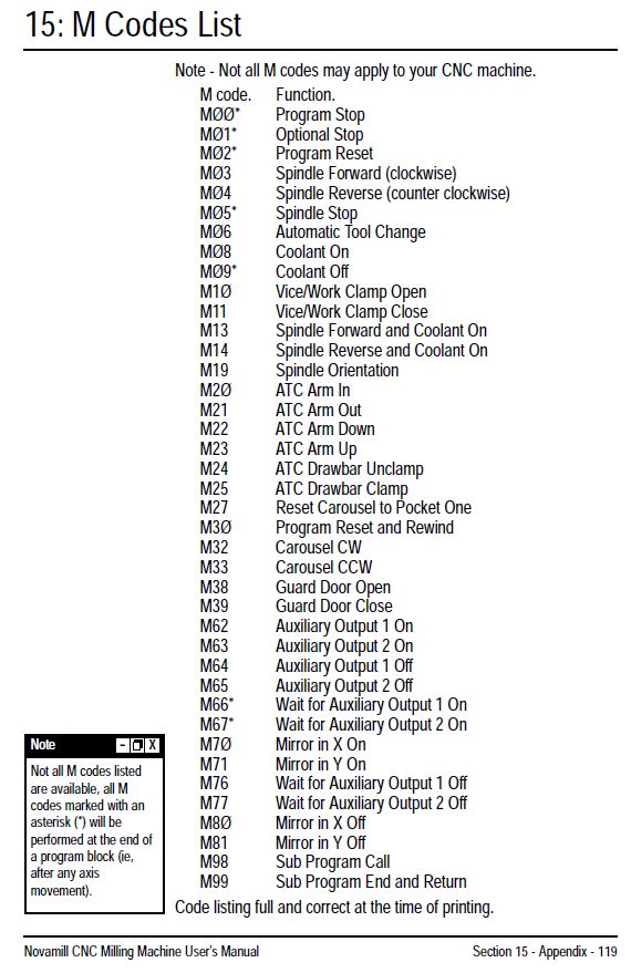

I was hoping to get the mill to wait for the indexer to declare its finished its move via an aux input, however the "Wait for..." m codes talk about Aux output On/Off (M66/M76) rather than inputs. Is this a typo, or am I missing something?

M62 Aux out 1 on
M64 Aux out 1 off
M66 Wait for Aux 1 input on
M76 Wait for Aux 1 input off
You may need to add the wiring for the Aux port.
