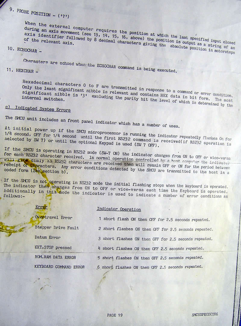

I've run out of (spare) time to upload any more pics, but the only instructions (I can see) about the switches say:
SW7 on is RS232 operation
SW7 off is optional keypad usage
The switches are also mentioned regarding HEXCHAR, and level of parity

Schematic of tool changer SMCU board
SMCU board PCB layout
SMCU board errors and some mention of the switch settings
