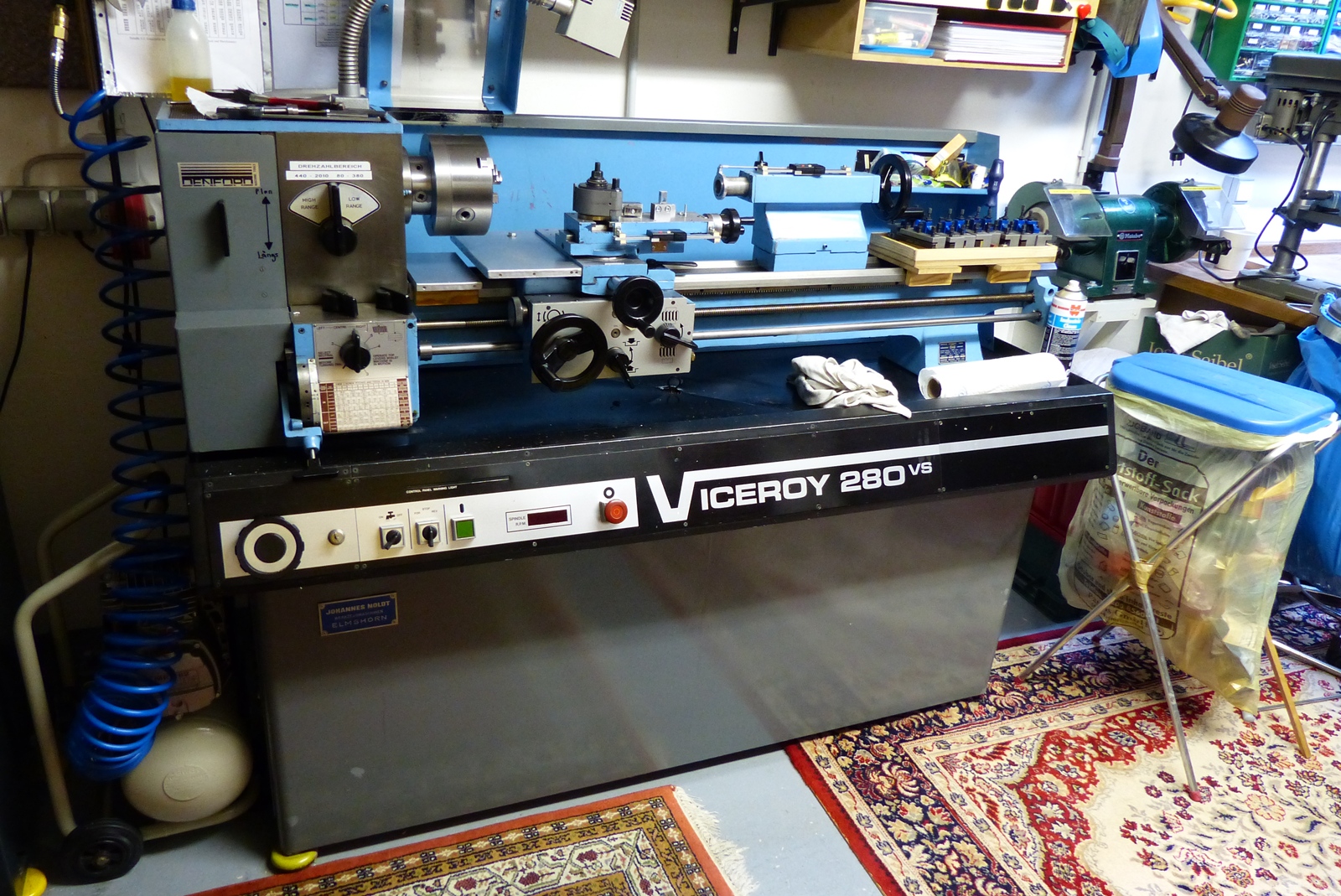

Hi Guys and fans of the vintage Viceroy 280 VS lathe.
I am new in this forum and a model engineer since many years. I am from Germany.
In 1984, I purchased a brand new metric Viceroy 280 Manual VS Lathe from a big tooling shop, the version with the down-drive block mounted in the cabinet and speed control by hand wheel and long bed of 1 meter.
Copy of the original brochure and probably actual picture attached.
I use it now since more than 30 years and it looks and works like new. Also, it is fitted with probably all available attachments incl. imperial transposing set.
Unfortunately the machine came from the factory with a wrong set of drawings. they are for a Viceroy 280 VS with Top-rive and Joy-stick. Also, the gear wheels for the imperial transposing setup came with the wrong drawing for the metric setup.
Also, the date of manufacture is not stated on the name plate. I guess around 1980/81 ?
The Serial Number is 24917, some drawings mention 1980 as the latest date.
As a general description:
The machine is a mix of imperial and metric thread screws, the leadscrew has 3mm pitch.
The variable pulley system for the drive is made by a german manufacturer ( Lenze GmbH ).
Spare pulleys and belts for that are available, but not identical parts, modifications in the lathe are required.
Drive belts and ball bearings etc are standard parts and all still available.
Now I am thinking about replacing the Crosslide and Compund Nuts, since I have a lot of backlash ( However this does not affect the precision ). The problem is to find replacement parts for that and the spindles are unusual ( 12,7 mm dia x 2,5 mm square thread with 10 deg. ) Spindles can be turned, but the nuts are the real problem.
Does anybody have a good idea where to find such parts?
Also, does anybody have the correct drawings for my machine ? Especially the Headstock arrangement, the down-drive motor block and the cabinet?
I have read all of the postings in the last years and many details of these Viceroy 280 VS lathes are already discussed in the forum.
However, if I can help out with additional information or drawings, I will do my best.

Welcome to the forum. If you can get answers to your questions, it will be here! Firstly I'm immensley impressed with the immaculate condition of your lathe, plus a carpeted floor in a workshop! They look like nice carpets too!
Now, have you looked on the www.lathes.co.uk website, in the Denford section. Theres a number of photos of your drive set up, and a little bit of description. You may find your lathe is a little older than you think, theres a photo of lathe number 30393 on there, with a date of April 1982, so I'm guessing yours is about 1977 or 78. I think 280s were made up to about 1984 or 85.
