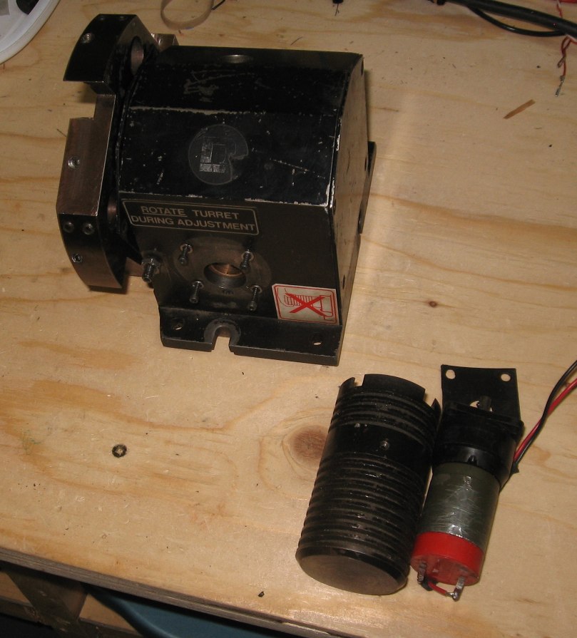

2- remove the motor + gearbox + heatsink (IIRC it can be removed as one piece); I don't recommend removing the motor from the heatsink unless necessary.
motor separated
motor separated

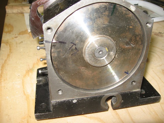

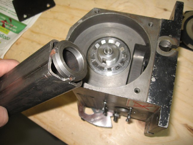

3- Open ATC rear panel; trace a witness mark on the ATC body and the index wheel. Remove index wheel (be careful with the shiny traces on the other side !)
index wheel
index wheel

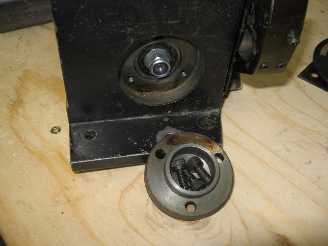

4- with custom wrench, remove locknut (unbending some lock washer tabs may be necessary)
lock nut
lock nut

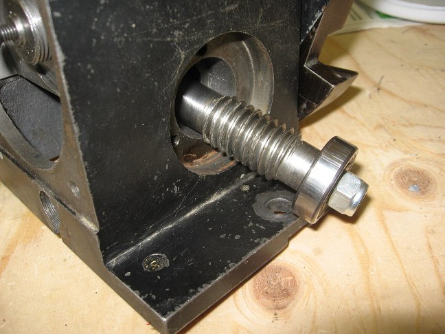

6- push out worm gear shaft; turning the tool holder face with one hand can be helpful
worm gear
worm gear

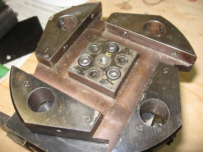

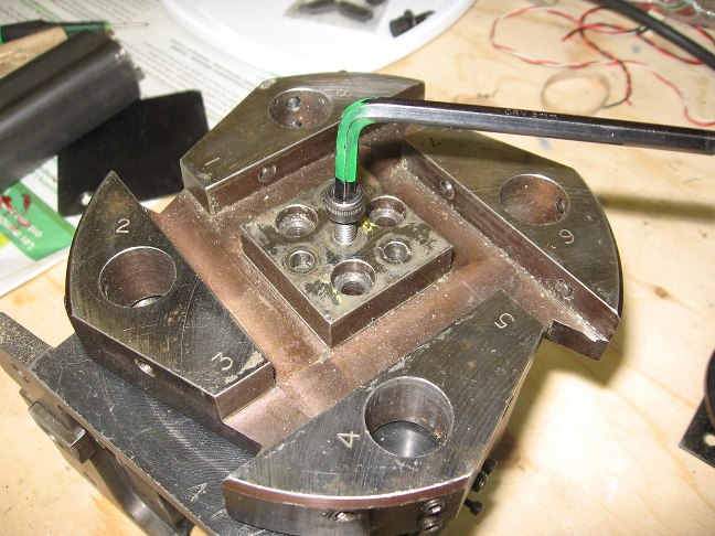

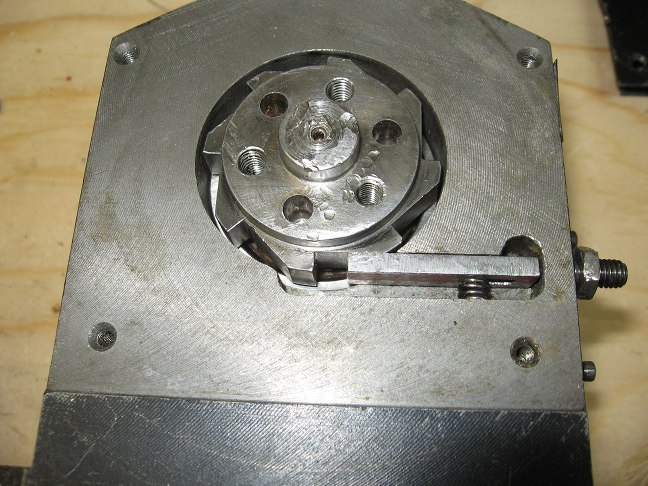

7- holder face : remove plastic caps if necessary; remove 3 bolts.
Note, the 3 other holes have dowel pins in them. On my ATC, two of the dowel pins had snapped flush at the holder face / ATC shaft mating interface. These pics were taken after the whole ordeal of welding a washer + nut, and pulling with a slide hammer / vise-grip combo.
holder face
holder face
8- take one of those bolts (or any M6 bolt) and thread into the middle hole. This should push out the holder face from the ATC shaft.
holder face 2
holder face 2

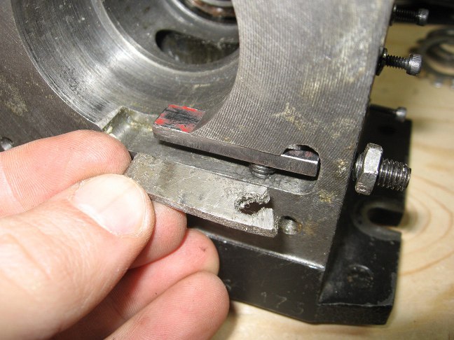

9- note the ratcheting mechanism. Very simple; almost effective, but not super repeatable and accurate. And hell to put back together after taking it apart.
The mangled face of the ATC shaft is due to an angry afternoon of failed attempts at removing the snapped dowel pins.
ratchet
ratchet

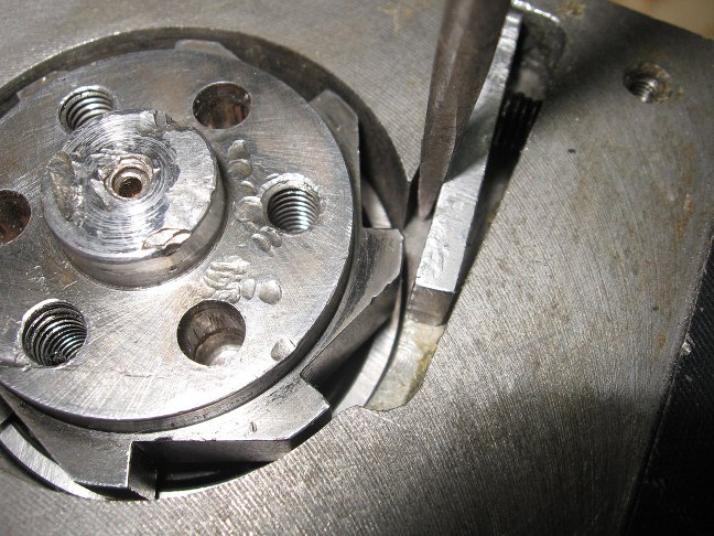

10A (preferred): unscrew ratchet ajuster fully out, and fit a random object (here a flat blade screwdriver) to ensure the pawl clears the bearing outer race, otherwise it's going to be very difficult to push the shaft out. I know, I tried !
pry ratchet
pry ratchet
10B (alternate) : remove ratchet spring guide screw, convince the pawl to exit its groove without throwing the spring into orbit (or into an eye). Good luck putting it back together !

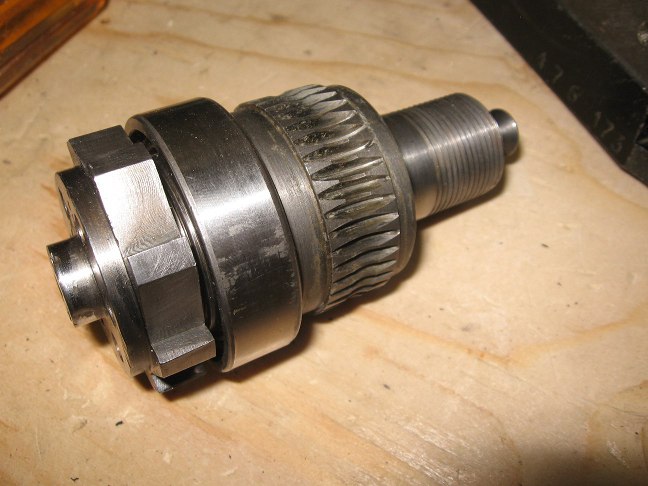

11 with the ratchet pawl taken care of (either out of the way (10A), or removed (10B)) : push out the ATC shaft from the back. A bit of persuasion may be required; a small hammer and a piece of wood used as a drift punch works fine.
shaft assy
shaft assy

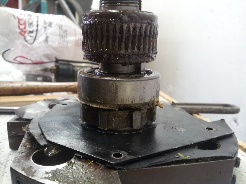

12 tadaaa. Actually I cheated; the ATC shaft assembly really looked like this on mine !
dirty shaft
dirty shaft
Here's the original ratchet pawl. This was causing massive issues - shitty repeatability, impossible height adjustment, etc. Also I noticed that every ratchet tooth face is worn slightly differently. I'm not sure what I'm going to do to fix this...
ratchet pawls
ratchet pawls

You're welcome - glad it could be useful to at least someone. As for reassembly / adjustments, I'm not sure when,how, and if that's even going to happen. As I mentioned, the ratchet stops are worn unevenly, which means that no matter how I adjust it, each tool position will have a slightly different height above centerline...
Also, and more importantly, the motor itself is mostly useless now -- the flimsy brushes held in place by the cheap plastic endcap were sometimes not making contact, which ruined a few parts and carbide inserts too many. And repairing that part of the motor proved to be just about impossible. I was quite unimpressed by the build quality of this swiss-made Maxon motor... and it must not have been cheap, either.

Have you thought about either filing/machining the ratchet to the same lower level or building it up with weld and machining back to correct height?
