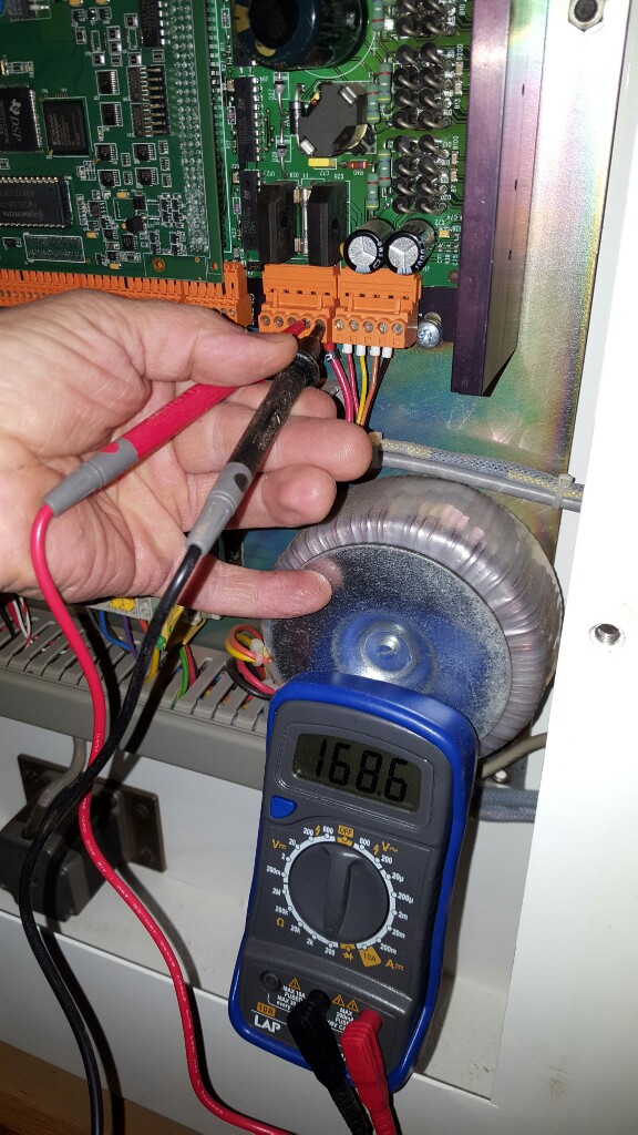

Hi Martin. Thanks for getting back to me so quickly. I have no background in electronics so please bear with me!
I found TB11 and the 24v pins, attached a multimeter and got a resistance reading of 168.6 (see pic)
I have not got a clue if I'm reading it correctly or if it's good or bad. I'm hoping you might walk me through it in baby steps. Many thanks in advance.
Re: No Power to Control Board
Martin asked you to check the voltage on those pins not the resistance. turn the dial on your meter to 200v~.
It isn't wise to connect a meter on the resistance setting to a powered circuit.
Thanks Pete. You're right. I was sure to isolate the machine.
I've rechecked and, with the meter set at 200v~, I get no reading. Zero, zip, Nada, 0.0.
What's my next move? I really hope the board isn't finished. They've stopped making them haven't they?
Thanks again,
