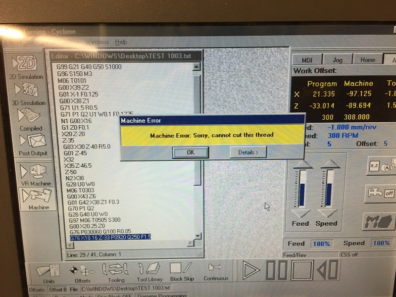

Hello
When I try program 300 rpm the machine stop and i get messege on screen.
I copied the program(g-code) from the user manual for denford starturn pc
And alsow I make short video : https://youtu.be/Wbb0pxW9i5Q
2017-05-20 09.49.37.jpg (227.04 KiB) Viewed 20419 times

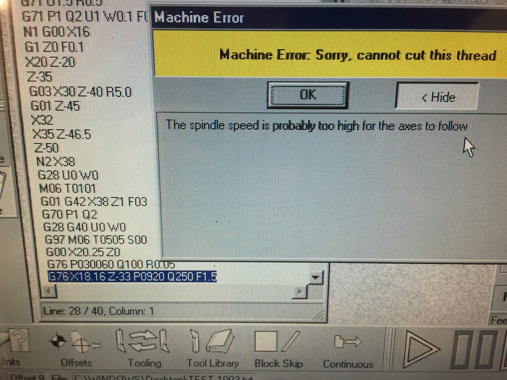

Re: Denford cyclone TU150E Threading problem
What does it say when you click on the details tab.
I will upload th threading program Monday for you to try.
May be the program is the problem.
Steve wrote:What does it say when you click on the details tab.
Hello Steve
When I click on the details tab it does say "The spindle speed is probably too high for the axes to follow"
I will be very grateful if you check this program on your machine. Regards
Hi Dont know if you got this sorted but would say that you have G96 instead of G97
Phil
