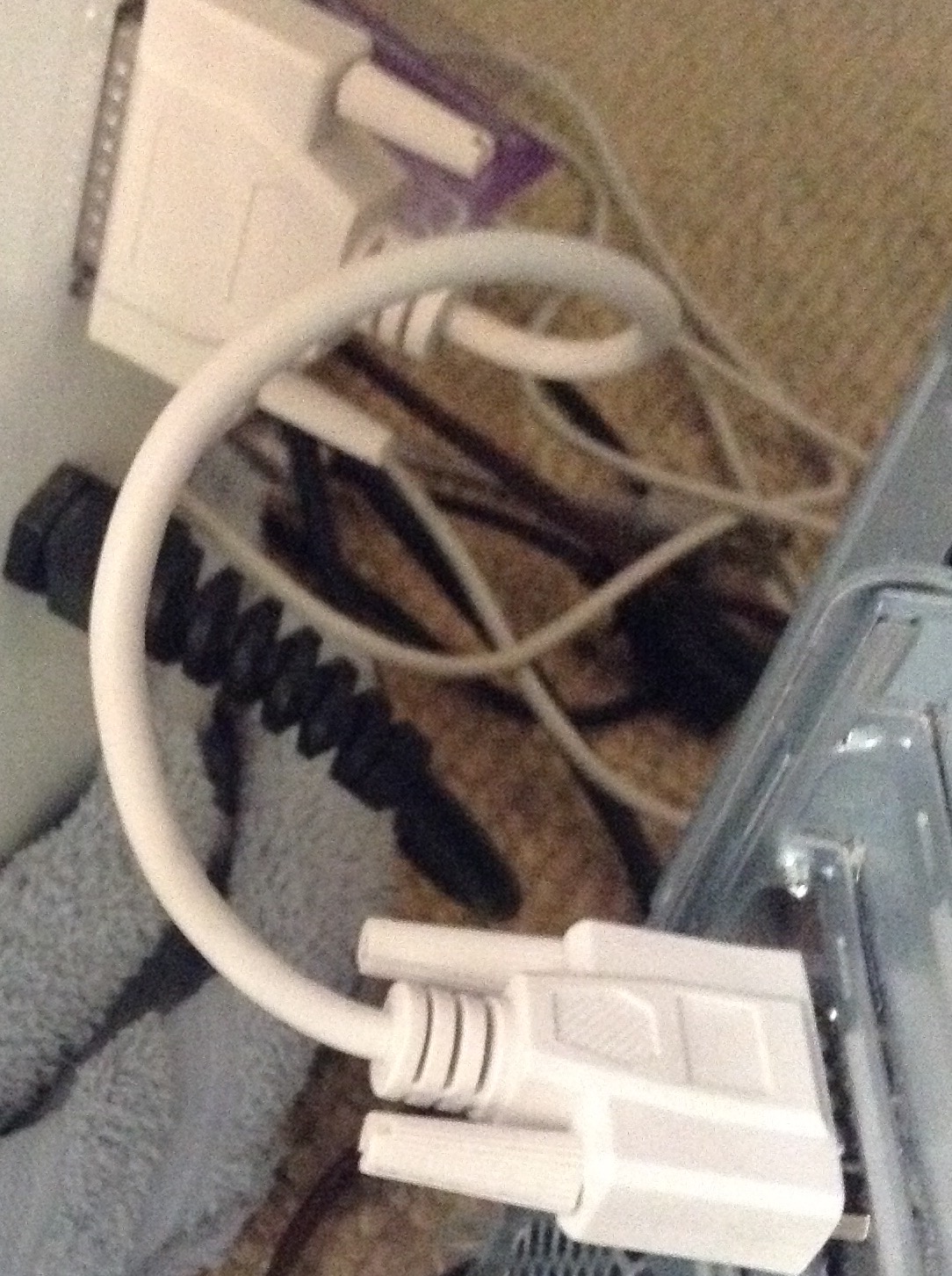

I got a db9 rs232 board for my computer now I have a com1 and com2 port.
I am using a db9 to db25 adaptor cable.

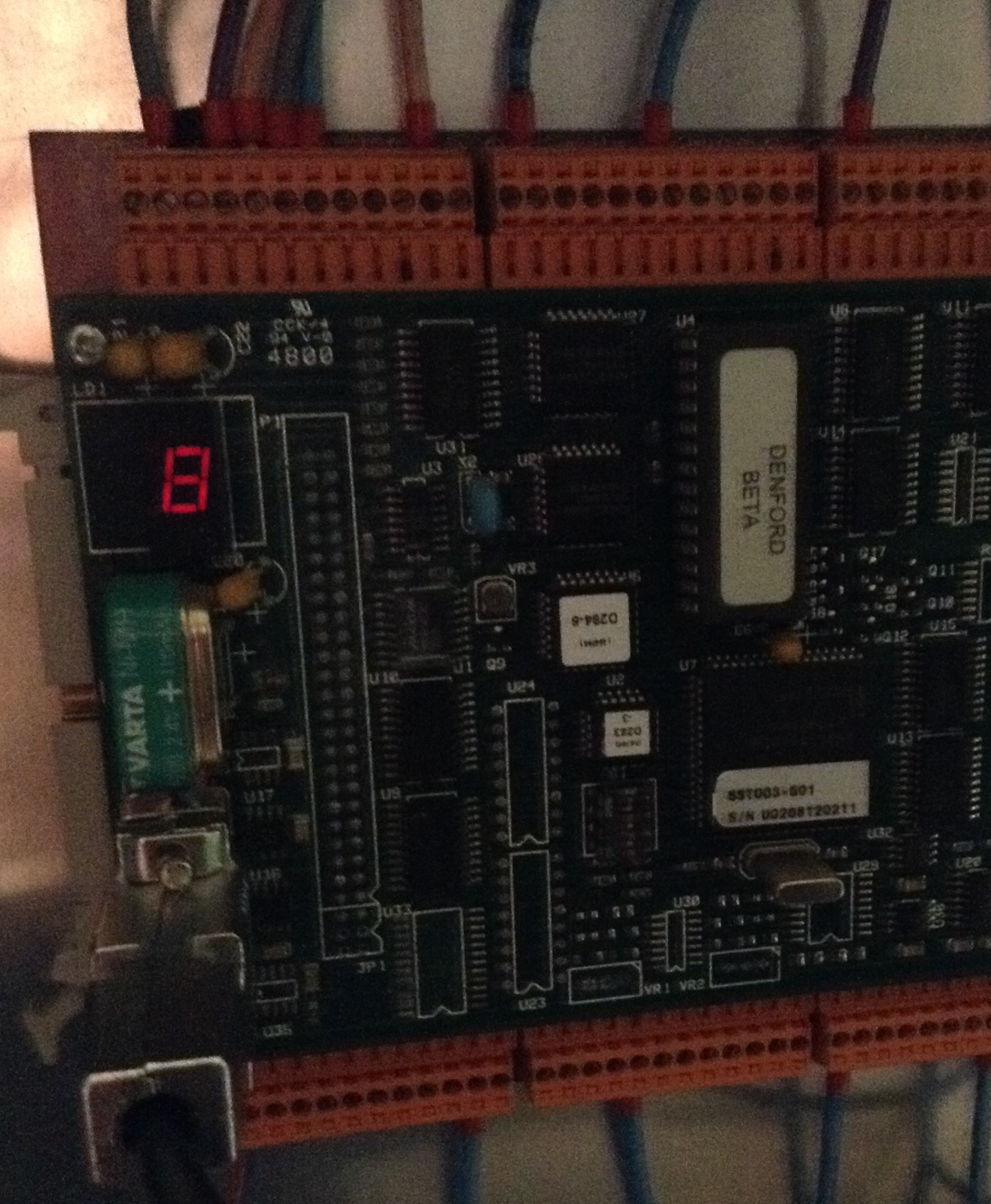

When I first started trying to connect my denstep board had an upside down 7 and a . Now it has changed to an 8 - I hope this means I connected to something.

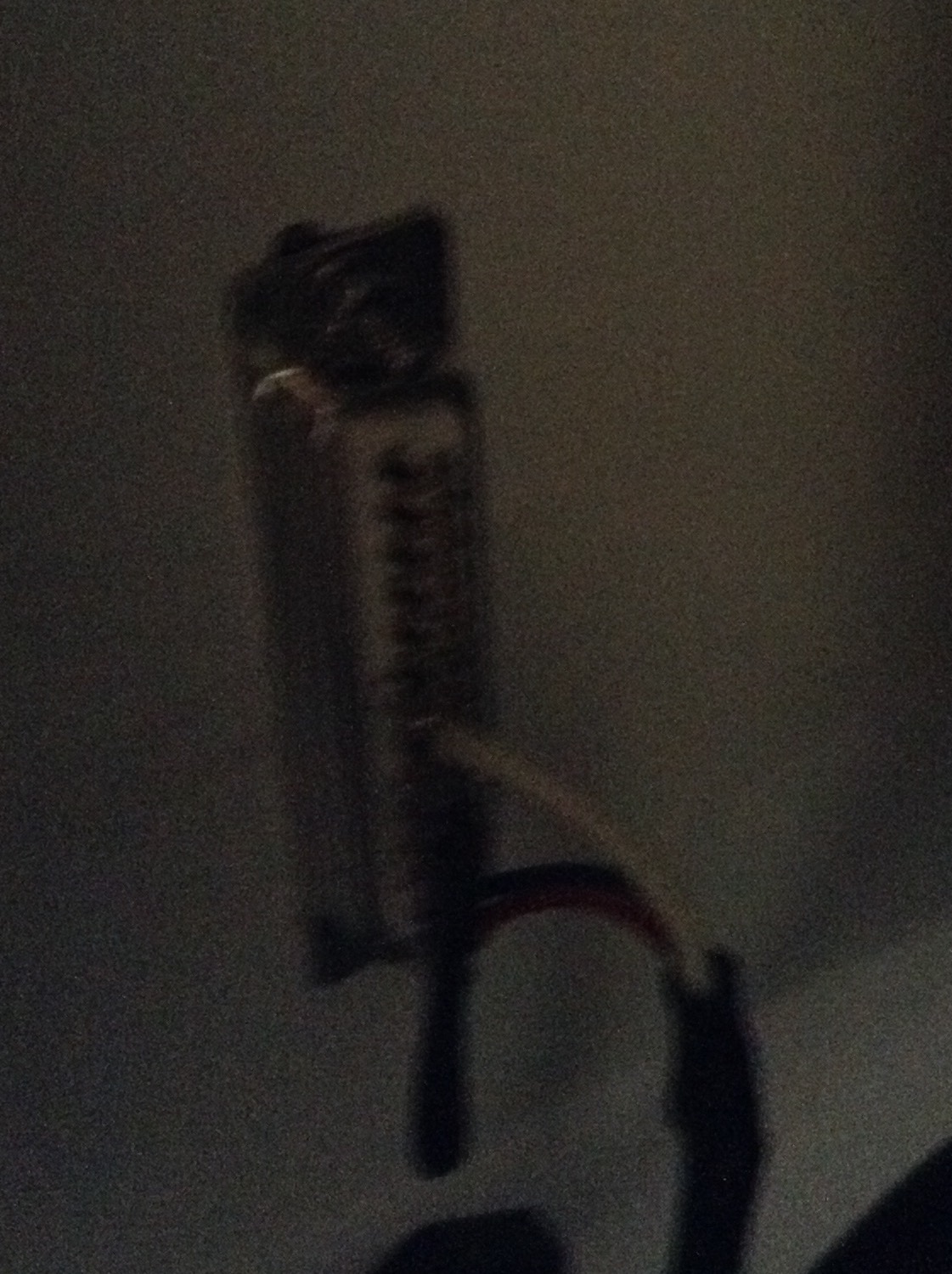

Here are some pictures
Cable to computer
Cable to computer
Db25 backside in the mill
Denstep board
Denstep board
Re: Connecting to denstep micromill
You should be able to right click on the machine icon in VRMilling & then select search for machine.
Can you also confirm what version of VRMilling you are running.
