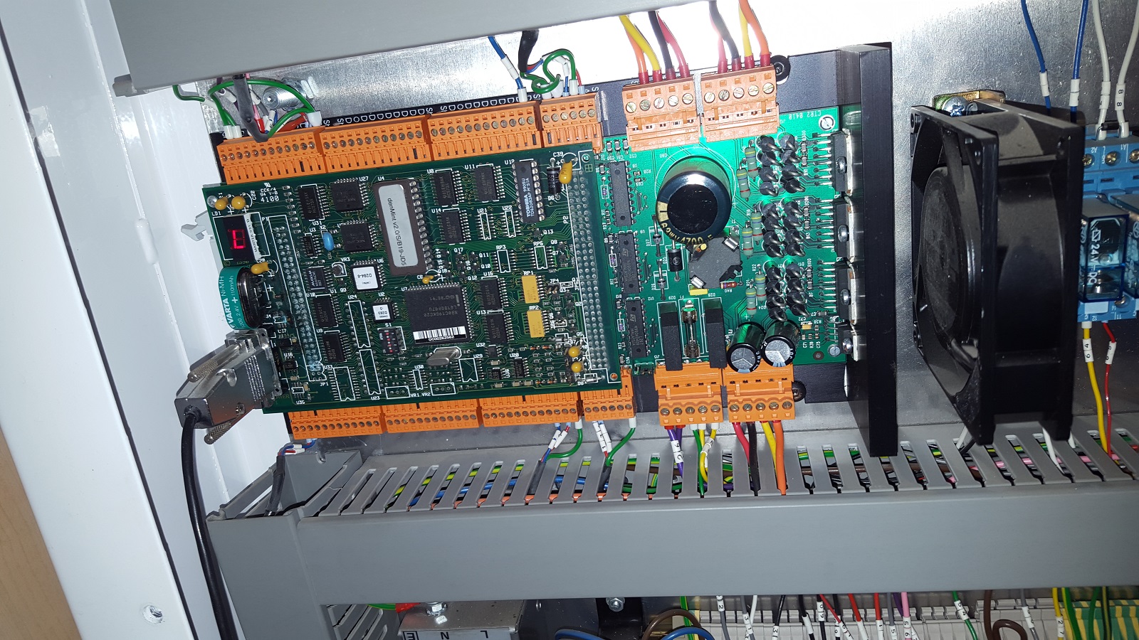

Thank you so much for getting back to me. This is the card that I have, and its showing .L
The issue is weird and the unit will usually start up, but right now it can take a very long time, and may not start at all.
There seems some muck around where the battery is, I am not sure what the function of the battery is?
Really appreciate you getting back to me. I have a project I am working on now, and its really causing me some problems.
David.
Image of the card. it is actually showing &quot;.L&quot;<br /><br />The problem is intermittent and it does usually come on eventually...
Image of the card. it is actually showing ".L"

Ok, It is a full Denstep board.
If the power to the drives is present then it must be an issue with the board. You could try tapping it when it should be on with the back of a screwdriver to see if it is a dry joint otherwise you may need to have it looked at.

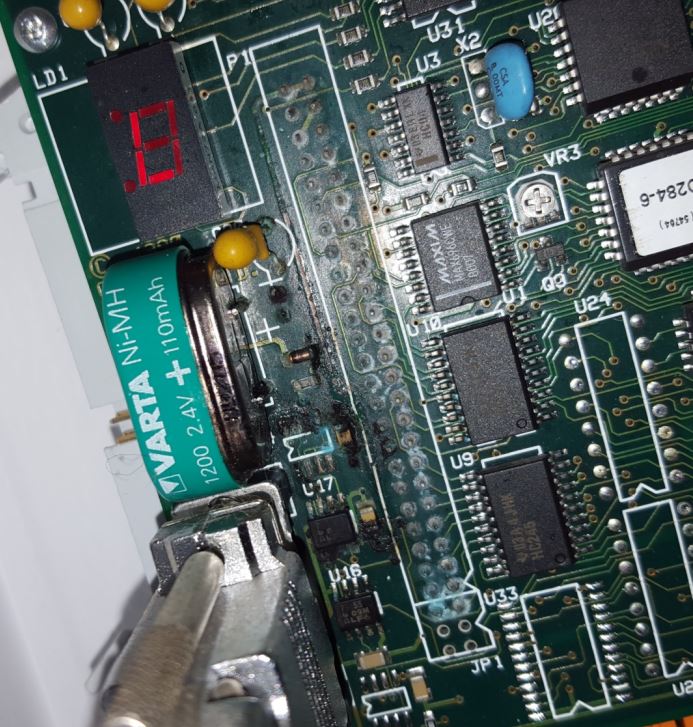

So, I tried attacking with a plastic screw drive, and manipulating a bit, then I tried heating with a hairdryer... Neither got the mill started last night.
I was about to pack up, when I heard the famous click and it wirred in to action. I was able to get some of parts made last night so that was good but doesnt help me make this reliable!! :) :) :)
I show a close up of around the battery, and also the back of the connections to the base board... Its seems to me both look corroded... Not sure why at the board end... Different solder?
Anyway, would really welcome your thoughts, and also your thoughts on what is the best way forwards? A repair, A second hand board? A different board all together?
If I can get this working reliably it will be fantastic.
Image near battery and also pins soldered on the right hand of the board to connect to the back board.
Close up near battery

It does look bad around the battery area.

Looking at that I would guess the battery has had a leak as it would appear that there could be corrosion It's that or it could be some form of water/moisture/condensation damage. They used to use those batteries in PC's 'back in the day' before moving onto coin cells. You could try some IPA (not beer) Isopropanol Alcohol and an old tooth brush to clean it up. It's what we did on PC's and Carphones (showing age) which showed these signs.
I don't know if you can just replace the battery and if you did if any setting would need redoing.
I have had issues with some of the Micromills which were down to dry joints on the connectors. Quick to fix once found.

I would try replacing the battery and see if its any better.
follow the attached post and remove the top card
viewtopic.php?f=54&t=2562
The battery is available from RS Stock No.422-371 Brand Varta Mfr. Part No.5561560294
You may need to use workbench to set up the card again but it may be OK.

Have now recieved the replacement card. All looks well, but the battery seems to just have started to corrode. I have also noticed that the board does not seem to have any printed connecttions to the -ve side of the cell. I wonder, is it possible to cut and remove the battery terminals with no ill effects to the operations?
