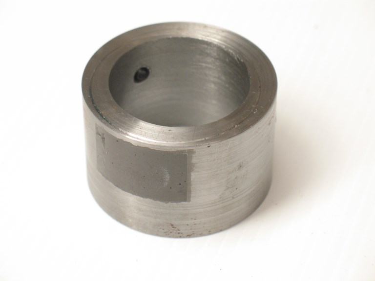

I was able to modify an existing bushing on the spindle to fit a trigger magnet. The bushing retains the rotating components on the spindle and is not loaded.

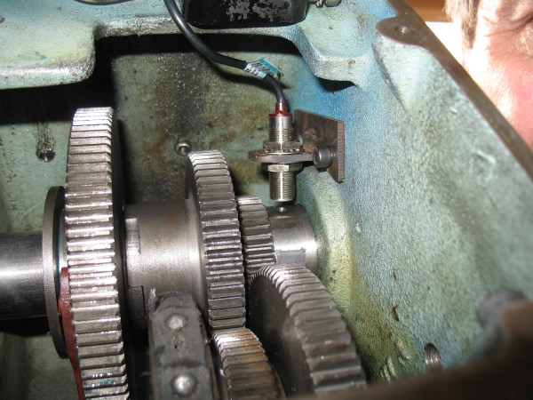

I was able to mount the sensor on a bracket within the headstock.
The existing bushing modified by potting a magnet in a milled slot.  A similar slot was milled on the other side to balance the bushing.

A heavy duty bracket to hold the sensor.
IMG_4621 (768 x 576).jpg (32.98 KiB) Viewed 22697 times
The sensor mounted inside the headstock.  It is bolted to holes drilled and threaded from outside the headstock.

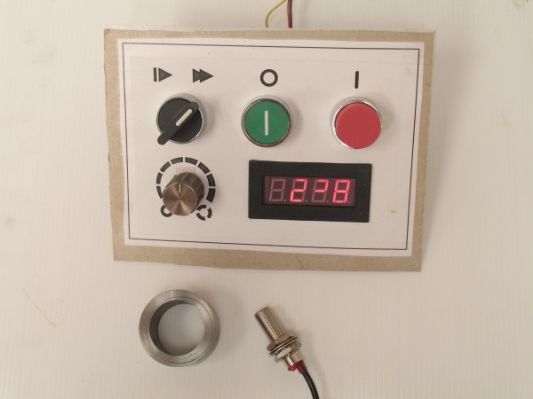

A paper/cardboard  mock up of the control panel with RPM meter to test ergonomics.

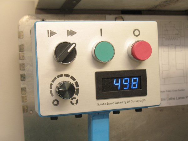

Here is the finished control panel.
