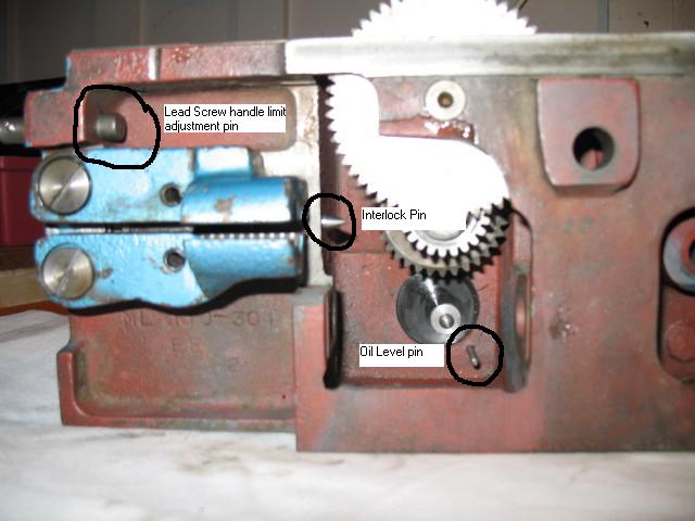

The interlock pin prevents the lead screw and feedshaft being engaged at the same time. The lead screw adjustment pin needs to be set in the correct position. The optional dial indicator is also mounted on the adjustment pin. When in the right position, the interlock pin can be fully retracted (moved to the left as shown in the photo) to allow the feedshaft handle to rotate and engage the feedshaft. It's important to know this when reassembling.

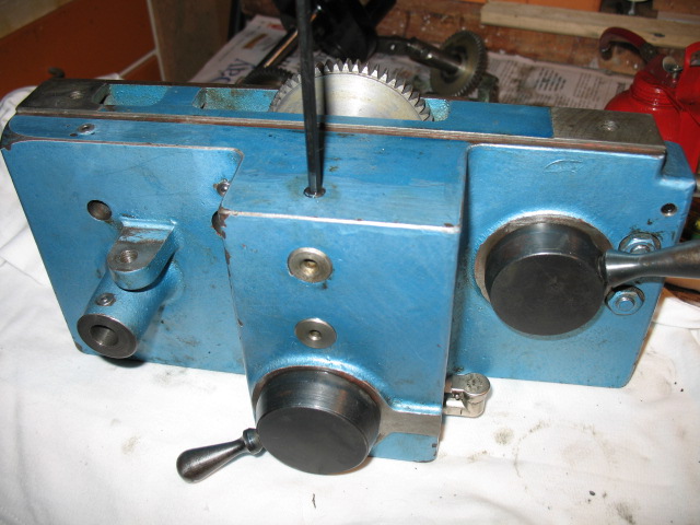

The assembled apron.  Note the allen key.  There are 4 set screws down that hole to locate the two shafts.  The shafts have oil holes drilled down the centre.
Details of the lead screw / feed shaft interlock.

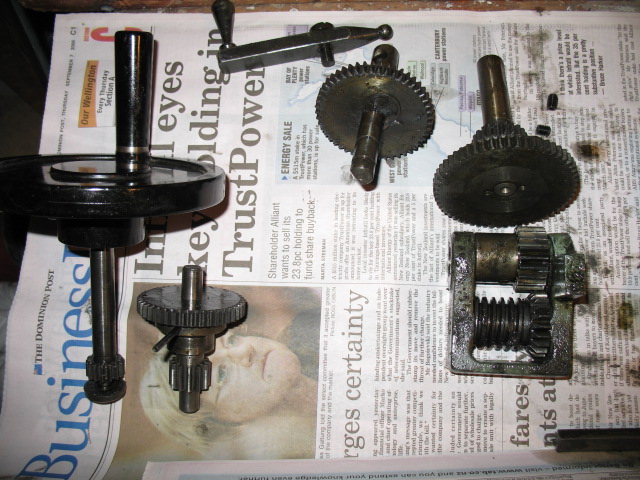

The apron fully stripped and cleaned.
27 years of crud, swarf and old oil.
2 of 2 photos showing parts of the apron  laid out before cleaning
1 of 2 photos showing parts of the apron  laid out before cleaning

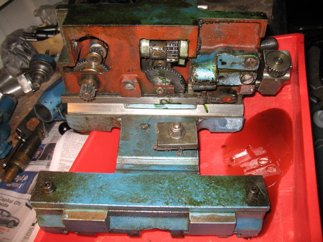

Just an extra shot of the apron. A apron is upside down and complete. This is what it looked like before stripping and cleaning.

The apron is definitely made to hold oil. The gears dip into the oil and carry it up into the apron.
There is a pin that indicates the correct level but the oil cup is set at a height that provides oil level. Just put oil into the cup until it nearly overflows.
