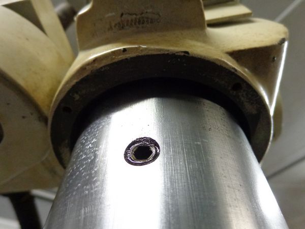

There seems to be a ring missing from the bottom of the quill. It appears that some kind of seal should be enclosed between the quill housing and the ring, perhaps an O’Ring.
If anyone is able to tell me more about this ring (size) purpose and if there needs to be a seal, I will add them to my Christmas list immediately.
Easimill Quill.JPG (33.07 KiB) Viewed 20752 times
