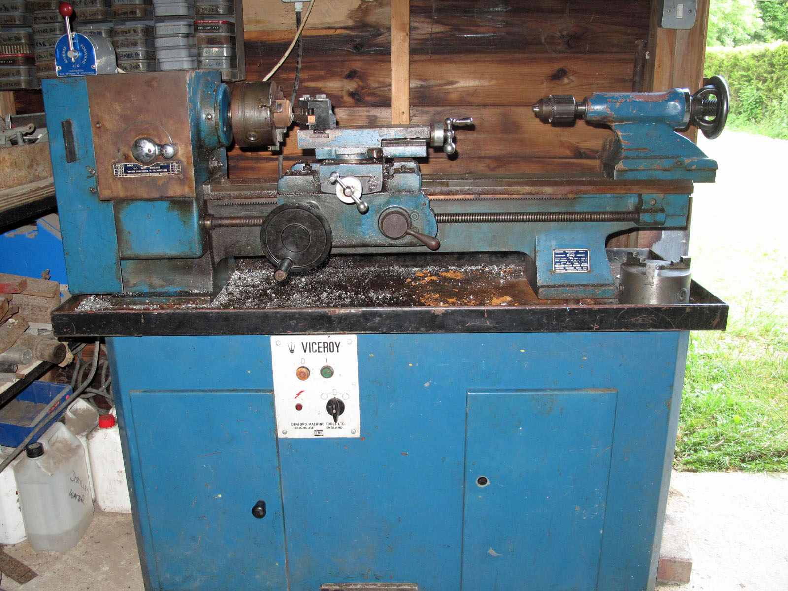

Hi, I'm a new member who's just bought a Viceroy Denford lathe, it's a bit old and I intend to spend a bit of time and money to improve it's condition. What I would like to know is what model it is so I can look for spares and such. Any advice would be appreciated.
Regards daver

Welcome to the forum.
Looks like you have a Mk2 TDS variant.
Take a look at lathes.co.uk for some info.
Spares are very rare for these machines.
Your lathe would be a good candidate for a CNC retrofit because it doesn't have a gearbox and other features that would not be needed.

Hi Daver,
Your lathe is a TDS1 LS - 'LS' meaning leadscrew.
