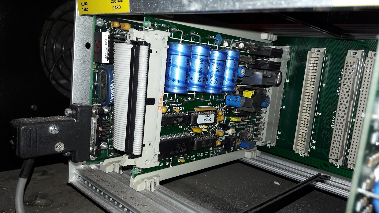

The real issue I face is that the machine has a dos computer and is running Denford Fanuc milling 2.98. I checked the card and it’s a red led model with a v1.6i eprom, mint 3.28. My main question is can I upgrade the eprom to get vr5 to work with this machine?
I have 3 cards which I have removed from a microrouter, a novamill and a microrouter compact. One I believe is a green segment the others are red. Im sure they all have a 2.1 eprom fitted. I have the vr milling 5 software which came with my router and to keep the atc working I would like to use it.
I assume I cant use the newer card with the machine but can I change the chip?? If its possible is it complicated to do or is it a matter of swapping them out?

I presume your Triac will have a rack mounted control card which is different to top card fitted to the 3 standard machines as listed.
You can fit the V2.1 Eprom to the Denstep Rack Card (It just plugs in) & use VR Milling. It should work fine on version 5. The only issue is if has the override pots fitted we have to wire the feeds to the 12 volt supply to get the full movement. It's not that hard to reconfigure though.
Make sure you go in to legacy machines when you select the machine type in VR Milling version 5.

Hi folks,
I require a bit more help. I have swapped out the eprom but I only get a .L flashing on the eurocard. Not sure if this is an issue with the eprom or not. The other two boards I have don't have v2.1 eprom, they are green segment boards. Would the eprom from one of those work or is there a way to tell what is going wrong?

Re: 1997 Triac VMC 240V DOS to vr milling 5
The .L flashing just means you are not connected to the software. Have you tried to communicate with it?
Tried various times to get it working with the pc direct to the card (bypassing the dos pc inside the cabinet. i am using a denford cable with the plastic silver ends. it cant pick it up in mintman, or vr no matter what machine i try. it may be a coincidence but i am sure the top card the eprom came from had some connection issues. that may have been related to the top card as from reading on the forum the board wouldn't give an L if the eprom wasnt working?
