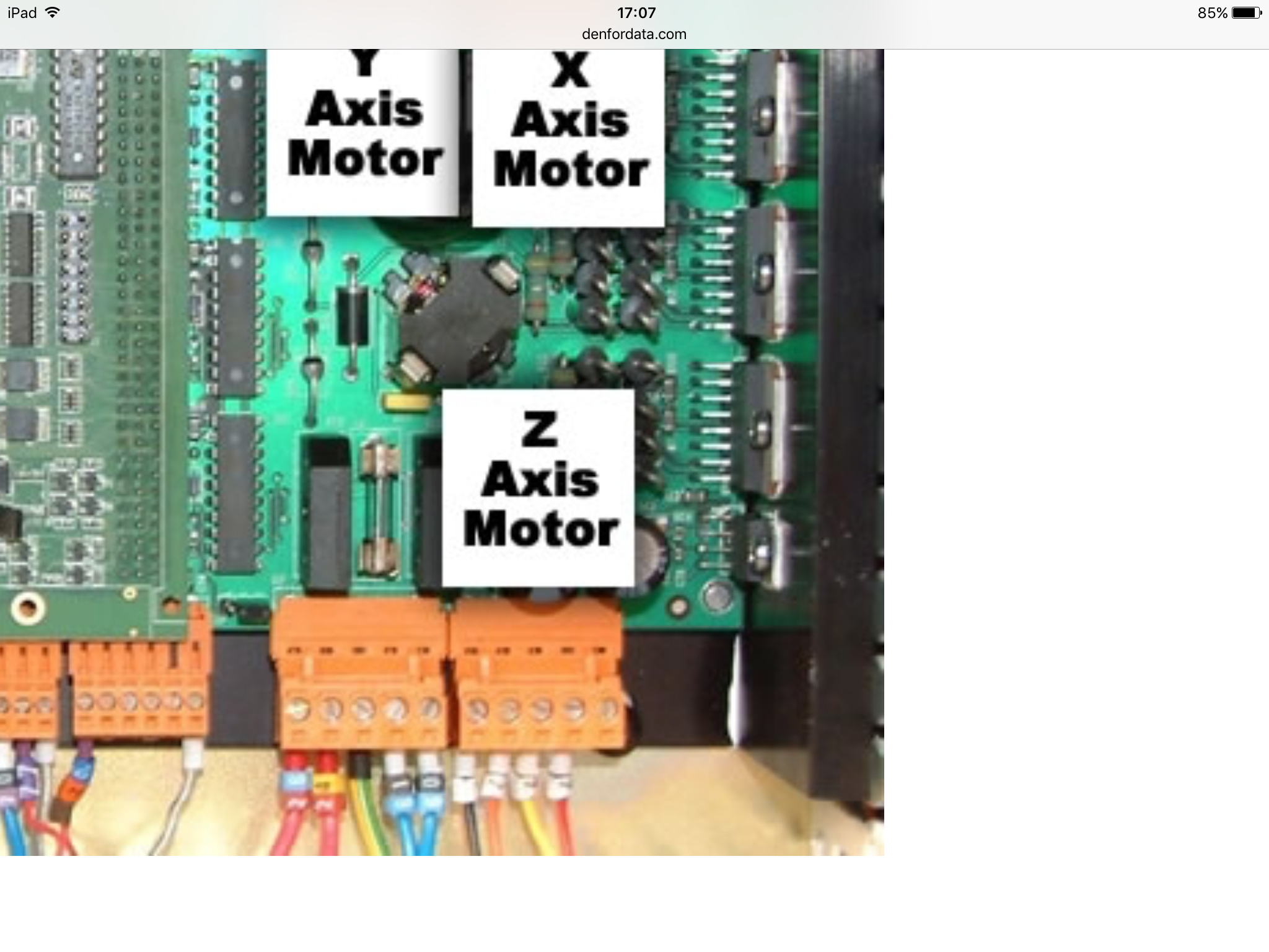

Re: Baldor F391 Series 1 - Odd Failure
The regulator is shown in the bottom right hand corner of the photo below.
That is the one - do you know the make and model of the chip and where I can maybe order one?
Thank you,
Scott
Not sure of the part but I think it supplies 12v and 5V
Is the chip not identified normally the part number is printed on them.
