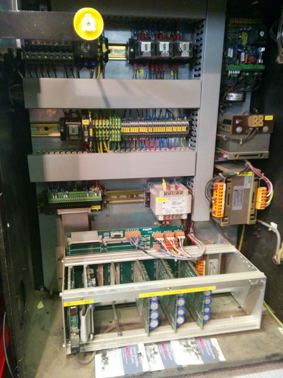

Hi Dan, Can you check what Eprom is fitted to the control card or is it a NextStep card? You would need a V2.1 or DENFORD BETA.
Re: Arc Problem
Hi Martin,
I'm new to Denford machines. I believe it's a next step card. How can I verify?
Re: Arc Problem
If the seven segment LED on the control card is red then it is a SmartStep/DenStep.
Re: Arc Problem
My machine looks like it uses a rack type card. Denstep?
Is this upgradeable?
Re: Arc Problem
I presume the seven segment LED is red?
Can you see what Eprom version is fitted?
Re: Arc Problem
Hi Martin,
I will have a look later and post some photos. How can I check the eeprom?
Thanks,
Dan
Re: Arc Problem
If you look down the side of the card you should be able to see the Eprom & version number.
Re: Arc Problem
Had a quick look at the machine and it seems the eeprom is v2.1
Re: Arc Problem
It is a DenStep with the latest eprom fitted.
There is an upgrade available to a USB NextMove card & VRMilling version 5 software. It would be a UGR0007.
