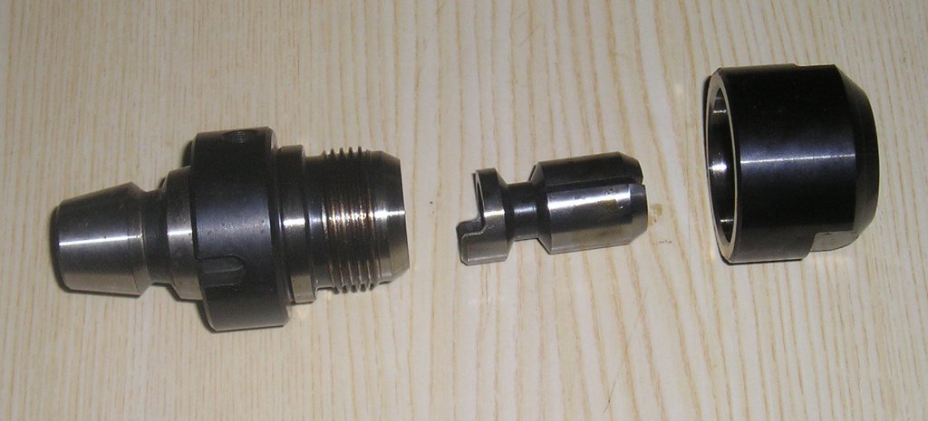

Ben,
Coventry Engineering make or made a posilock chuck for the Easy Change system but I couldn't see it mentioned on their website. See comments here viewtopic.php?f=47&t=3911 and the attached picture is a shot of one of mine.

Thanks David, after reading you post I searched for some time last night but didnt find anything at all, I think maybe they have gone in favor of the ER collet system. Ive now got myself a couple of Da200 collets 6 and 3mm so i'll be giving the machine a test run tomorrow, excited I have to say!
once ive got over the initial sting of the purchase, i'll invest in a few chucks that will suit the tooling i'll be using, perhaps I'll be able to sell off some the imperial holders on ebay to offset the cost you never know. we shall see.
