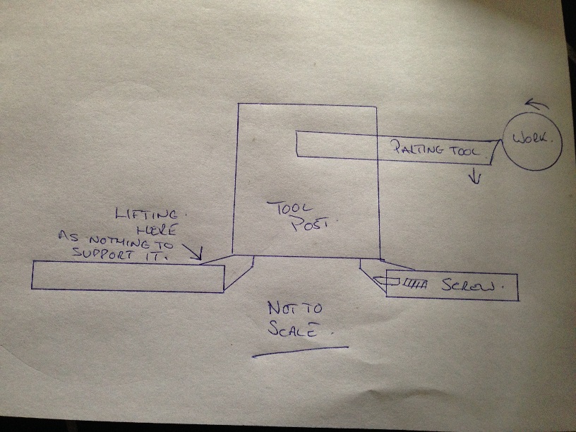

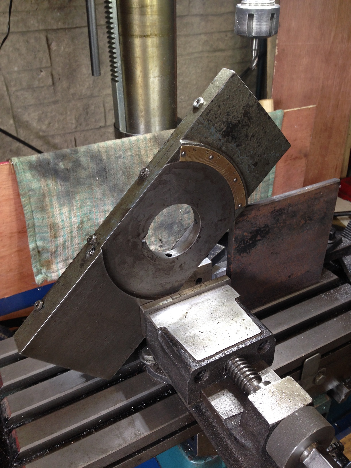

I had always thought the cross slide locking screw at the rear on my model were a pain to get at so set it up in mill and drill some new holes at the front, was making a tapping tool to day needed to part off some stainless steel and it worked like a charm :lolol: so i recon the cross slide was tipping at the back due to no support.

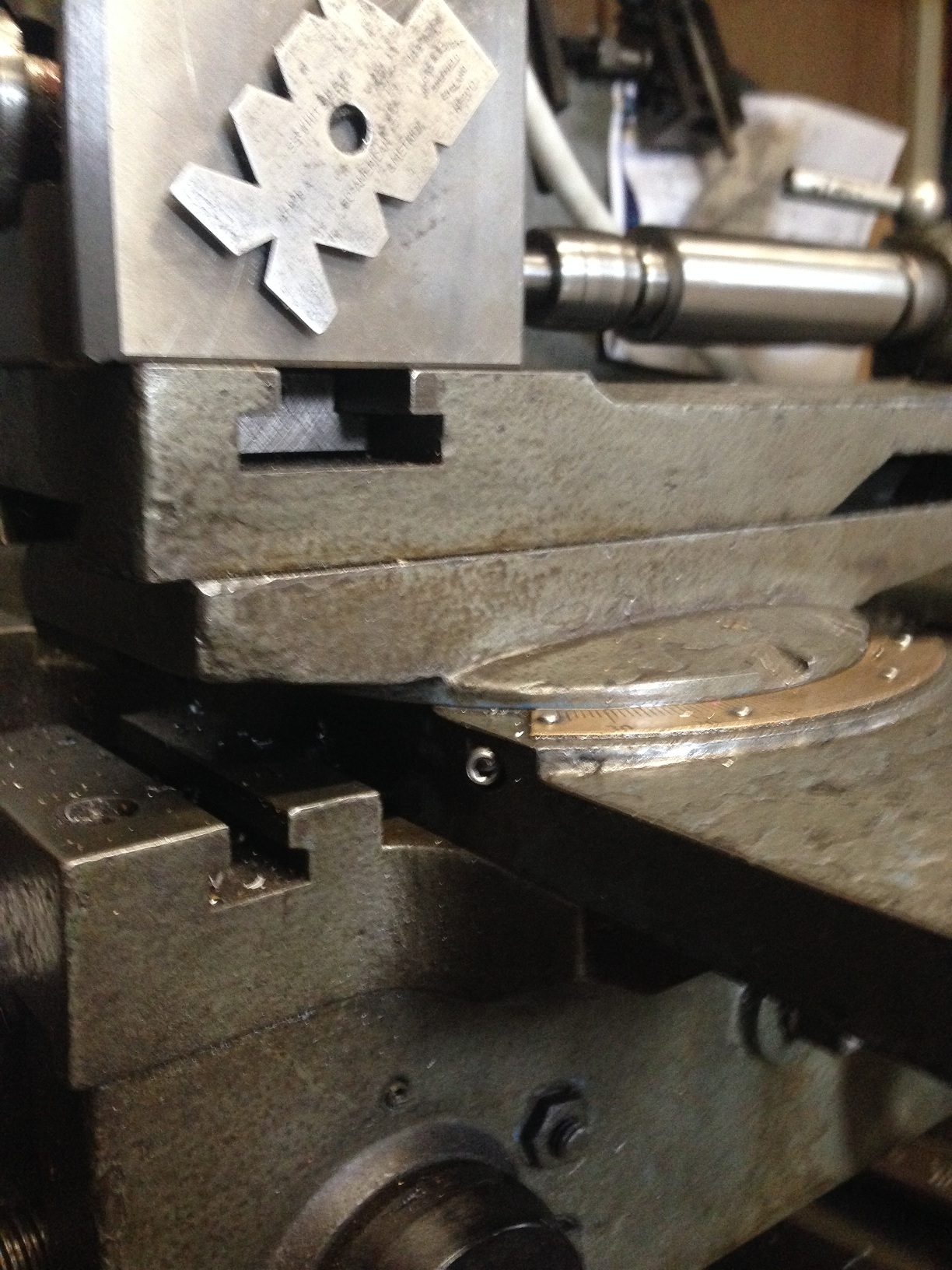

Looking at the picture with the fishtail gauge in it, it looks like your compound has taken a bit of a beating at some time and raised the edge right on the corner. I bet that the slide is only contacting on a couple of points, and the lock screw you fitted has given it some support. The proper cure for it would be to fix the slideway by scraping (or even stoning) the high spot out then checking with blue.

Sorry, I'm not sure what you have done here. From the photos it looks like you have drilled and tapped a couple of extra holes in the cross slide, in more accessible positions, to secure the topslide. If so, how does that stop the cross slide from tipping up at the back?

It would seem I have not explained the problem correctly and im getting my cross slide and top slide confused. I'm no engineer or machinist but a builder who like to make stuff
Pete you are right the cross slide has took a beating at some point before i got the lathe.
rpwilson "it looks like you have drilled and tapped a couple of extra holes in the cross slide" you are correct it was at first to get them "in more accessible positions"
But a side benefit is I can now part off.
Not the best drawing but hope you guys get the gist of what I mean. I had a look at a later model and the top slide has 3 locating screws so possibly the way mine was made was a design fault rectified on later models
