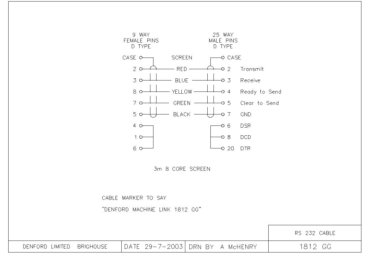

Also I cannot seem to connect the computer to the RS232. The computer displays 'sending' and the lathe displays 'ready' but nothing happens. On the forum there are 2 cables, one for IBM PC and the other 'Orac IBM' . Anyone know which is the correct cable, I constructed an 'Orac IBM cable,but with above results.

Over christmas ive read almost every mention of rs232 related questions on the forum. It was stated somewhere that the orac is connected Tx to Tx, and Rx to Rx. I have attatched two wiring diagrams, which one is correct.
I dont want to sound cheeky, but if you have a lead, would you kindly run a meter across the pins and pass on.
many thanks,
Rob.
I would stick with the IBM-Orac drawing, and work it out from there.
The problem seems to be that the Orac connector was designed to allow the use of a pin to pin cable, and the TX / RX lines would be crossed over inside the machine.
Normally a cable for PC-Machine would communicate over two 25 ways with pins 2 to 3 and 3 to 2 (crossover)
9 way RS232 confusing things further by having the 25 way function pin 2(TX) on pin 3, so a 25 to 9 crossover cable would be pin to pin (2-2 and 3-3) :?
see this link on what should be standard RS232 pinouts
https://www.anotherurl.com/library/rs232.htm
As a starting point you know that Orac pin 2 is TX - all you need to know then, is what pin to connect to RX on the other device
Its impossible to say what the ME101 pin assignment is, unless you have the book or its on the Internet somewhere
