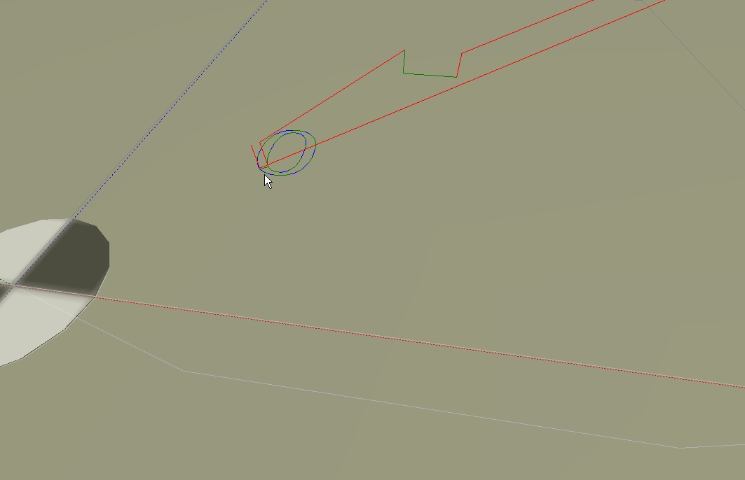

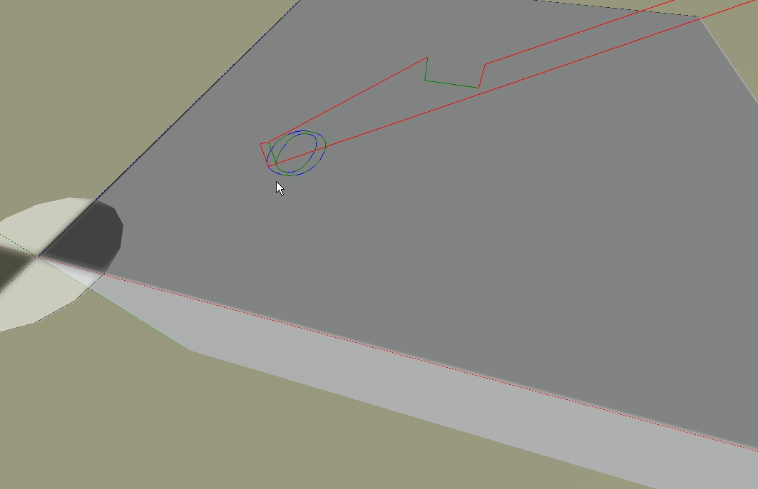

I have done a simple design of a letter O and a short line using a o.5mm engraving cutter and a 3.2mm ball cutter.
The engraving cutter retracts as the gap from the inner to the outer lines of the letter o are more than 0.5mm (screen1) apart but the two lines are linked when using the 3.2mm cutter (Screen 2).
To cure this change to tool width to match the line width you are trying to cut.
